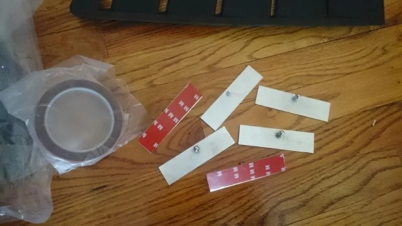

That is just regular 3M DS tape. VHB will say VHB. It will hold like rivets. regular...not so much. Especially once it starts absorbing moisture and heat from the hot sun.

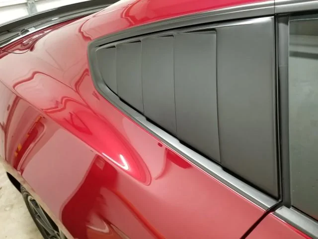

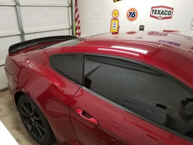

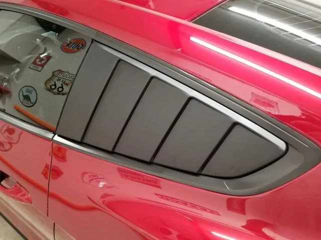

They arrived 2 days early but my schedule didn't allow me to install until today.
upload photograph
upload photograph
upload photograph
I used 1/8 inch VHB tape but the lower corner on the driver side is pulling up a tad. I ordered some 1/4 inch tape to give it more strength.
Overall I love them, but the wife isn't too fond of them.
There is a very small dent on the driver side , but you really have to look to find it. Other than that no defects.

Depending on where you are (just noticed the Florida), I've got a new cheap heat gun (Bought it for another project - spoiler) to try and shape it, like someone else recommended, if you want :cheers:
Now the real test is to see how long your wife lets you keep em on!

It's not an issue of it being warped, I don't think the 1/8 tape is wide/strong enough. I could always try the supplied tape.

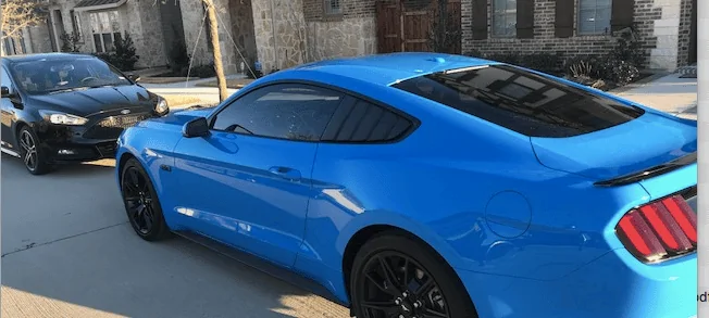

Well, I put them on unpainted and with the supplied 3M tape. The quality was nice. They shipped from CA, and came well packaged/protected just as other's noted.
Mine were free from any defects that I could see and they seemed mostly straight. I did use a heat gun on low heat to straighten the from corner of the drivers side just ever so slightly. She's sitting out in the sun now to let the heat "stick" them on.
I'm not completely convinced I'll keep them on; I'm not convinced they'll stay on. I'll give them a few days and see how I like them. I created an ever so slight blindspot when looking over the right shoulder, but it's not horrible.

You're right on the blindspot, it isn't hugely noticeable after a while but I'm sure if/when they come off it'll be a bigger difference than I realized!

I took them off. I think they need to be painted and color matched to the hood vents & spoiler. Additionally, definitely use different tape then the included 3M. It will not hold up over time.

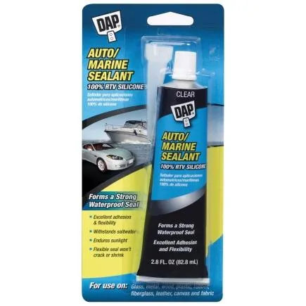

Don’t rely on just the tape. Time, temperature, wind and water will take their toll.
Use this:

^I agree with this. I almost always apply a bead of silicone on everything if it matches. Black against black, if you apply it correctly and smooth it out is invisible.
