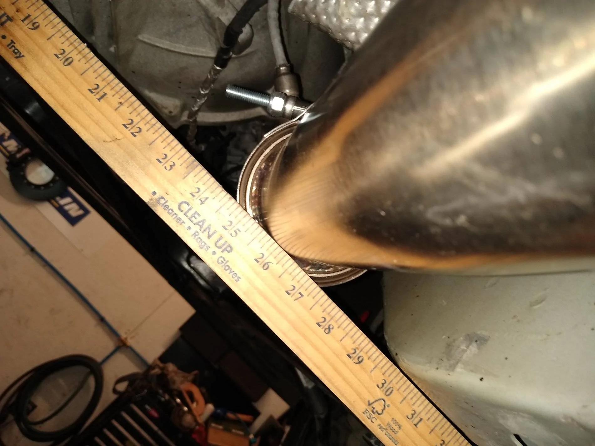

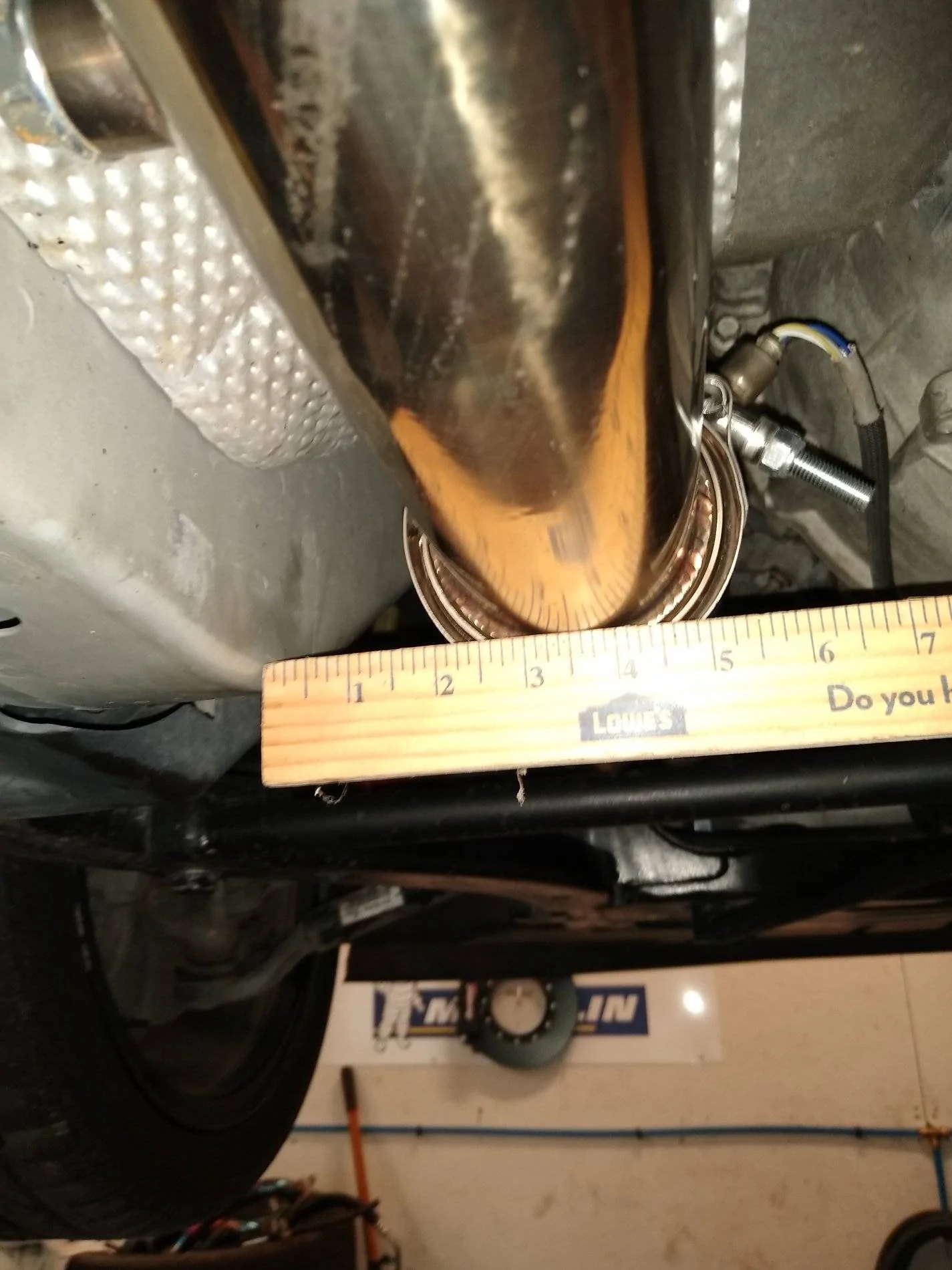

any chance you could measure the width of the collectors? Curious how wide they sit.
Sure thing. The rail to rail is 29 1/2. From collecter to collector measured on the outside is 26 1/2. My personal width is 1 1/2 for the guys asking.
