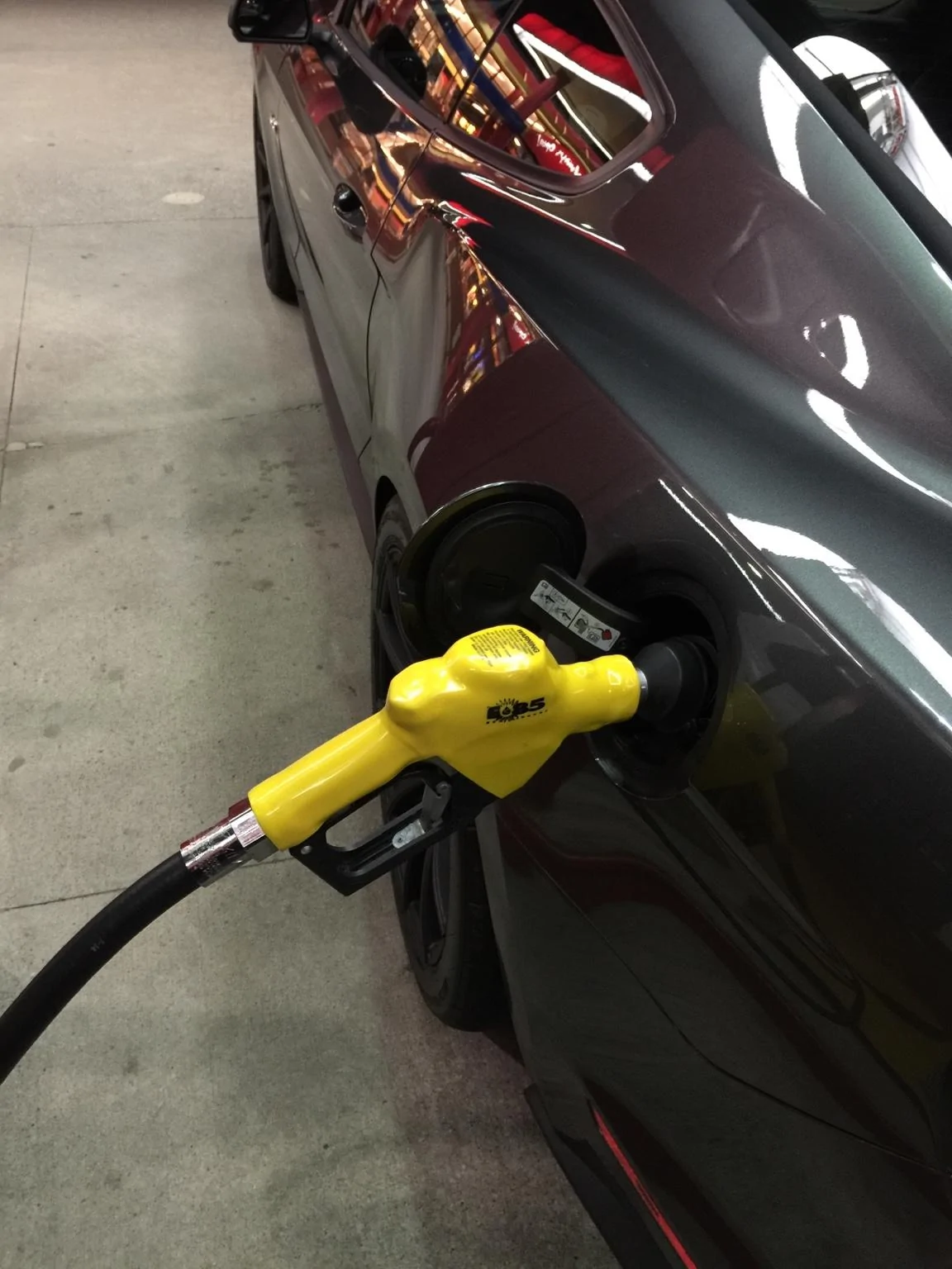

2016 Porsche 911 Turbo S & 2016 Shelby GT350R
Yellow handle life.
Kryckter
Kryckter
Nov 18, 2014
282
112
2015 GT
Where are you in TX that you get 105 at the pump?!
I wish. That 105 rating is for the E85 and is just the stupid gas station promoting it I guess...
I think the DFW area has some race gas pumps...
I'm driving down to Katy in a couple of weeks, then spending a week in DFW. Maybe I should bring the truck instead of the Mustang and bring back a shit-ton of E85. :p
Got it here, but rumored to be winter blend year around.
