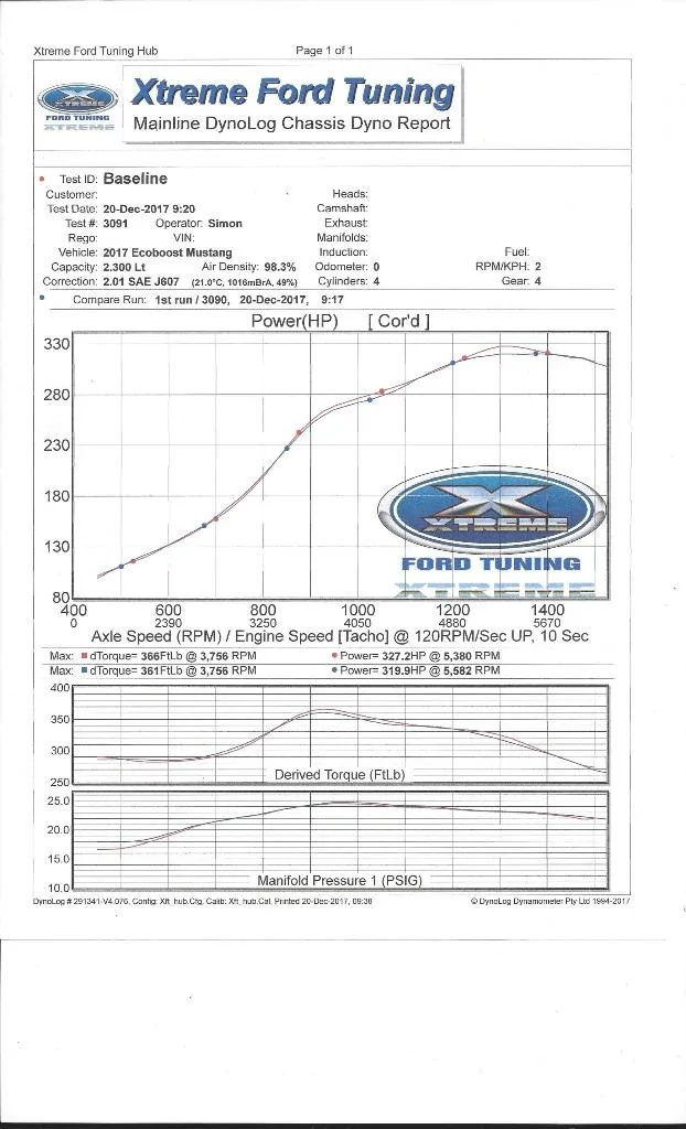

Yeah pretty well but dyno results vary. Same dyno and same day, same temp etc and it would be a better comparo. I was lucky to get on to a proper hub dyno today. Good experienced tuner there too. Anyways, the results are attached. Did two runs. Best was first run. Note they were also done in 4th gear and mine is an auto. Ambient temp 21 deg C.
327 hp @wheels = 244kW for the metric guys @wheels
366 ft-lb @wheels = 496nM @ wheels
Dyno operator was very surprised as they have only done GT mustangs so far. Shout out to Ryan At PD tuning:thumbsup: Stoked. Hope my rod bolts hold up:) Also Dyno power run was $200 AUD.

Grats mate, mine will hopefully be around this as well. I dont have a downpipe but rest is same same. Though my 98 Octane goes to 25PSI while 95 octane 23.5-4 odd so not sure what that will mean.
I wont have $200 spare anytime soon for this but confident I shouldnt be too far away. 300HP+ at the wheels is damn nice

Cheers man. :cheers:Have to hook up for a cruise and I'll let you take it for a spin.
The downpipe turned a nice sounding magnaflow street into a really loud, shitty sounding exhaust. I had to put a Vibrant Ultraquiet in there. I actually still want to get a 3" Vibrant resi and put it in a section of the downpipe to quiet it down further. So don't bother with a downpipe if you don't want it obnoxiously louder.
Sounds like your tuner is just running a safer boost curve on the 95 octane - no issue there.
