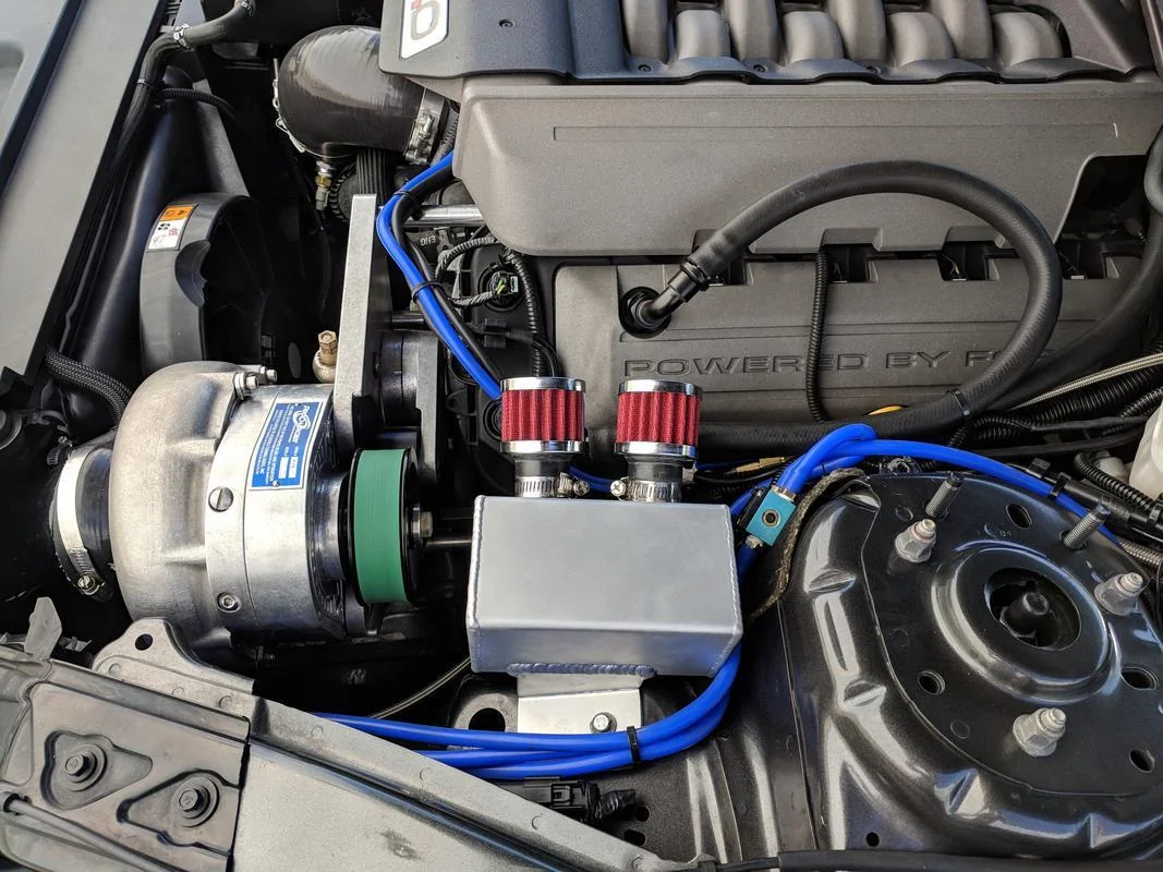

Can someone post a picture of the traction control abs plug by the air box that you need to disconnect before you dyno. Thanks

Bottom, middle of the picture. Small black plug. One side is taped up usually. Can't miss it.

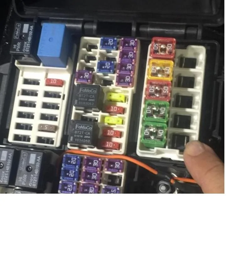

Or you can just pull this fuse and turn off all the nanny's...
The plug achieves the same thing but with the added bonus of not fumbling the fuse into the bowels of the engine bay...don’t ask me how I might know this :crazy:

thanks to everyone, just wanted to make sure I had the right plug
