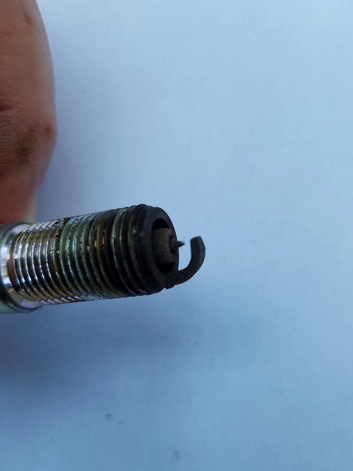

Not sure if you are still running MSD coils like it says in your sig but if you are get rid of those and go back to OEM ones.
I didn’t even notice that. I agree.
Apparently Lund could see it in his logs if they wanted him to check plugs, and he can feel it. Just smell that plug. It’ll smell like fuel or oil.

He said he put the # 2 coil on # 5 cylinder and the miss followed which would lead me to believe there is a problem with that coil. In my experience with COP factory coils work the best as they are designed for longer life span and high mileage, MSD parts are shit.
