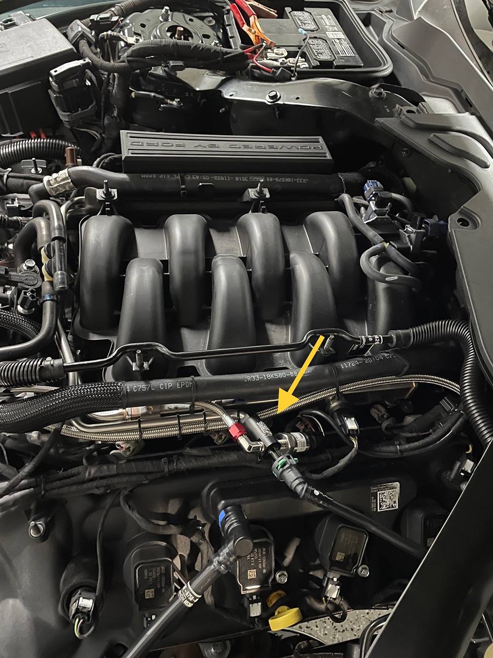

NGOT8R
Jul 19, 2020
154
9,297
7,799
Adrian
2019 Bullitt
That fuel pressure sensor is sending the signal to my Progressive Controller which would work the same with any electric fuel pressure gauge.
