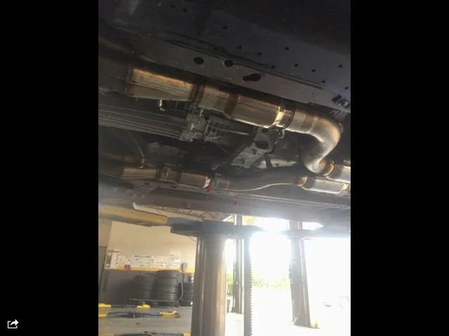

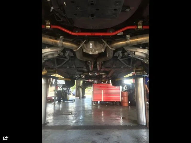

I went with race cats, but also added a pair of 3" Vibrant resonators. Sound is amazing, and the volume falls slightly louder than a cat-back unless I'm WOT. Then, she screams like a banshee.
They completely killed rasp/tinny sound levels, most of the drone from the mag comp AB, and with all 3" connections, it flows very well.
