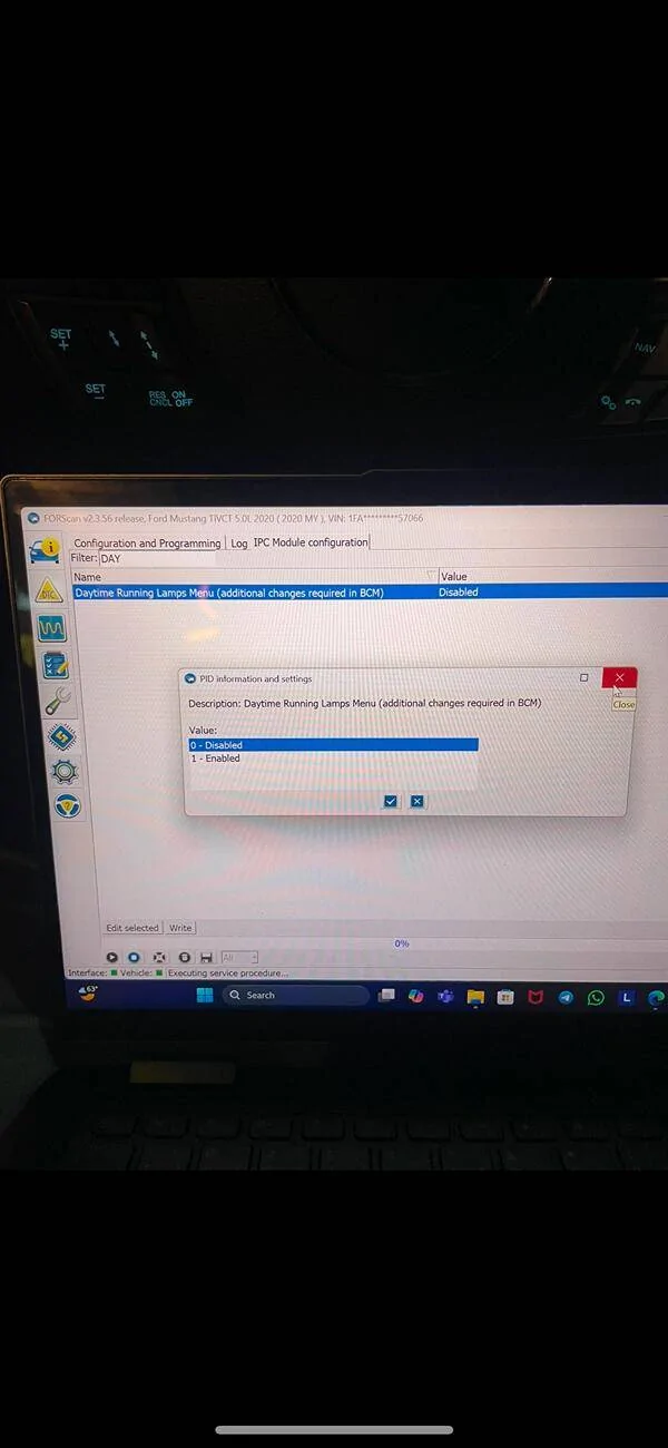

I have successfully adding the DRL for my 2020 Canadian mustang equipped with Instrument cluster.
You have to make changes in IPC and BCM(BdyCM for me).
in IPC make
- Daytime Running Lamps Menu (additional changes required in BCM) to be enabled

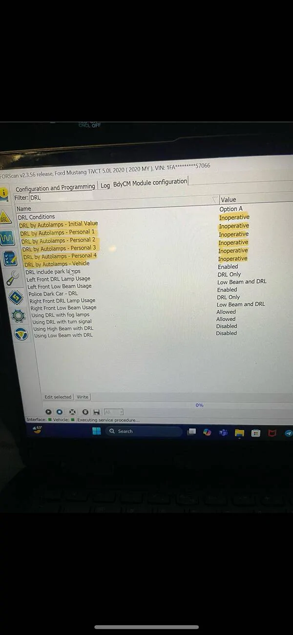

In BCM(BdyCM)
make the highlighted items from inoperative to Enabled.
It will work as it should(US mustang)

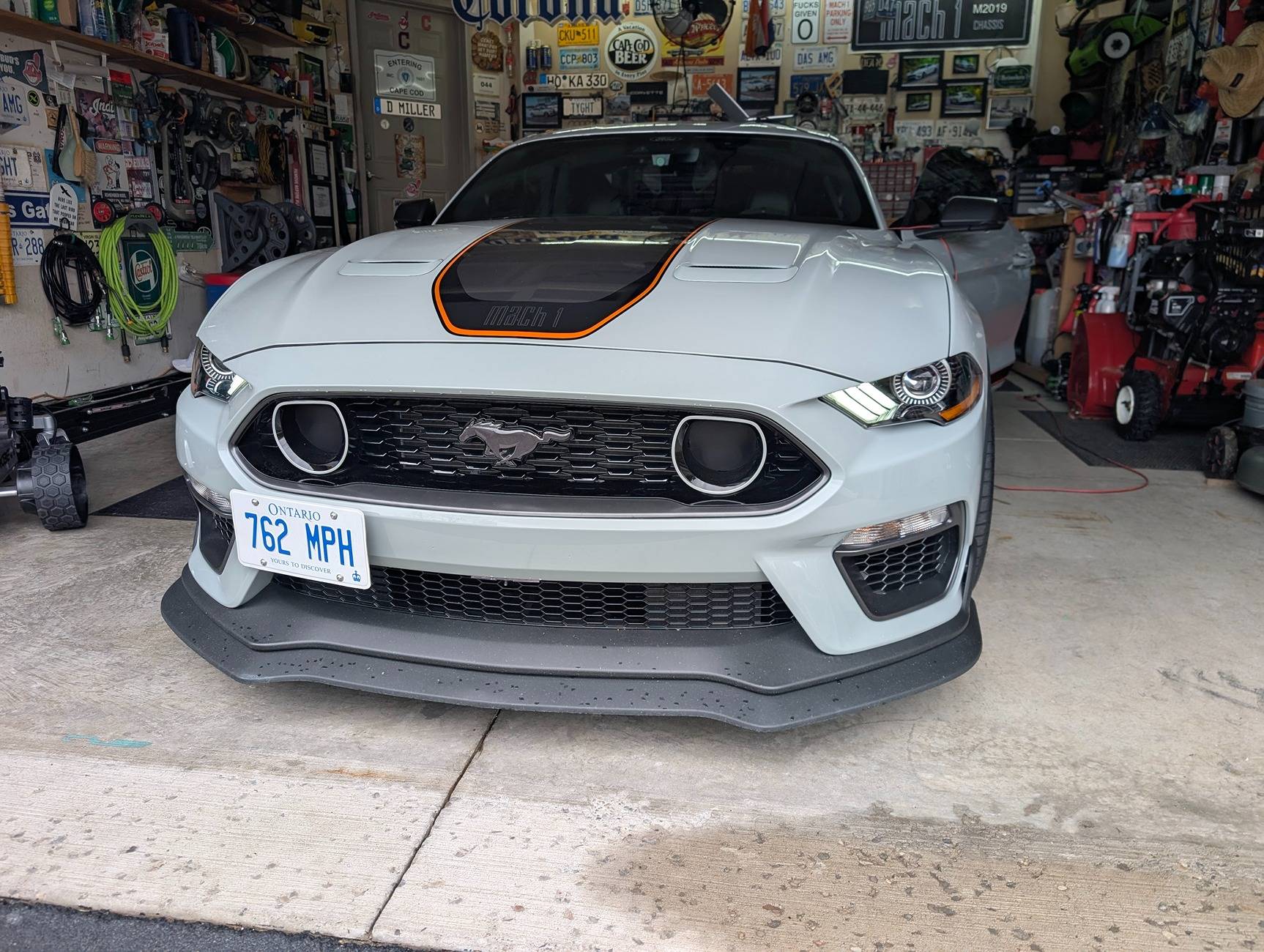

So you now can drive around with just the fins on ? And headlights off.. ? Control now is in the cluster ? Stupid drl ruined my pis from tail of the dragon, just looking to drive with the fins on
MH702
MH702
Jul 28, 2024
58
Mohammed
Mustang
Yes

Hi
you need to use forscan and change the settings mentioned in 1 thread.
those change should be in IPC and In BCM(BdyCM)
If you don’t know how to use forscan please check in youtube there is a ton of videos.
If any thing is missing please let me know
