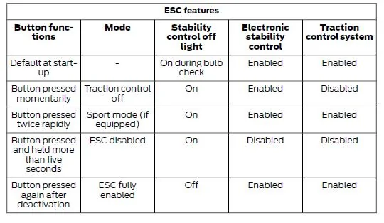

Pages 174-177 in Mustang owner's manual. For reference:
So first level off is Traction control off, second level off after holding for more than 5 seconds is Stability control off. Track mode automatically disables traction control but stability control is on (more lenient presumably)

Since there is a toggle switch vs a push button switch, I assume you just hold the toggle for x time?
Charlemagne
Jan 14, 2021
1,971
3,477
Czech Republic (Europe)
Nick
Yes. If you hold the toggle shortly (release it immediately), traction control will be disabled and if you hold it for more than 5 seconds and then release it, stability control will be disabled. You get confirmation on the display.
