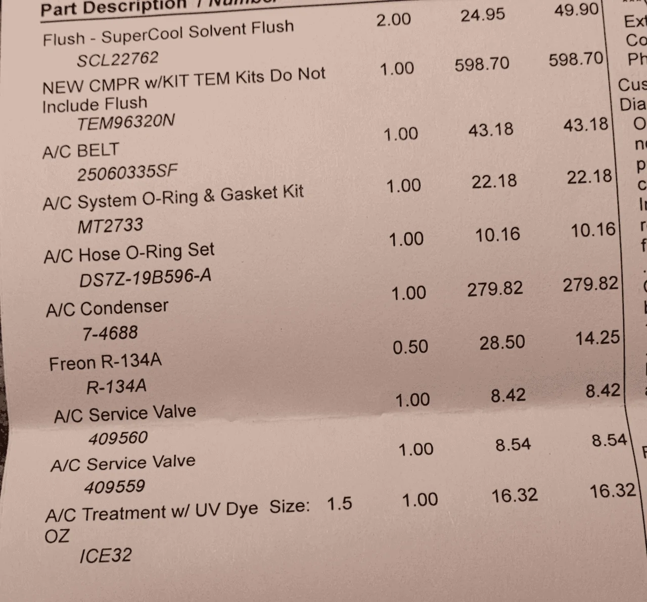

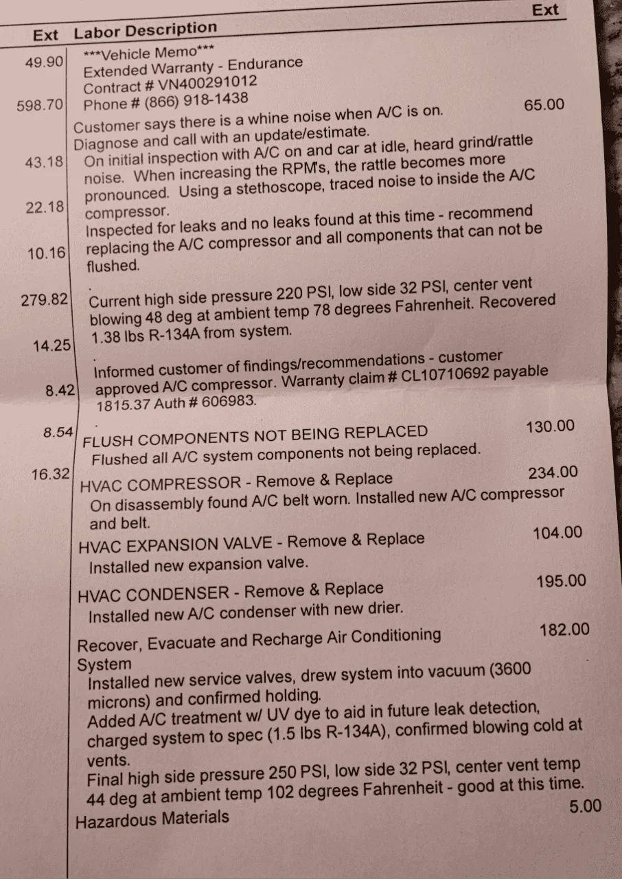

Ppppfffttttt...those f%$*ing prices are the reason to do it yourself. I do understand charging the system can be intimidating if you don't to a lot of your own work, but changing AC components and charging the system is absolutely a D-I-Y job. But yes, everyone has their limits. Getting to and swapping the compressor on this car is straight forward and easy enough to get to. Just takes the same attention to detail you'd afford any other job.

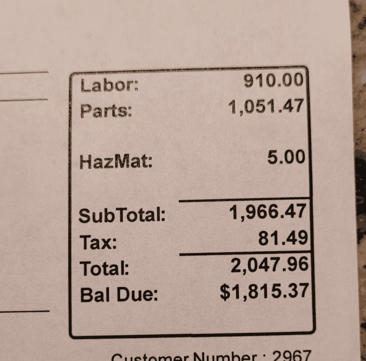

$1k in parts. $900 in labor. The entire system needs to be re-done. You can't just do part of it.
If you look halfway up, my warranty covered it.

Agreed. Compressor, condenser, expansion valve from RockAuto for ~$400. Flush the rest of the system. $0 labor. The pleasure of doing it myself and knowing it’s done right…$priceless$
