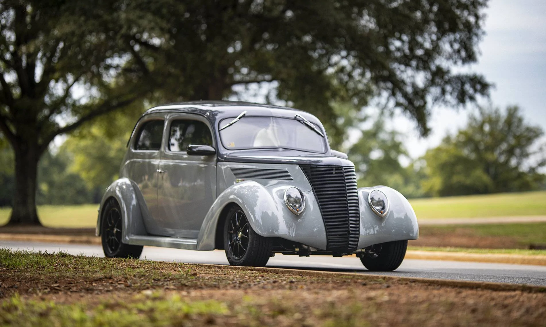

Greetings everyone, Newbie here to your forum. I do not own a Mustang, however I do own a 6R80 transmission out of a 2016 Mustang Ecoboost car. I have a 1937 Ford. A complete Fatman Chassis with coilover suspension, adjustable shocks, Disc brakes etc. The engine is a 2.0Ecoboost from Ford Performance that has the turned up factory tuned computer that is not available anymore. I see 23-24lbs of boost and it is rated at 350ftlbs of torque. The 6R80 is controlled by a Quick6 controler, works great. The first gearbox had about 15000 miles on it when I got it. On first driving of the car there was a "minor" vibration at about 65mph and would lessen as speed got higher! Changed the final gear in the 9inch rear end .25 points higher and kicked the vibration up to about 73-78 mph, so the issue was definitely from the tranny back, eh?

First, welcome to the forum and that’s one really sweet looking 37!!
