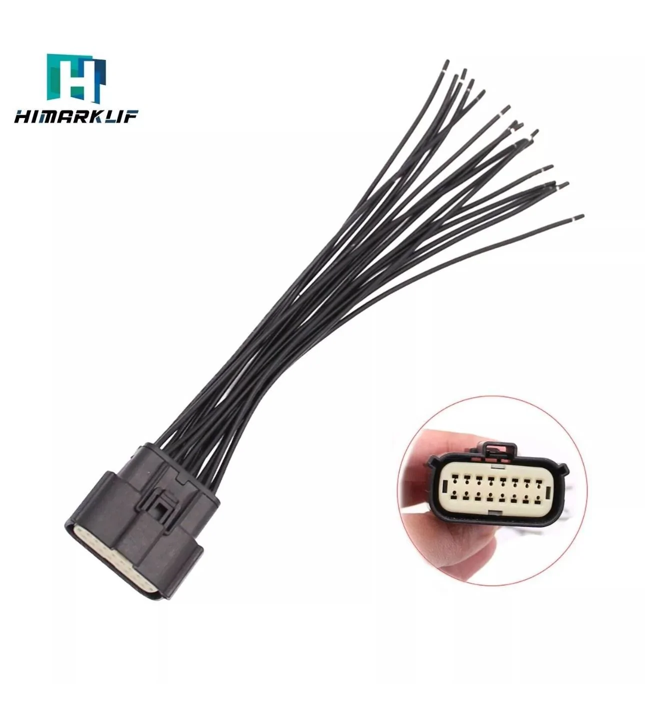

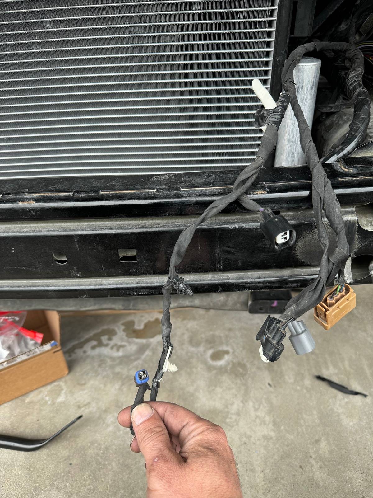

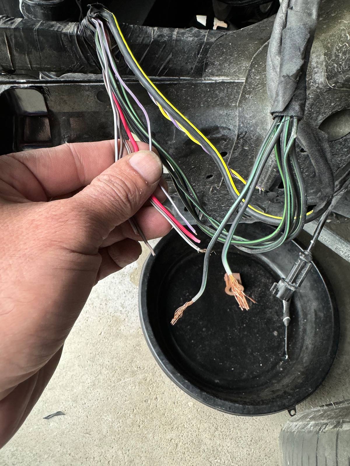

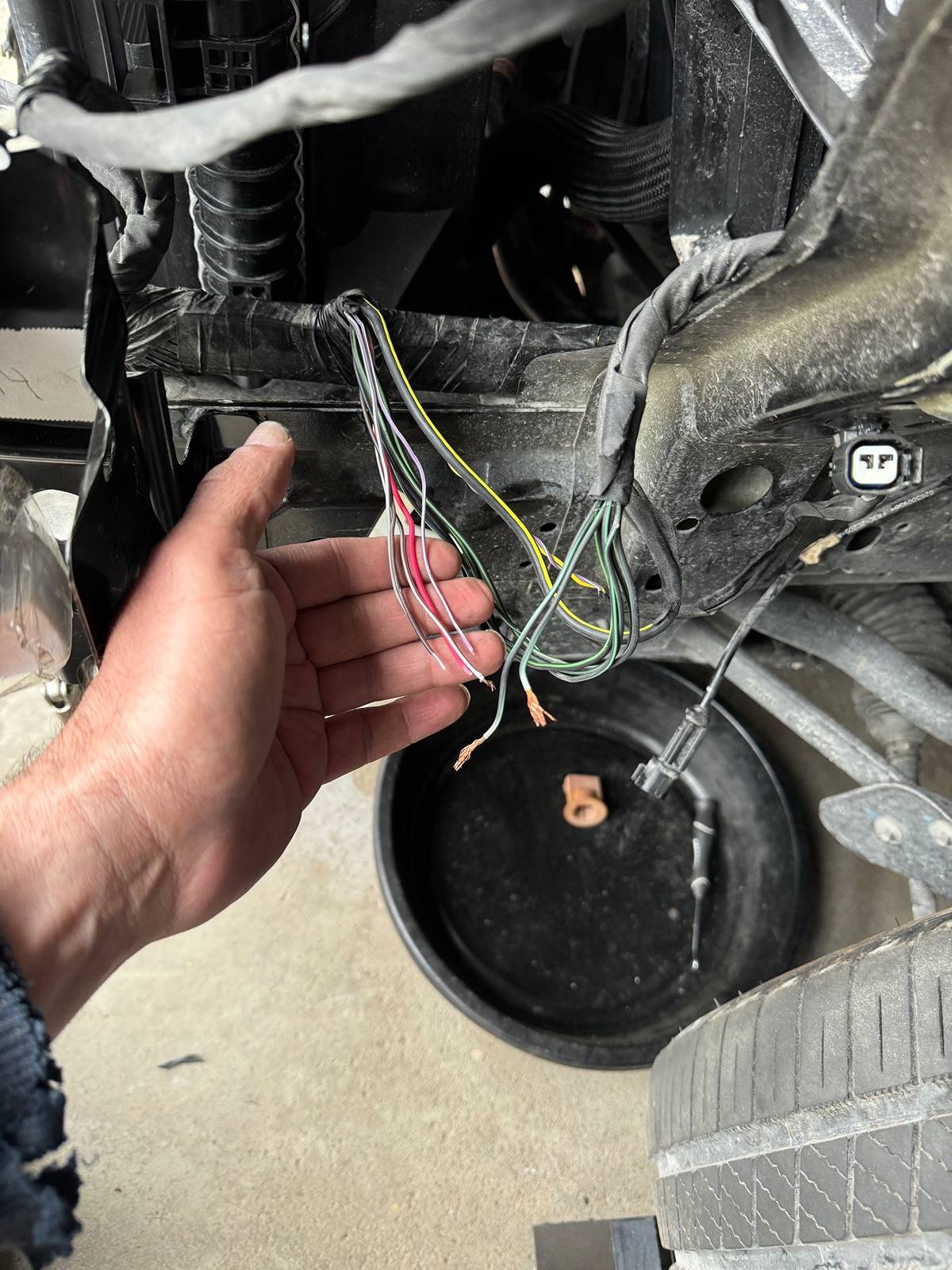

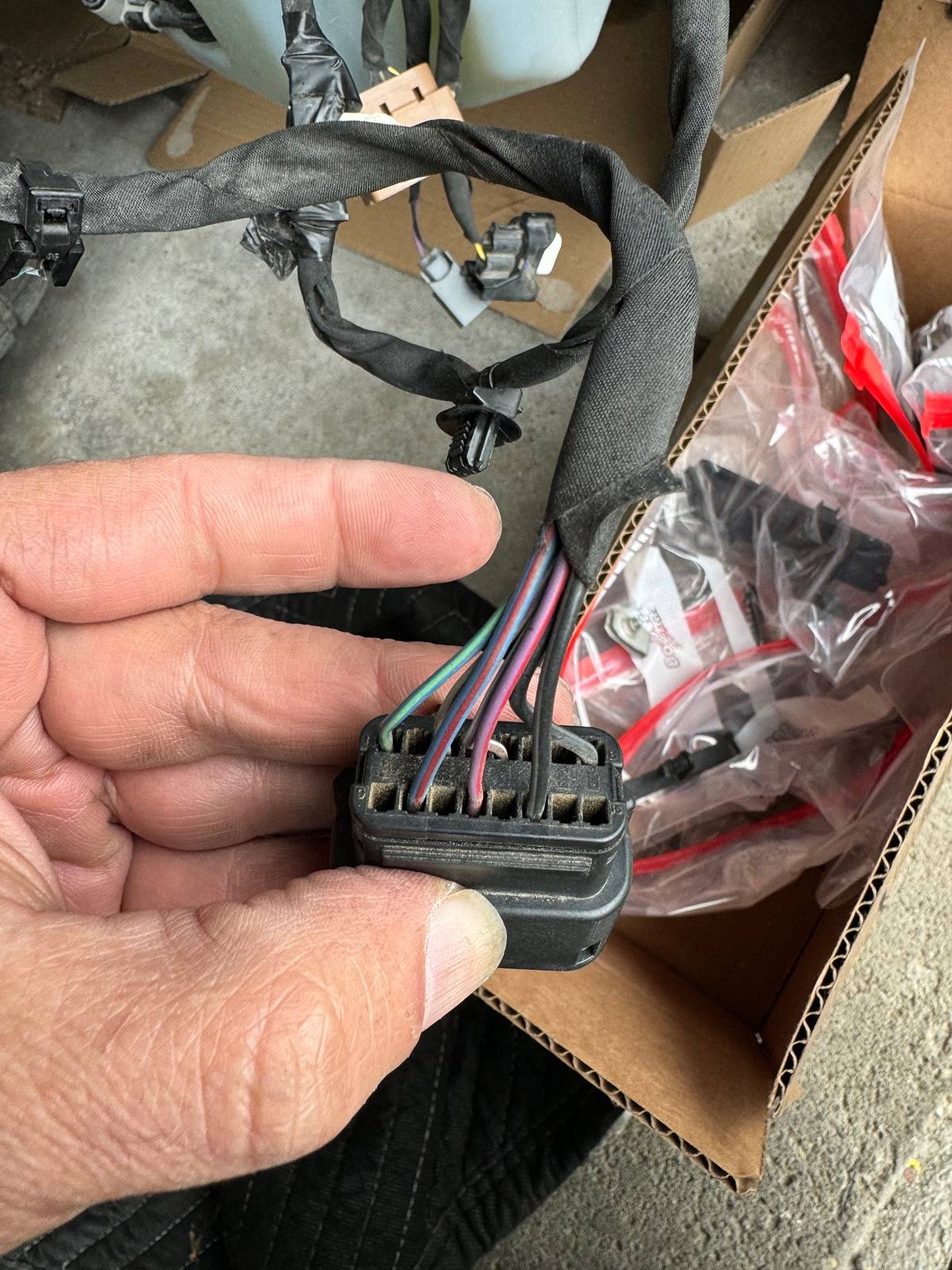

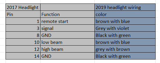

The 2 black/green is for the headlight connector? And that connecter from ebay work?
I checked the passenger side wires color and count should be same!
and side question: is that the impact conecter on driver side?

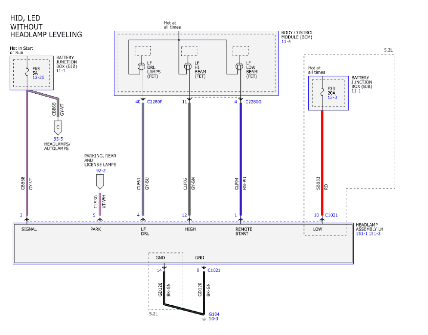

I'm attaching one diagram and some other threads that might be of help.
In that diagram, I'm showing two, BK-GN (Black/Green) connections, which are acting as grounds.
Hopefully, :please: the attached is of help to you.
https://www.mustang6g.com/forums/threads/head-light-diagram.154901/
https://www.mustang6g.com/forums/threads/wiring-assistance-needed.195689/#post-3922076
