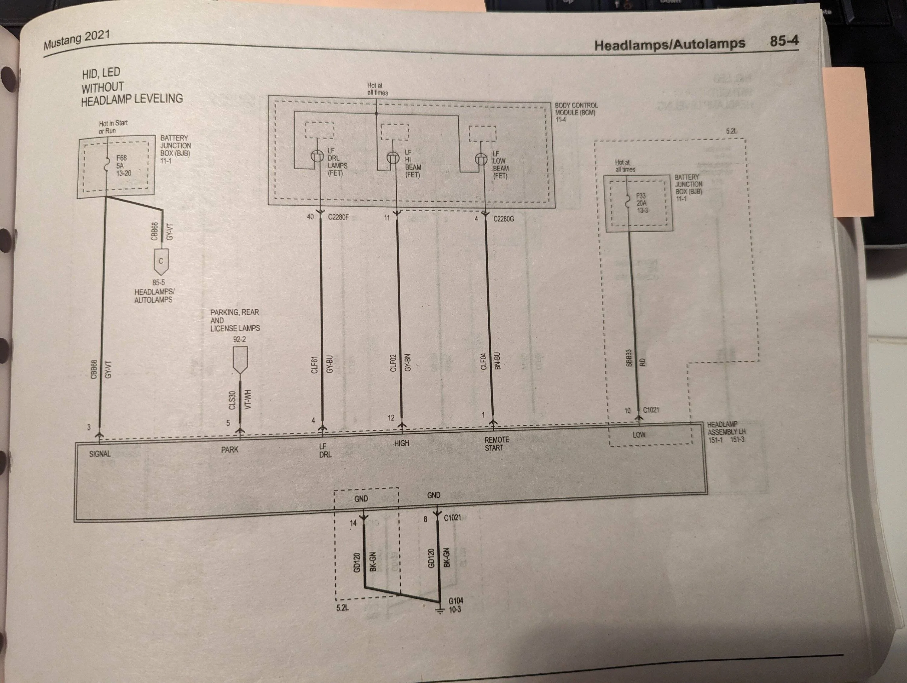

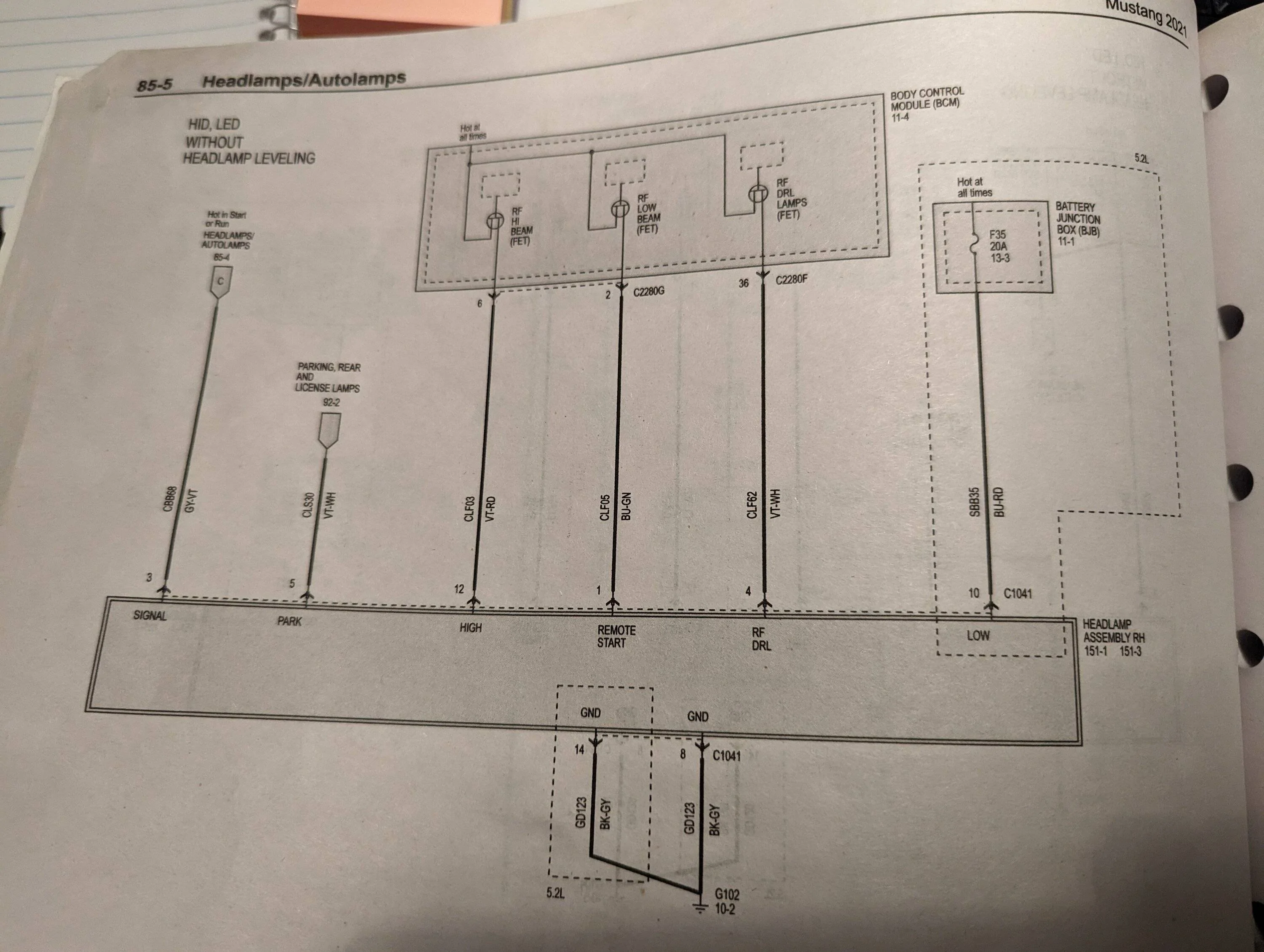

First, here's how I got my wiring diagram. Great price cuz if ya need it, ya need it. Same price I found for my 2021.
https://www.ebay.com/itm/354838788980
I can give ya 2021 info, but surely Ford changed it between 2015 and 2021.

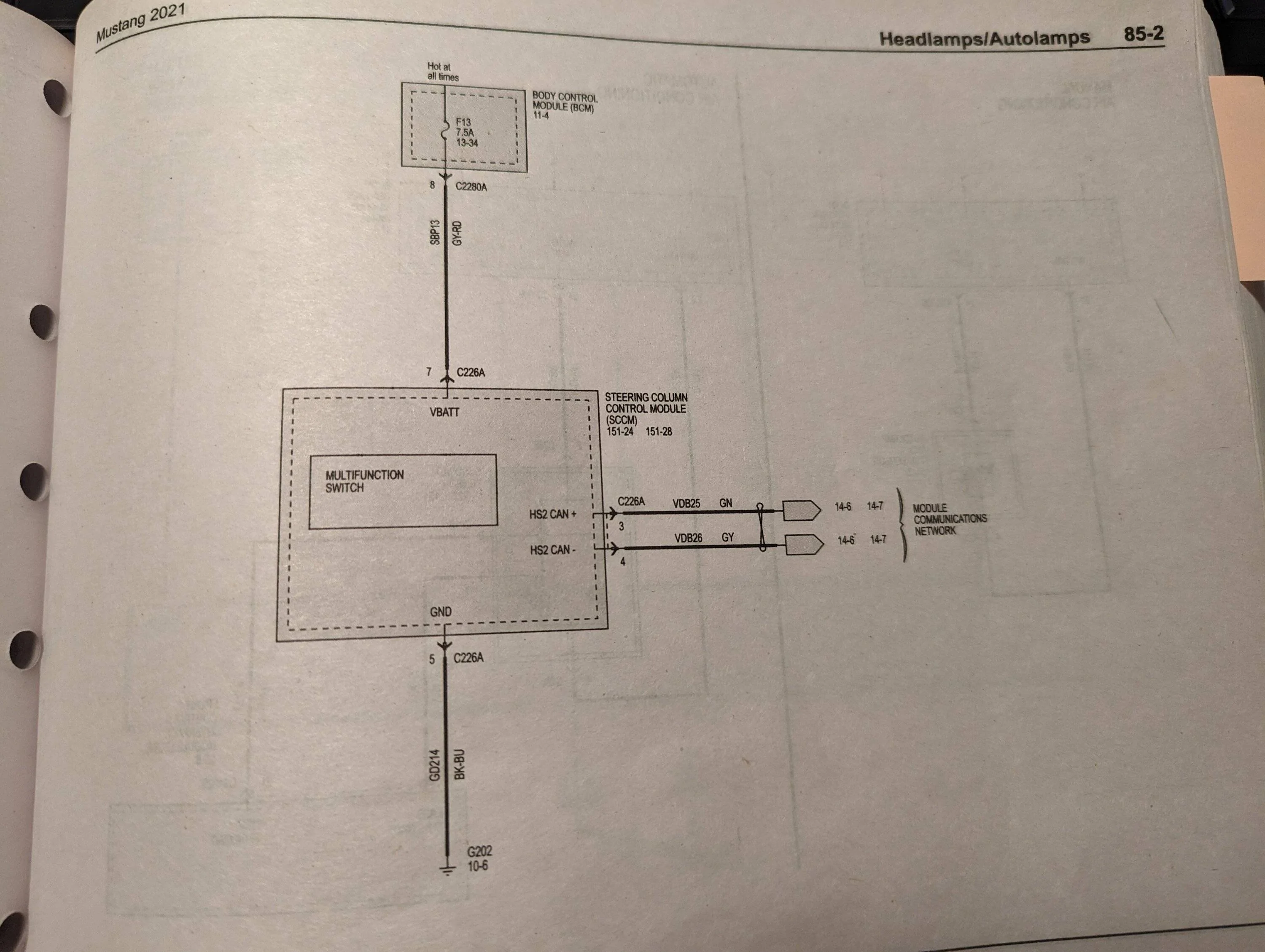

Anyways, interior high beam stuff is all computer talk and high speed canbus. Less than 12v, too, so it wont drive a relay.
I'd go the to the headlights or wheelwells and pickup the high beam there. In my 21 schematics manual, its Grey / Brown for the left, Violet / Red for the right. I was able to get to the disconnect in the front wheelwells by removing the front part of the liner.
Confirm these for a 15 before tearing into your car.
Crikey, I forgot about the canbus rubbish🙃 but WOW thanks for the wealth of knowledge! 😃
I'll check it at the lights then, the aux lights I'm mounting will be in the grill space anyway.
I'll be sure to pick up the book too especially since there will certainly be more electronic modding adventures to be had with this car lol

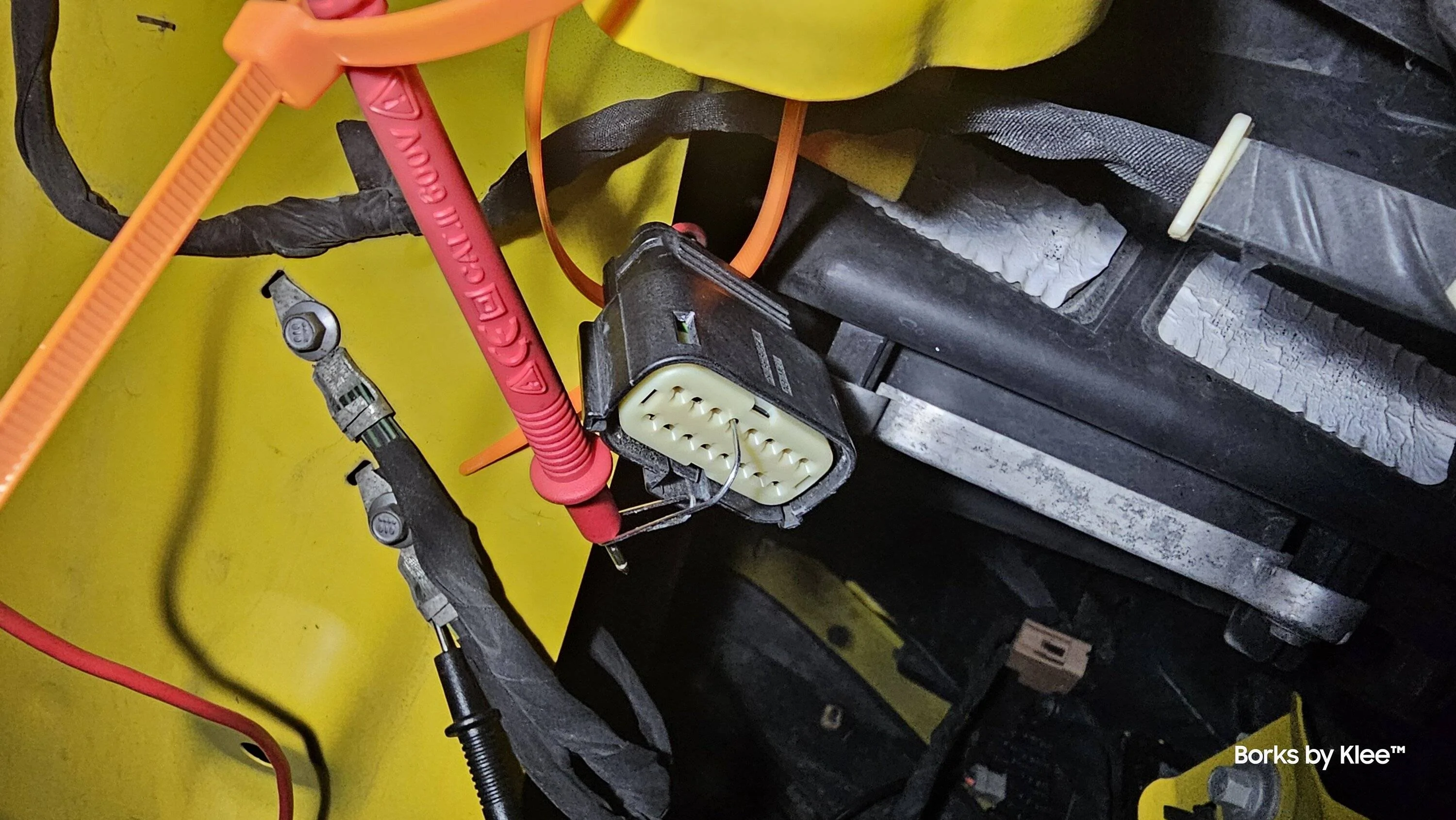

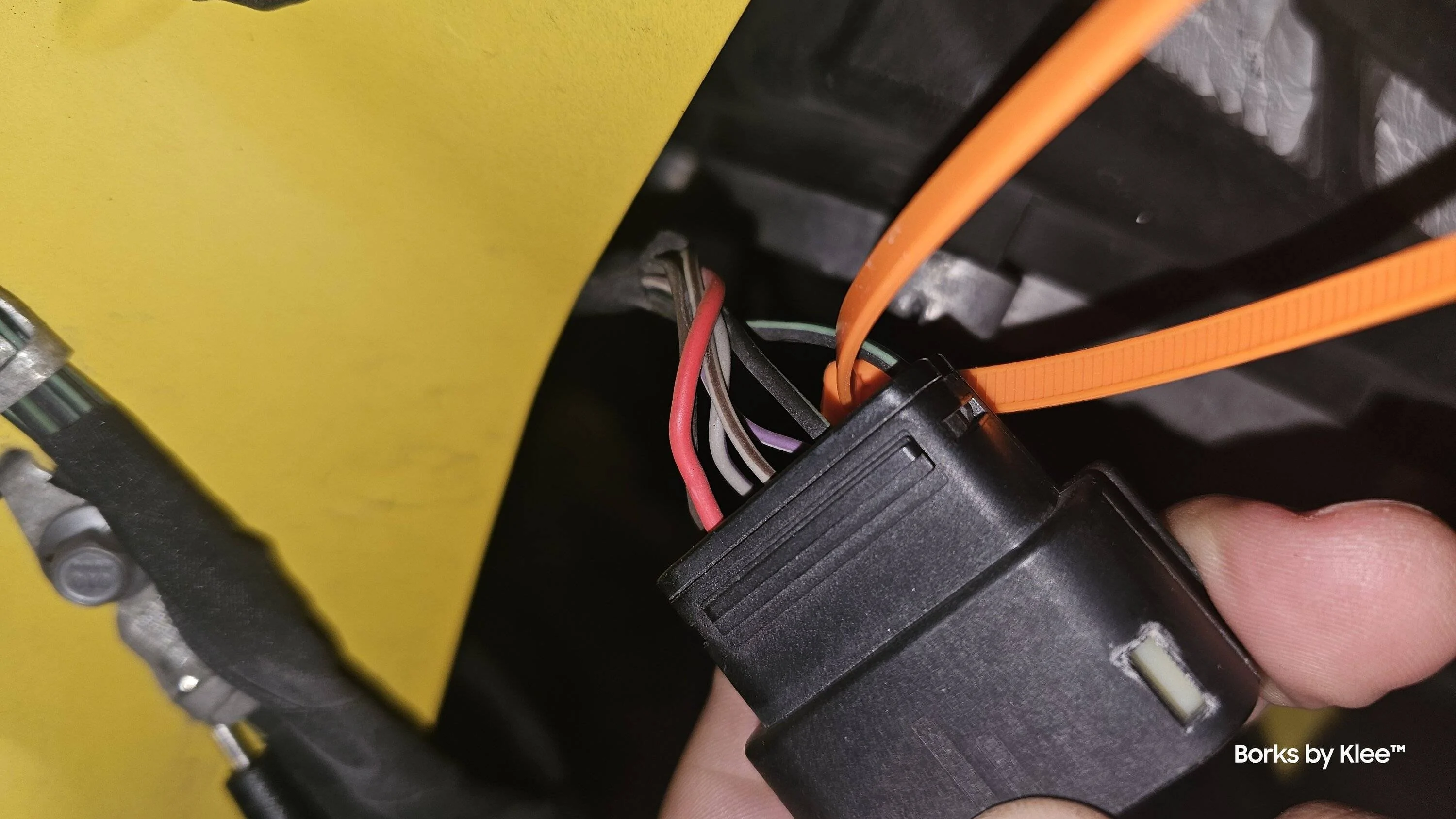

Located it!
The signal is the same colour as your '21
Pretty tight space in there too. Might you know if that wire traces to the engine fuse panel or does it come direct from the computer?
If I have to splice at the headlamp's plug, so be it, I just like to have neatly run looms and an 'undo' option should I want to remove this system... Damn this OCD of mine 🥲

Located it!
Cool, glad it helped ya.
Those high beam wires only come off the BCM.
Hate to say this, but to run a small harness the way you want, it may be best to remove the bumper cover and then you can work at the front of the car in leisure. It really isnt that tough to remove... a bunch of screws, 4 bolts and there ya go. I had the front end of my Mach off in about 20 minutes the first time.
Thats what I would do. Then you could unwrap as required to get into the harness, make your additions, wrap everything back up nice n secure and Ta-da. That'll keep that OCD happy. I know... me too.
You're only adding the coil side of your new relay to the headlight high beam wire, right? I wouldnt add much more load than that.

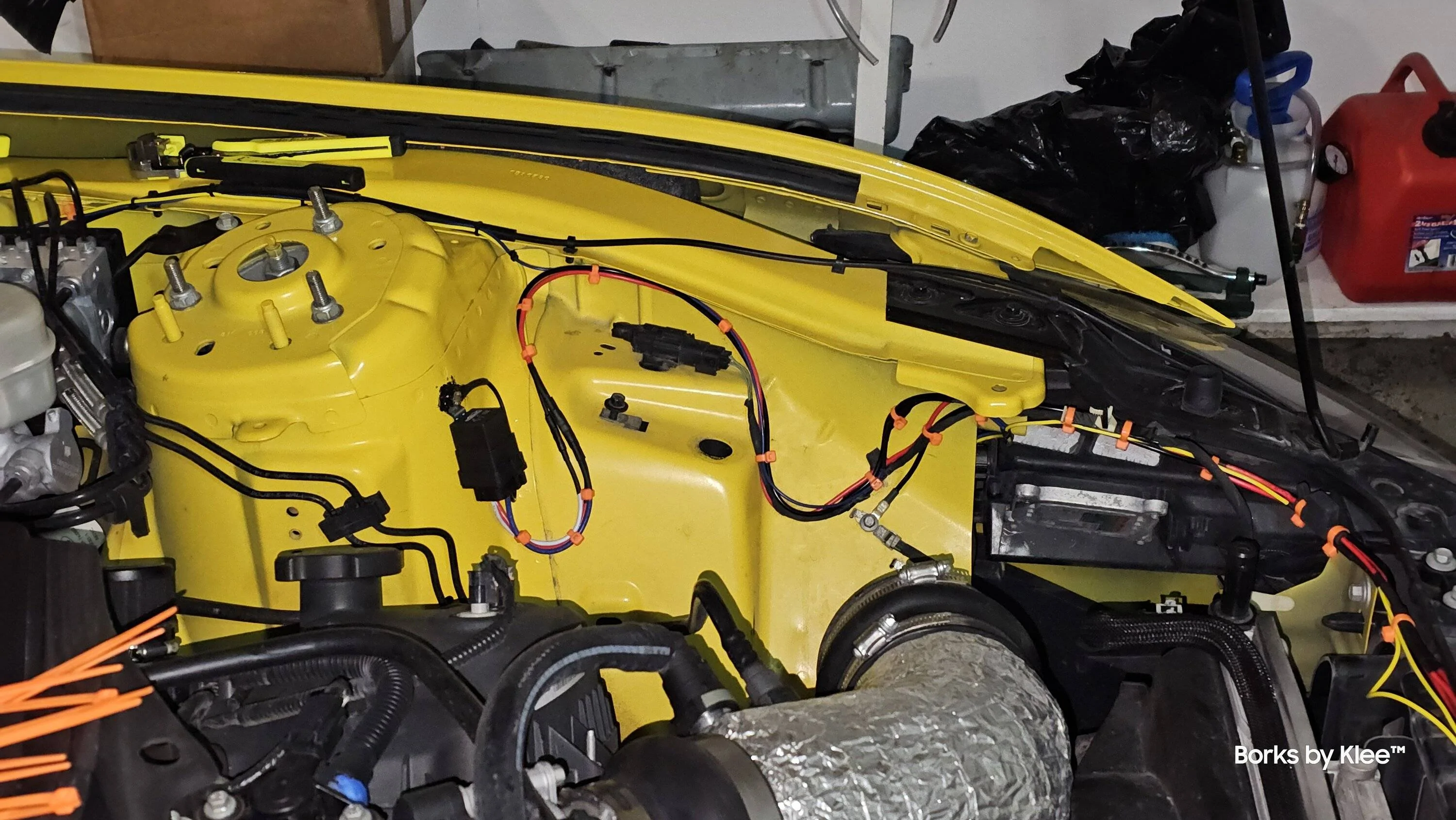

I've actually been trying to avoid removing the front fascia due to an uncomfortably close encounter with a kamikaze deer 🤣 the tabs are knackered so I put it back as best I could until I can get my new one.
You're only adding the coil side of your new relay to the headlight high beam wire, right? I wouldn't add much more load than that.

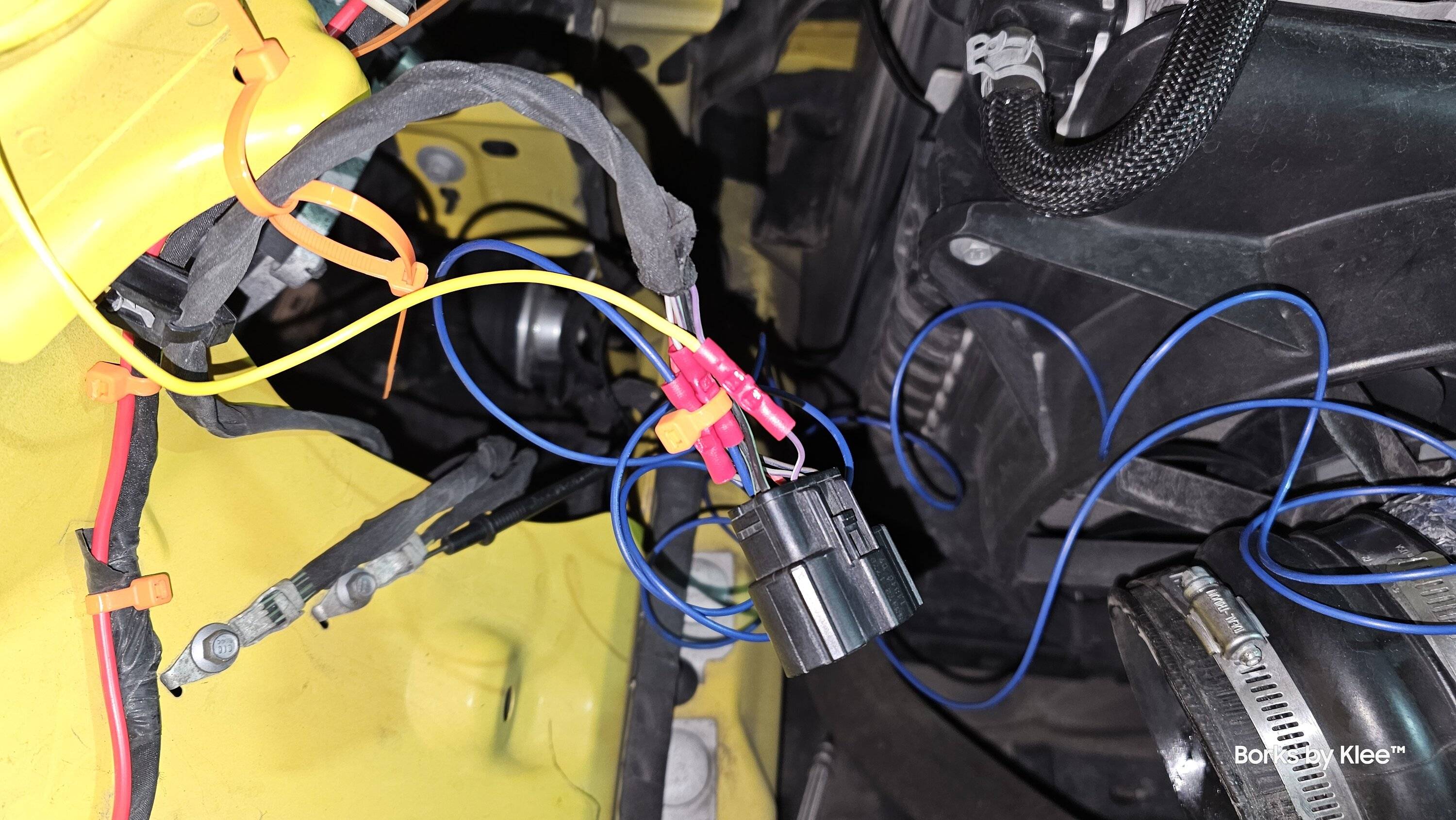

Correct. It's technically a SPDT toggle (on-off-on) into a SPST relay. I just needed a signal to trigger the relay when my highs are on (a pseudo 'auto' mode) and the other pole is a manual trigger if I need only the aux lights on (I pulled a constant from the main input to the interior fuse panel).
Pictures will be shared once it's done and working as designed.

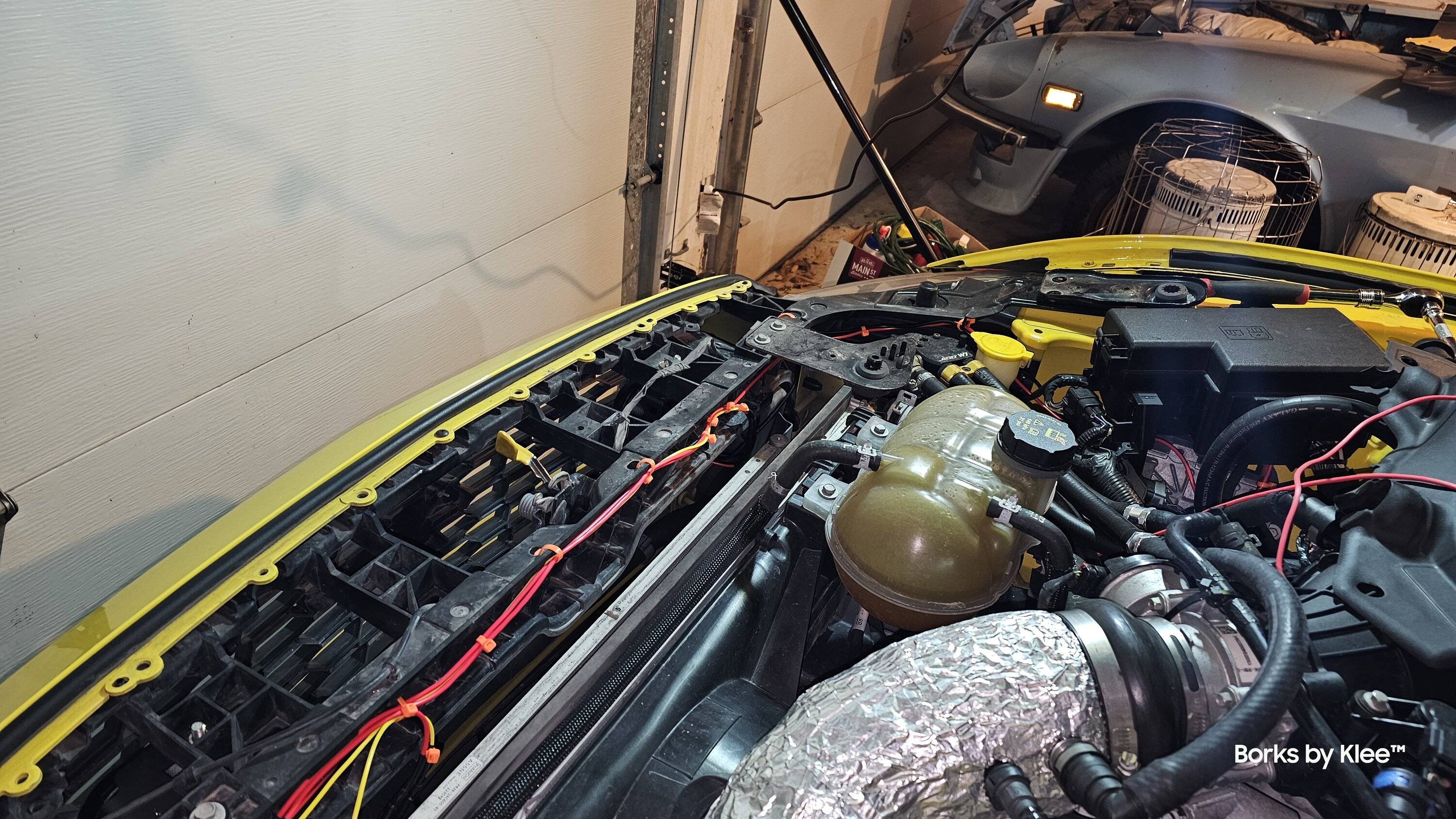

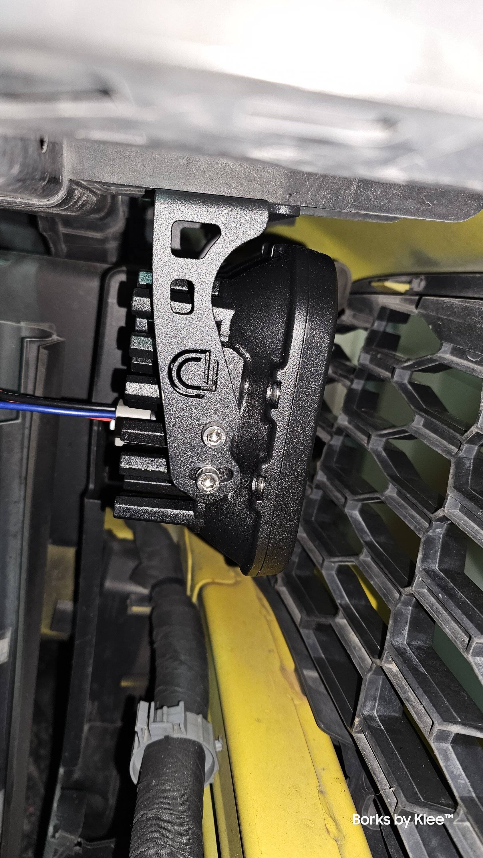

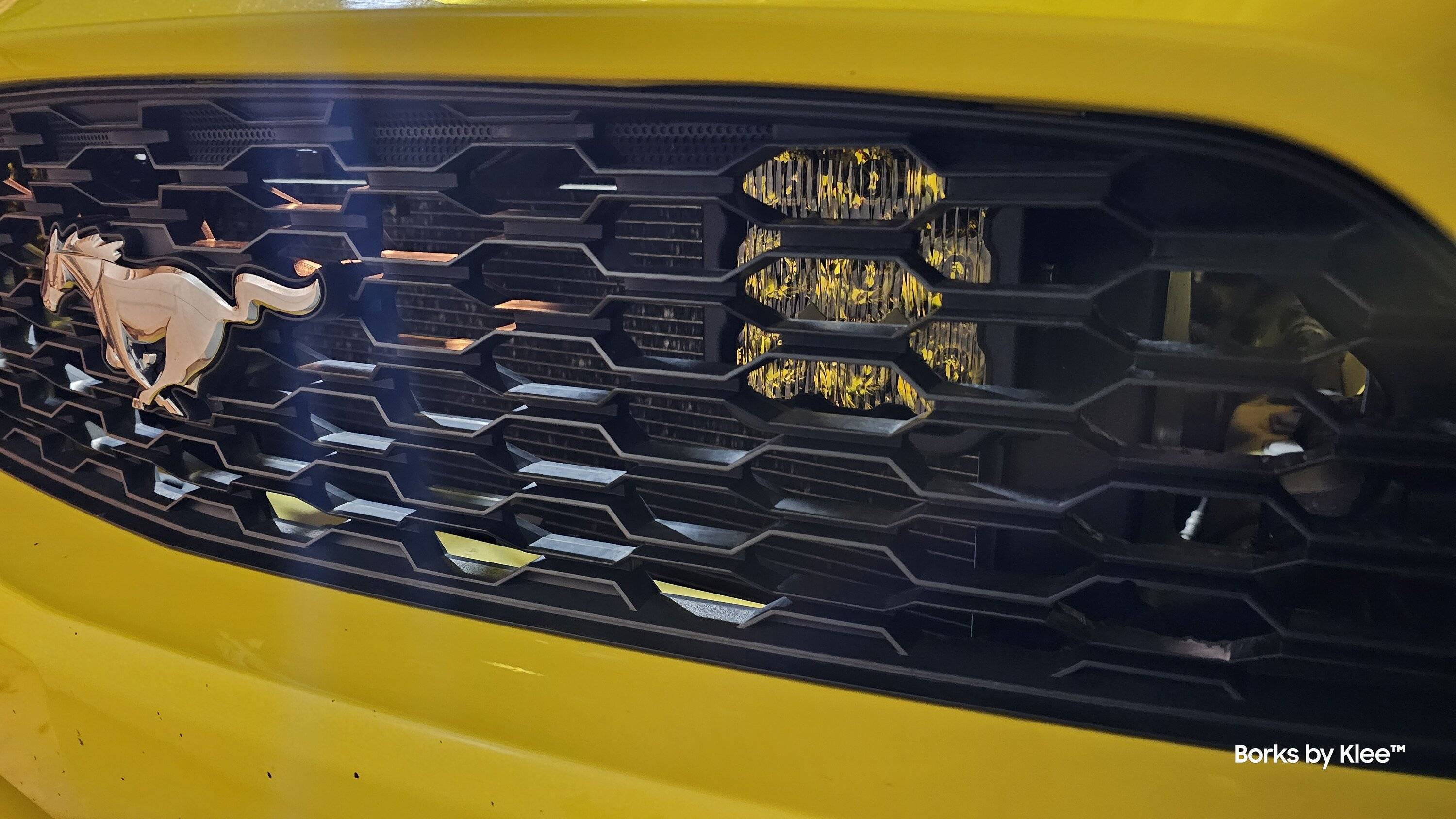

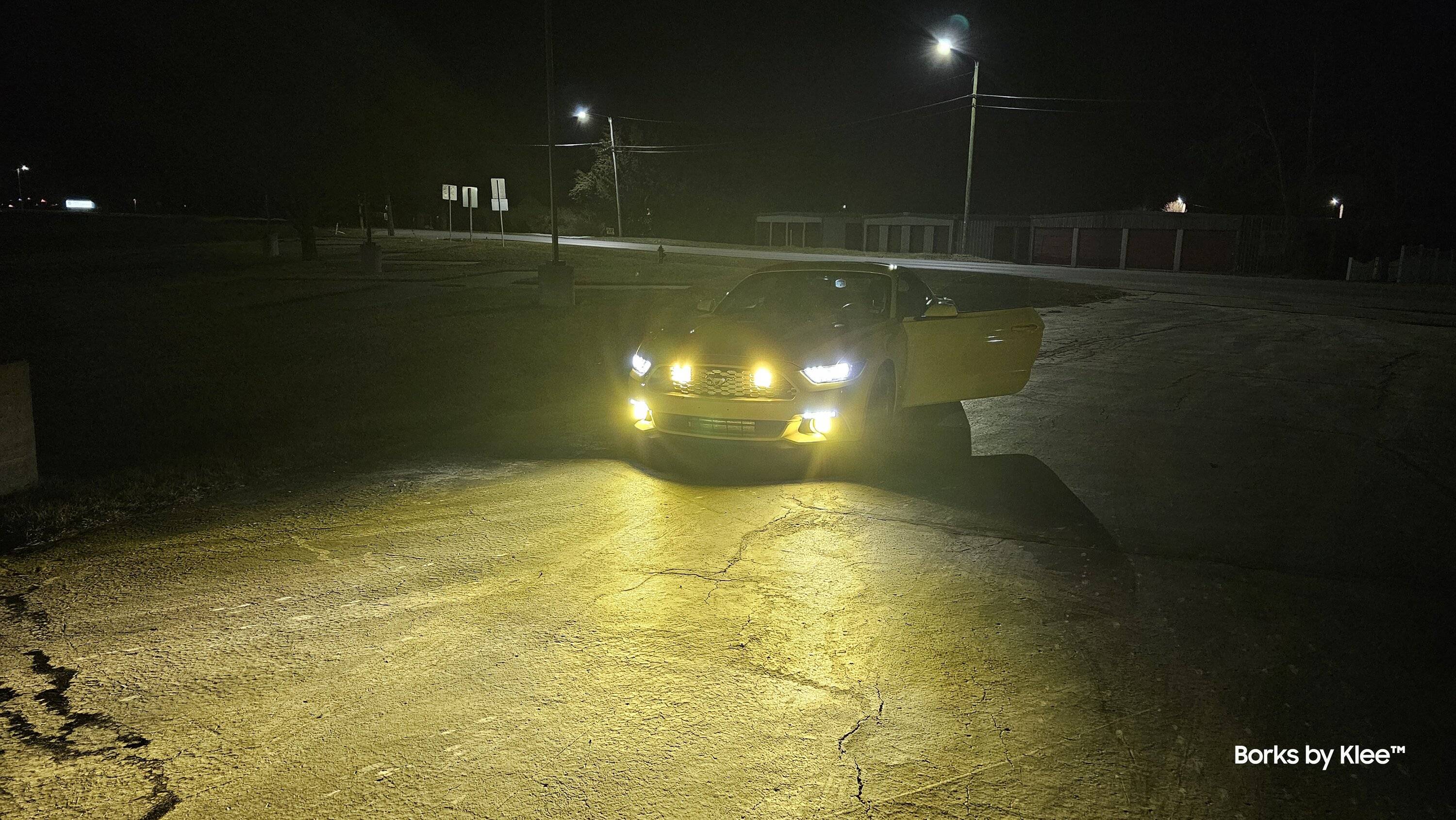

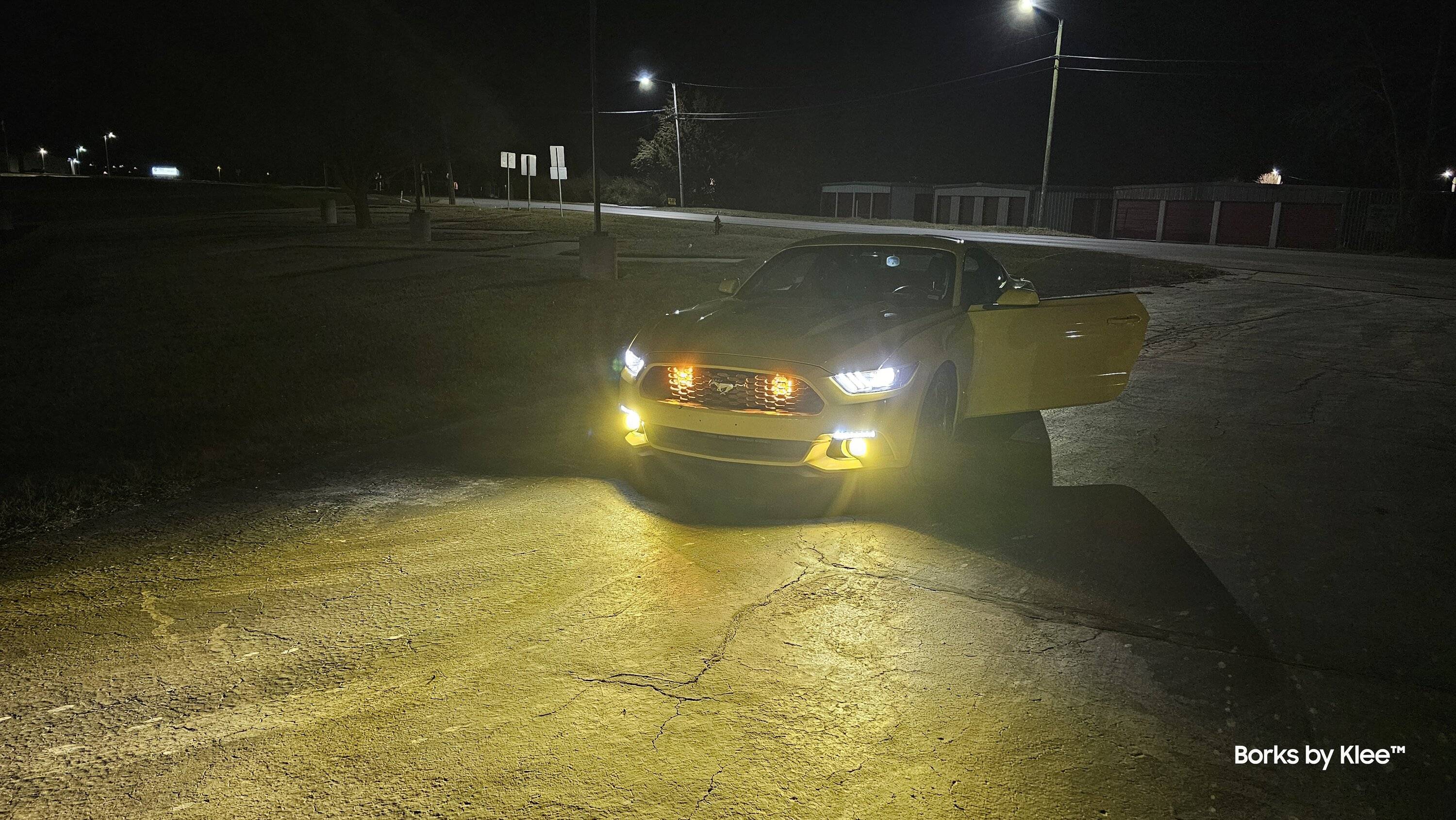

The first iteration of a 'just get it working' result 😁
Refinements will come in the form of custom brackets so I can position them flush with the grill and print shrouds for them.
The accent lights, funny enough, are bright and can be mistaken for the main beam being on.
My phone's shutter stays open too long when in lowlight areas so the nighttime driving comparison is rubbish; you might get the idea but goodness me, I can see a good half mile ahead!
Combined with my SS3 fogs, I have spread and the SS5s give me distance.

I like it! Hidden behind the grill, lots of light, looks great! Nice work.
