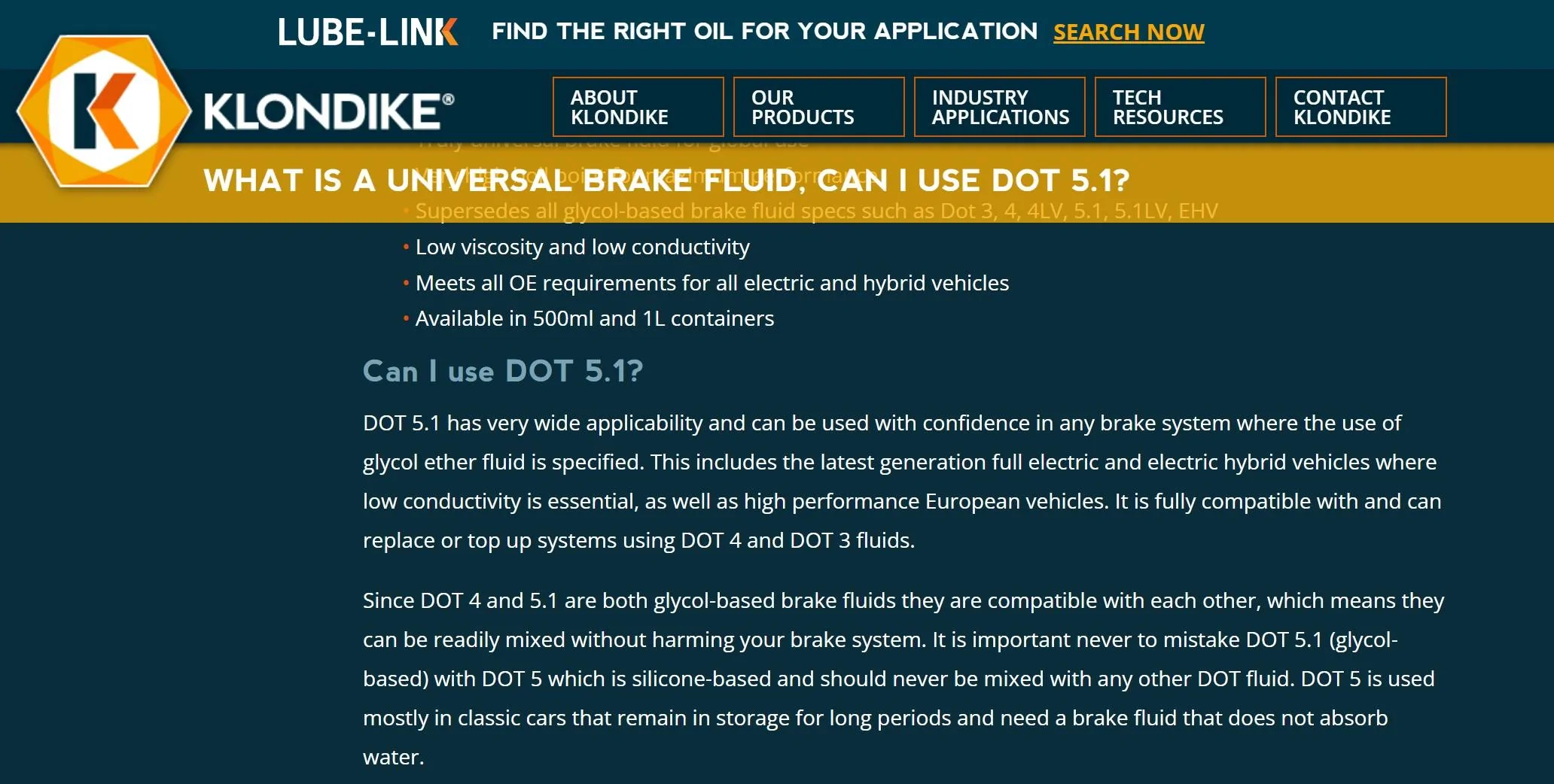

DOT 5.1 has very wide applicability and can be used with confidence in any brake system where the use of glycol ether fluid is specified. This includes the latest generation full electric and electric hybrid vehicles where low conductivity is essential, as well as high performance European vehicles. It is fully compatible with and can replace or top up systems using DOT 4 and DOT 3 fluids.
I've read that. Thanks.
