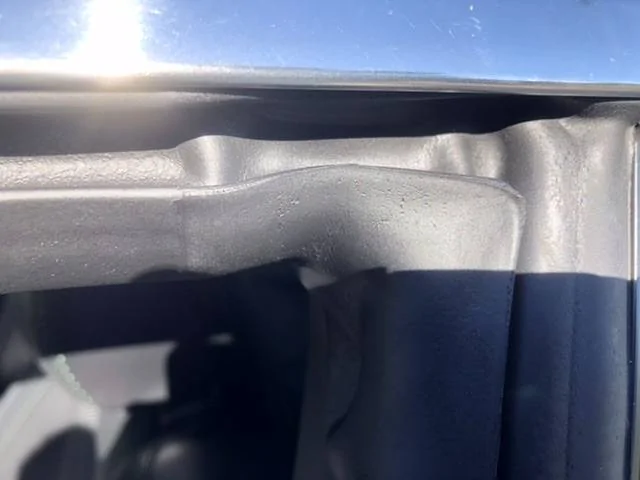

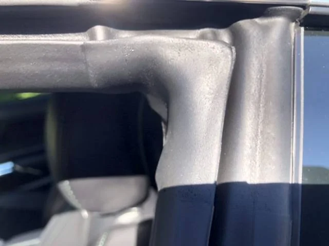

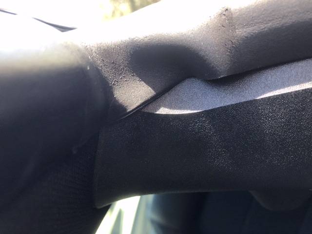

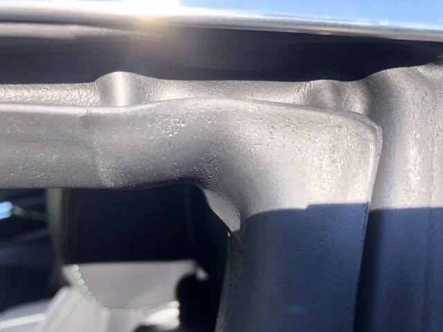

Here are 3 outside pictures and one inside picture at the drivers door. Dealer body shop says upper chrome trim to come off and be replaced and rear 1/4 side window removed a replaced with a new one. No leaks or wind noise yet so might not do it yet. What is your take?
Yep - that is the gasket. Mine was very distorted at the top corner, worse than yours. The front part of the corner was actually squished and folded under. The Service Center tried to heat it to see if they could get the distortion fixed so it would lay better but they couldn’t not do anything with it.
That gasket was totally replaced on my 2016 and as far as I know they did not need to remove the rear 1/4 glass at all - because my gasket was replaced way before the rear 1/4 glass was replaced on the same side. It’s possible the Service Writer is not aware of how that gasket is seated on the body.

The service dept sent it to the body shop and the mgr and foreman both said 1/4 window and chrome trim over the door had to be removed and replaced. It looks like it is tucked under the 1/4 window
