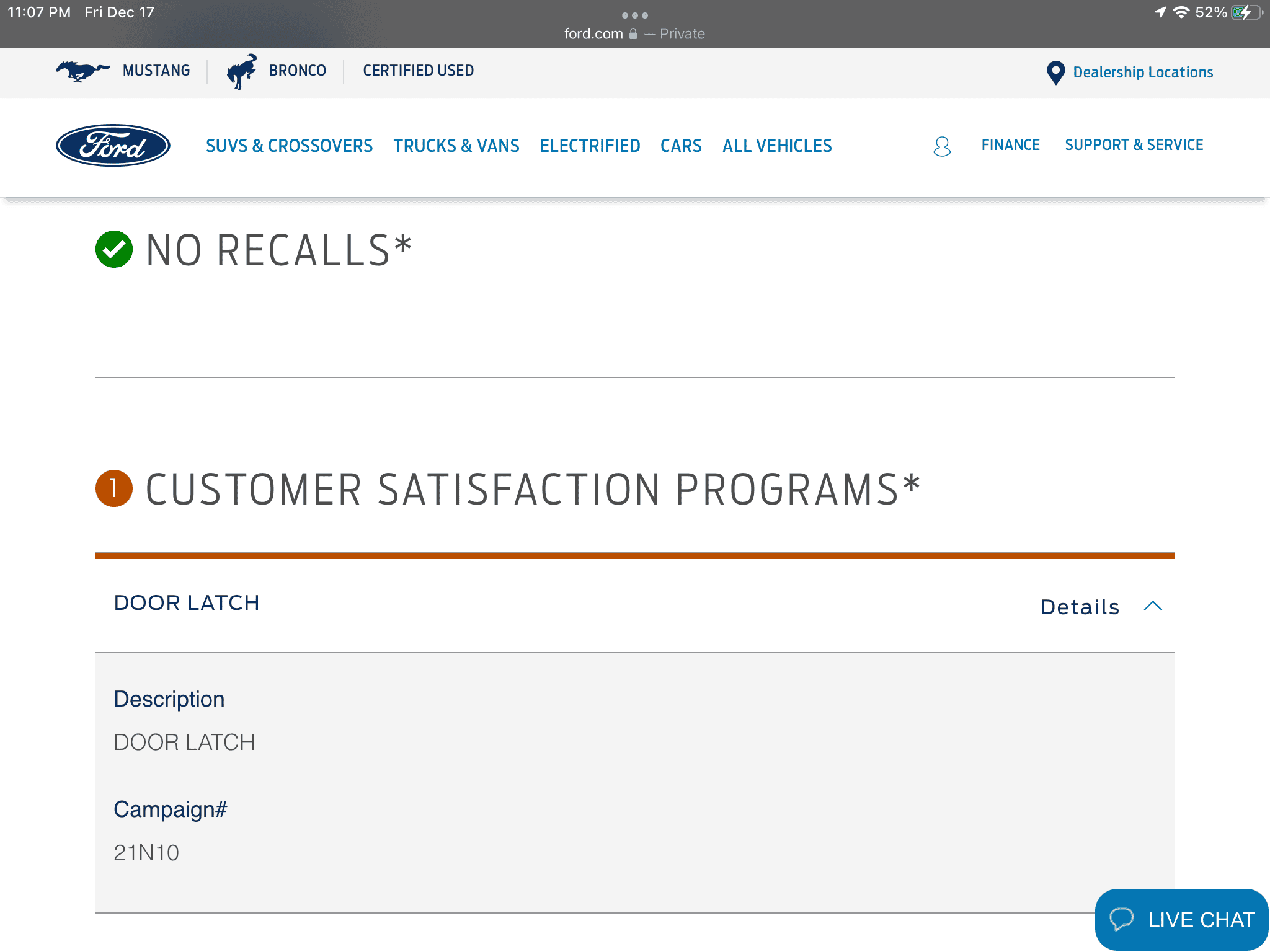

This popped up on my Ford Pass app. I googled this and the only door latch campaign was for 2015 models. I have a 2020. anybody know the details?

I got it, too. Previous door latch FSAs have been for water intrusion/freezing problems. It hasn’t shown up on the NHTSA site yet, so I’m only guessing…
I called the dealer. It's for doors popping open to the safety catch while driving. Open door warning will pop up on the info display. Program is an extended warranty for 10 years or 150,000 miles.

I just looked at my FordPass because I was looking at my oil life, and saw the ! on the recall icon. According to the Ford website, after recall searching my VIN, it showed as a CSP, customer satisfaction program, not something that needs to be done. No way am I taking the car to the dealership when I have never had an issue. They will tell me that the latches need to be replaced and then they will manage to FUBAR the car.

This was a recall for certain 2015 cars ONLY. The CSP is just for an extension of the original program. I had a 15’, never brought it in and never had the problem.

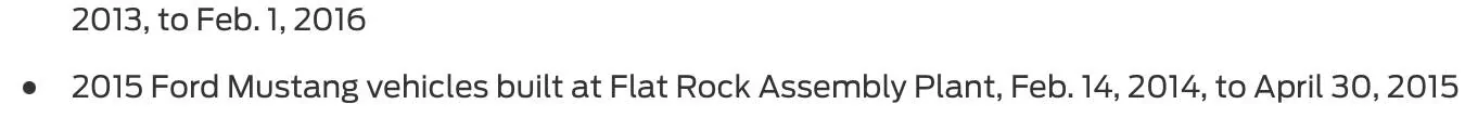

A CSP is not a recall notice. Read this and see if your car fits. I do not think it will but itā€˜s possible your car got the defective parts.
https://media.ford.com/content/ford...sues-two-safety-recalls-in-north-america.html
