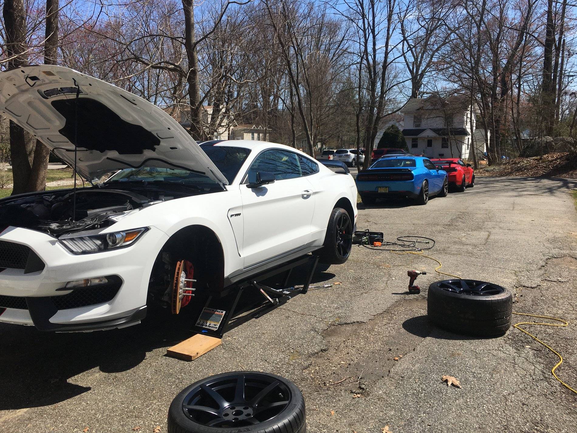

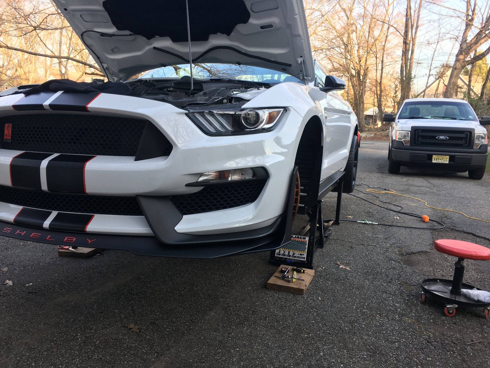

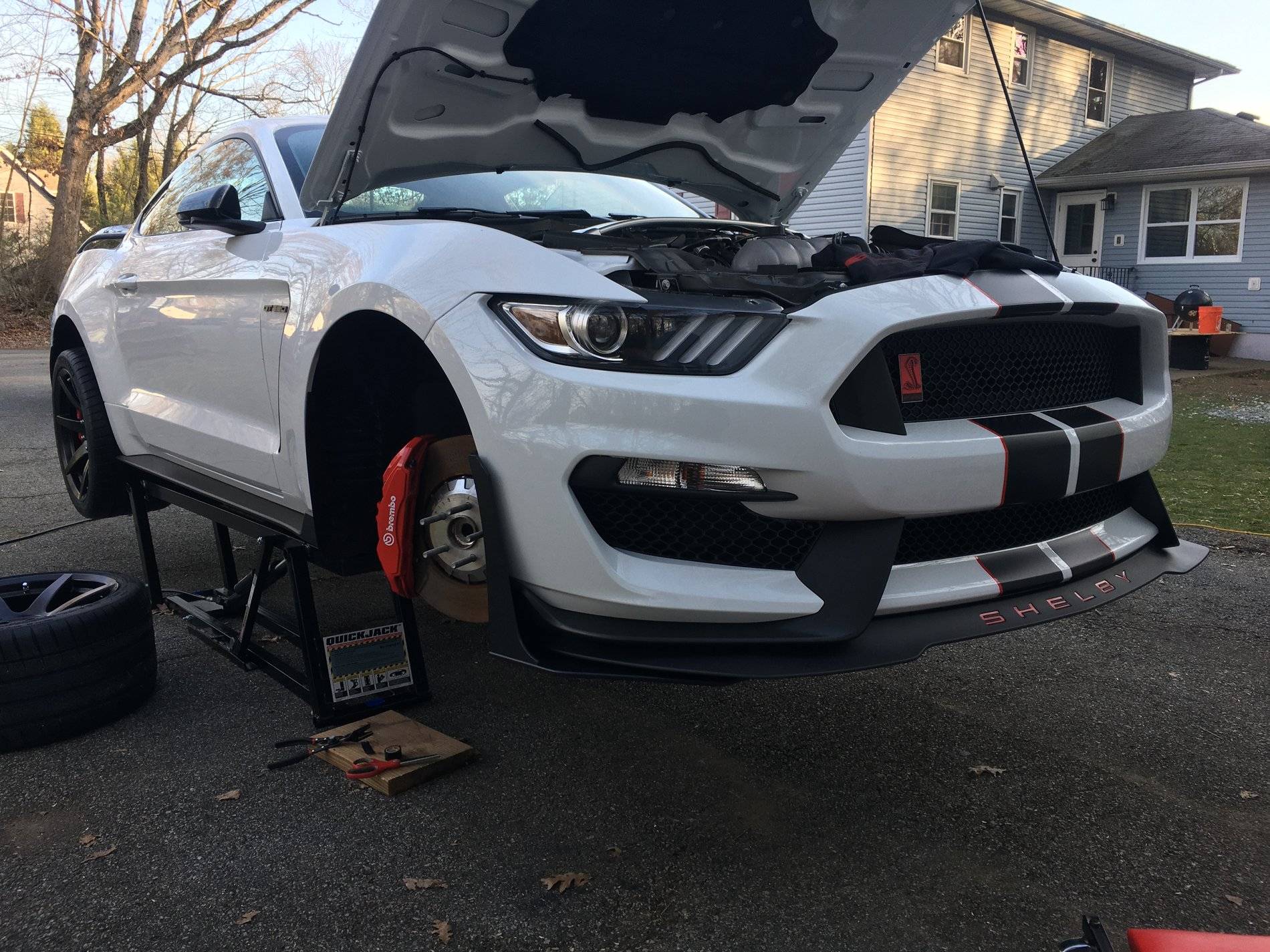

I just spent my entire day bringing the car out from under the covers. Nothing is ever easy with these machines !!!
First, dead battery, had to jump it, twice. That process took almost an hour.

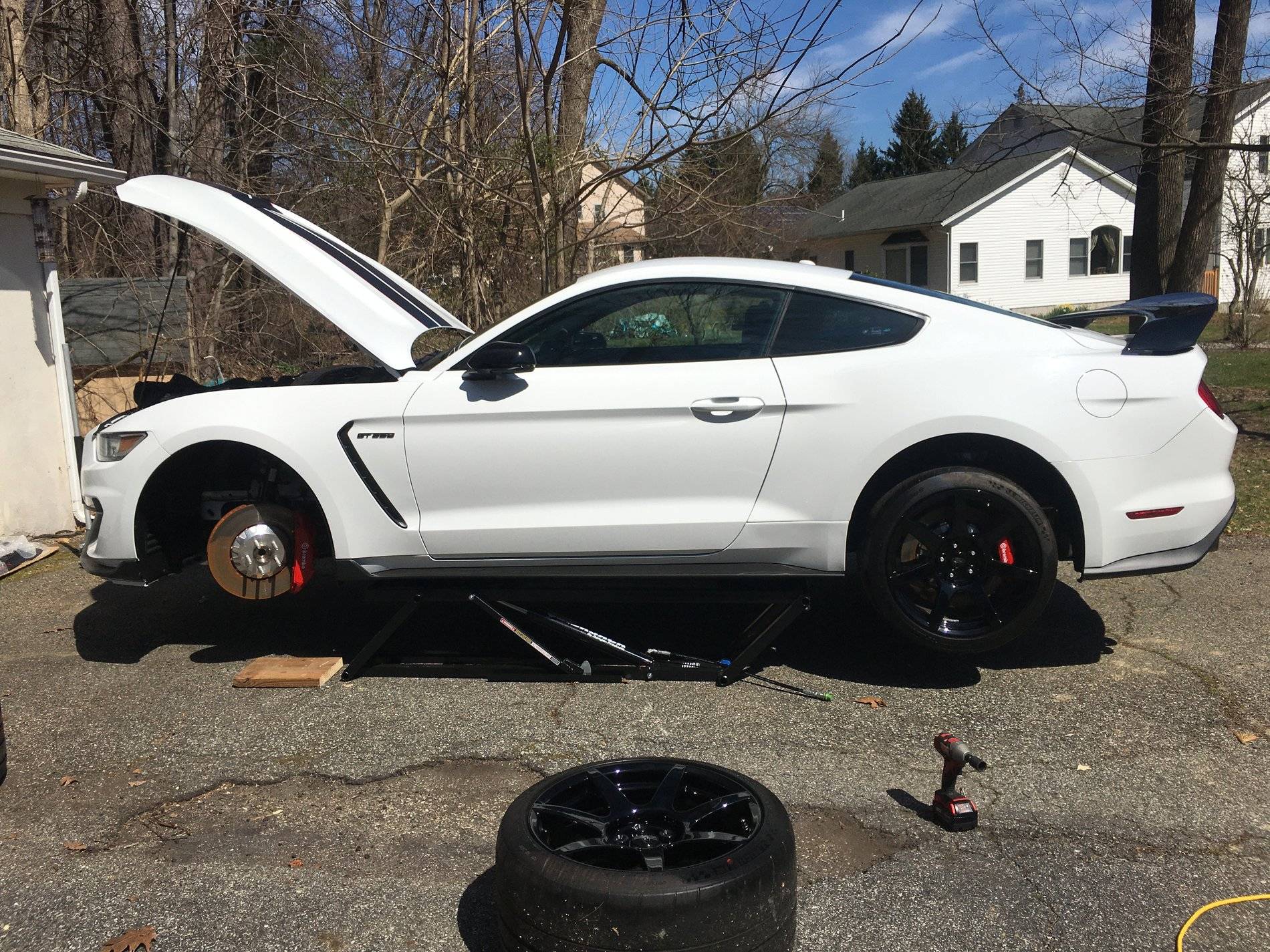

Then realized I don’t have the correct size bit (T-60) to do the front brake pad swap! Ordered caliperfexion kit, I now have to wait till the weekend or next week to swap pads.
Swapped OEM carbon fiber wheels for replicas. That went fairly smoothly, I saw a smudge on one of the carbon wheels that won’t come off no matter how hard I rub it with my fingers. I’ll have to look into that some other time, maybe get the wheels detailed before I store them away.

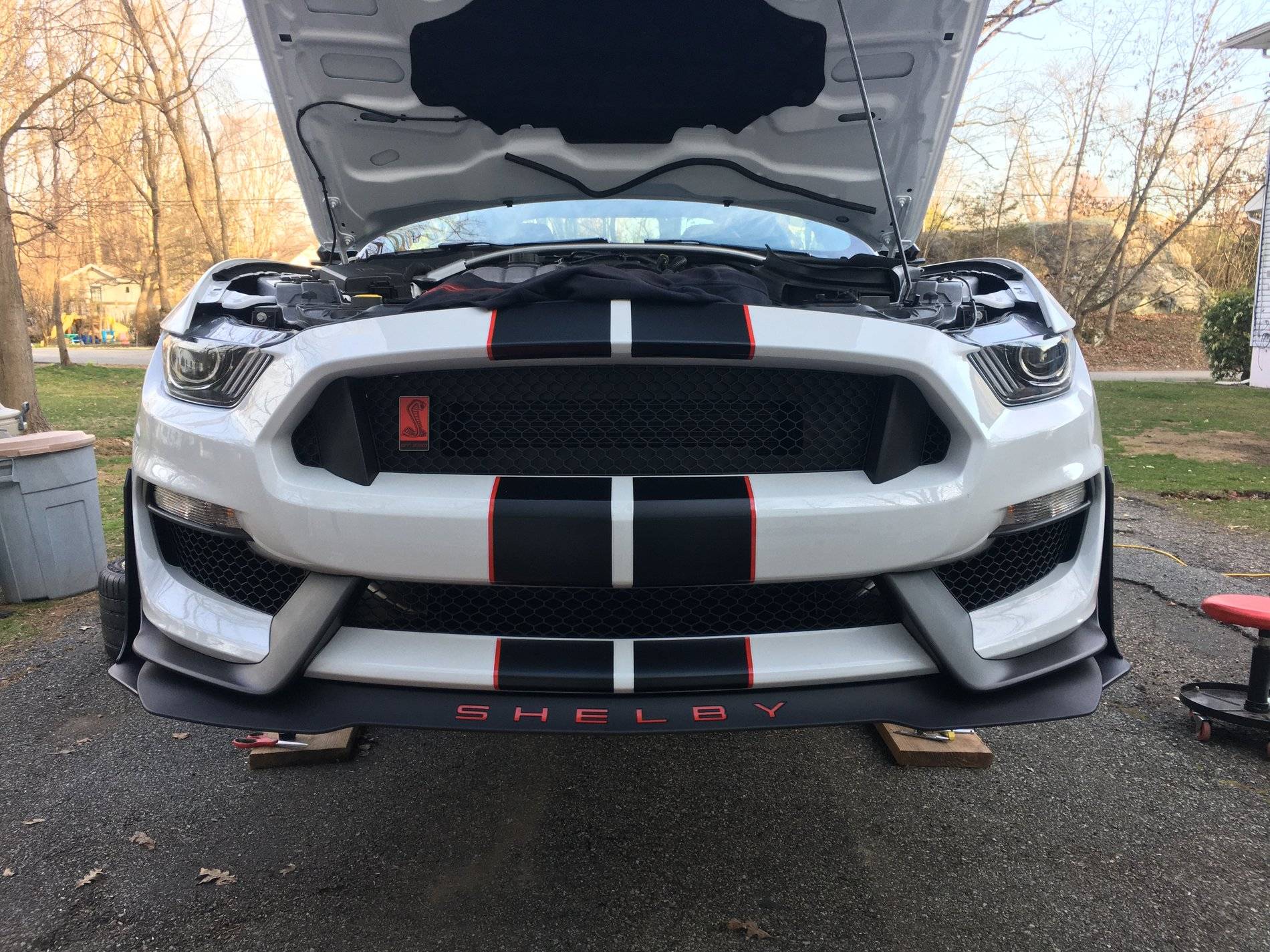

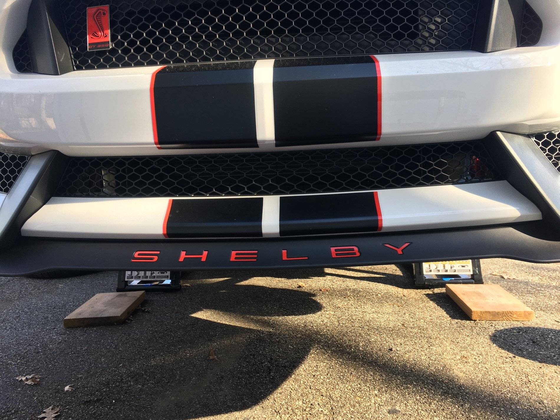

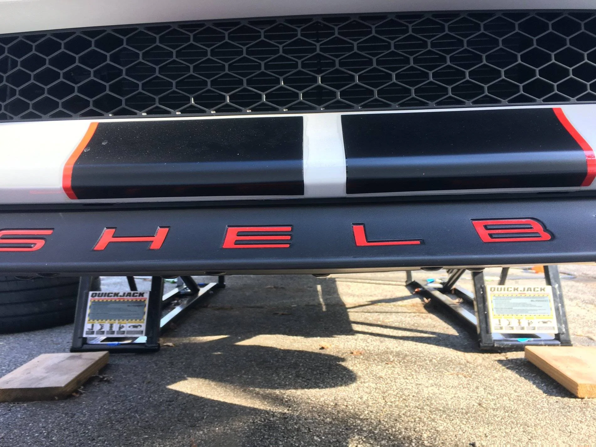

Then, installed my OEM front spoiler. THIS IS WHERE IM HOPING TO HELP THE NEXT GUY. If you’re doing this install yourself be ready, you have to whale on that thing with a rubber mallet really hard to get it to sit properly !!! No gentle hits, or bending the plastic trying to finesse it in there. YOU HAVE TO HIT IT HARD !!!!
That took me 2 hours to realize !!!! talk about patience!!! I was worried about damaging the plastic edge of the spoiler but I used a cheap microfiber towel to protect the spoiler from the rubber hammer I was using (like the Ford video shows) and I had no damage at all.
so if you’re doing this at home, don’t be afraid to hit that thing hard. Make sure all the tabs are lined up with the holes and send it home hard.
I wrapped up the day after installing the blue FP intake. And the ZL1 Addons GT500 style winglets. Those suckers gave me a little bit of a hard time as well. It’s still an easy install, you just have to be patient with one of the bolts. You’re literally sandwiching 4 different pieces so trying to get all the holes to line up was a pain in the ass.
Tomorrow I have the two oil separators to install, mount the front wheels, jump the car back to life AGAIN and hopefully go for my first official drive.
I wish I would have recorded the first time it fired up, talk about a cold start!! I think the windows in my house were rattling !!! That thing was loud as hell !! Haha, I love it !!

Nice GT350!
How do you like the Quick Jack? Is it easy to move around?

Thank you!
I love the Quickjack man!!!! They are some of the best money I’ve ever spent on this hobby.
They have wheels on one end so you can pick up one end and roll them around. They are heavy as shit though, I’d guess around 80 pounds each, if not more.
if you have a smooth surface to work on they are a dream to move around. If you’re stuck with a shitty driveway like me it’s a little bit of a pain in the ass to slide into position. But even then, they are worth their weight in gold !!

Yeah, you should have no gap between the front splitter and the bumper. If you want to put your mind at ease, raise the front of the car and look under (in the belly pan area). You should be able to check and see if the bolts that hold the leading/front edge of the spoiler were properly installed. If they are there, then you have nothing To worry about even with a small gap between the splitter and the bumper.

Red, White, Blue! Ford, Chevy, Mopar! Beautiful All-American Trio!

thank you sir, I’m brainstorming on how to take a cool picture for 4th of July this year. Red, white and blue American muscle.
