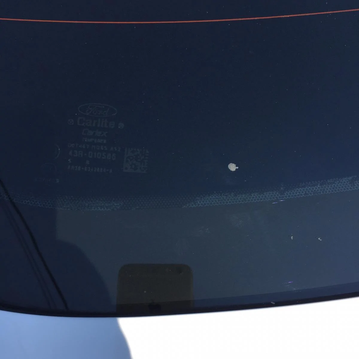

Anyone elses tinted rear window look like this?

yea you cant get good adhesion on those dots, many cars are like that

My last 6 cars have looked like that. In time you will see all of them. No way around this

just the way it is.

Any one have pics of theres? I wish i had them stop the tint at the dots

You can massage the dot area so the tint stick better.

i answered your question in your other post and why it looks like that.... yes its normal and if they stop at the dots there will be a light gap around it and you will be unhappier than you already are.

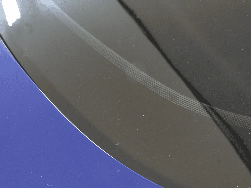

Like said before, everyone will have this problem and having them stop at the dots would probably make it look worse. Give it time and all the water and air will escape and it will look uniform. Here's mine and I've had it tinted over a year.

Okay so it will be more uniform? Like was yours all uneven like mine at first?

yes.... if its a fresh tint job it will dry out and look the same all around.... what you can do is in about a week, take your finger and run it along those spots to help the tint stick.

Okay cool because it was done yesterday

the tint shop should have explained this to you when they delivered the car after the job was done. I always explain how the dots are to every customer so stuff like this doesnt happen.
