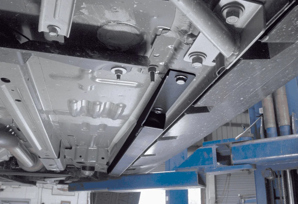

I know this is old but does anyone have BMR jacking rails installed along with the Steeda Subframe braces?.. the jacking rails were like the first thing I installed on my car.. and I wanted to put on the Steeda braces tomorrow.. but just clicked in my head it might not work.

No - the BMR Jacking Rails will not work with the Steeda IRS Braces without modification. They mount to similar holes. Here is a picture of the Steeda IRS braces working with the Steeda Jacking Rails:
