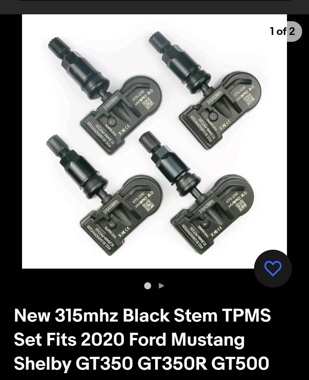

Are you able to find them in black?
I found these
OEM part number it replaces: F2GZ1A189A, F2GT1A180AB, 20280, TPMS35, F2GZ-1A189-A, F2GT-1A180-AB
