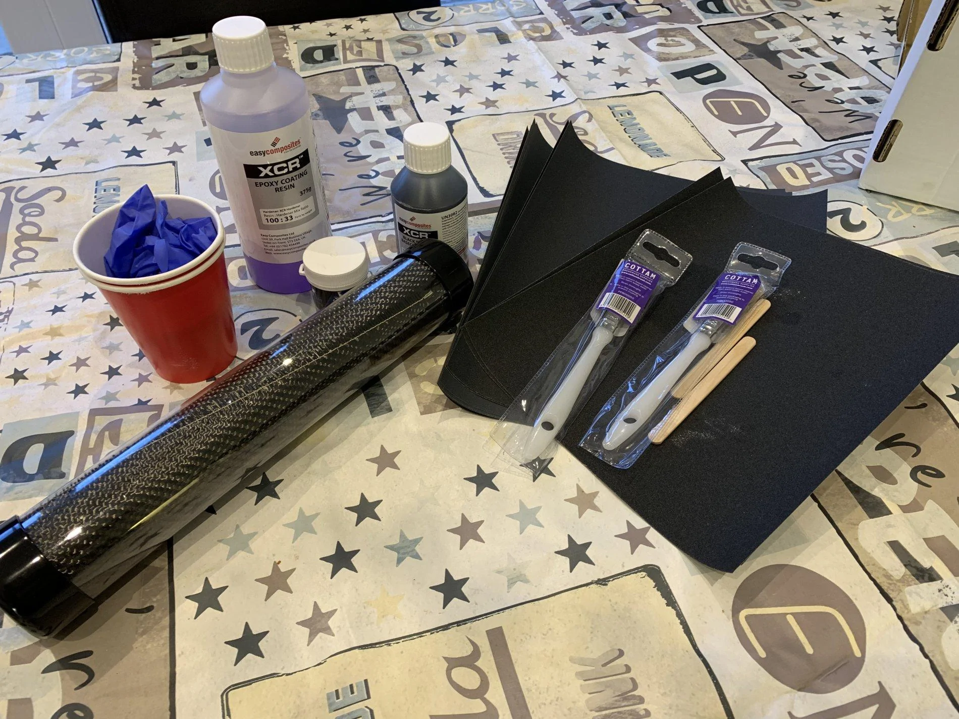

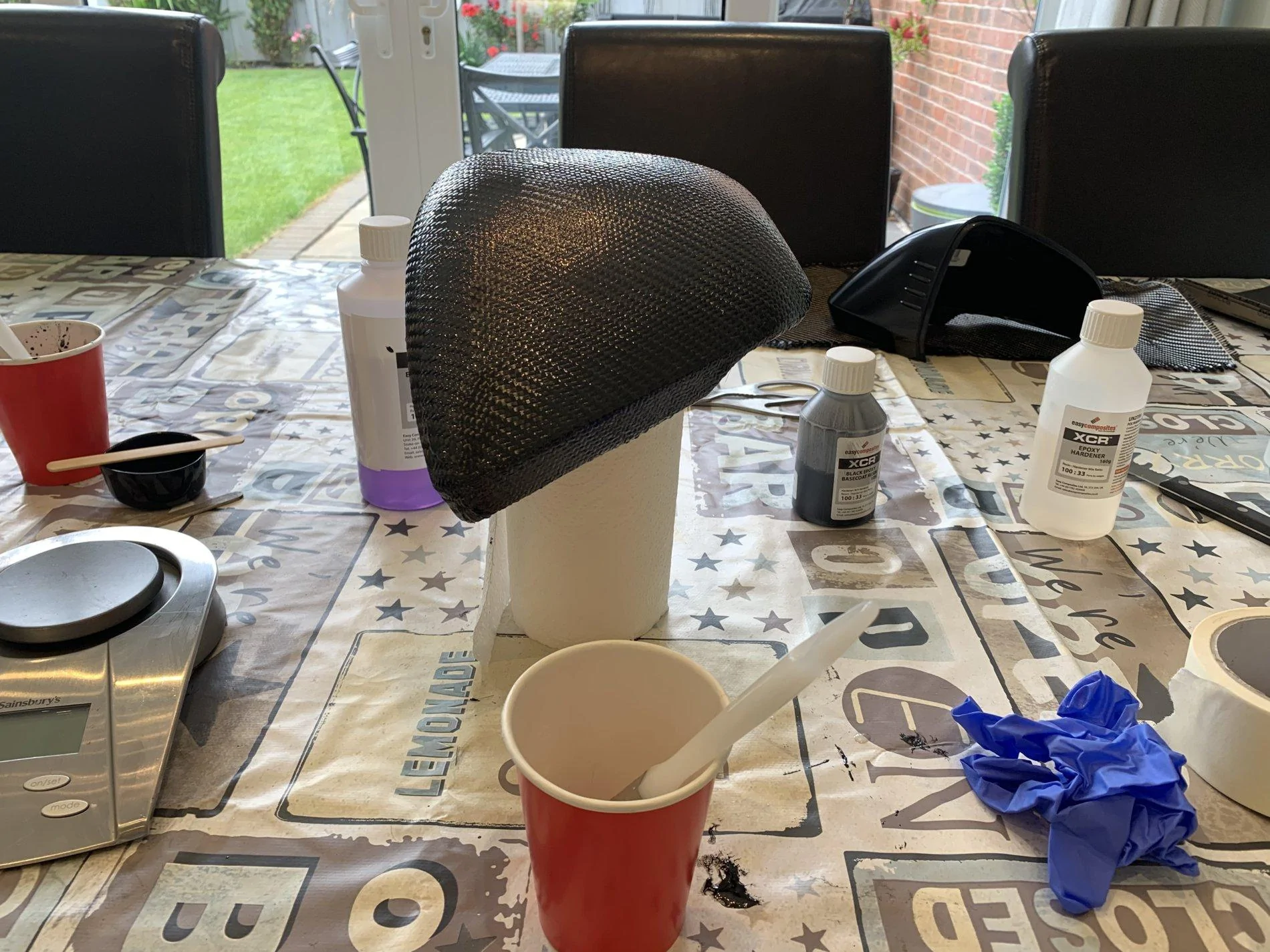

So this is the kit I received very promptly in the post. Best part of £50 all in.
Looks fairly comprehensive albeit I found out quickly there’s not enough brushes or cups !

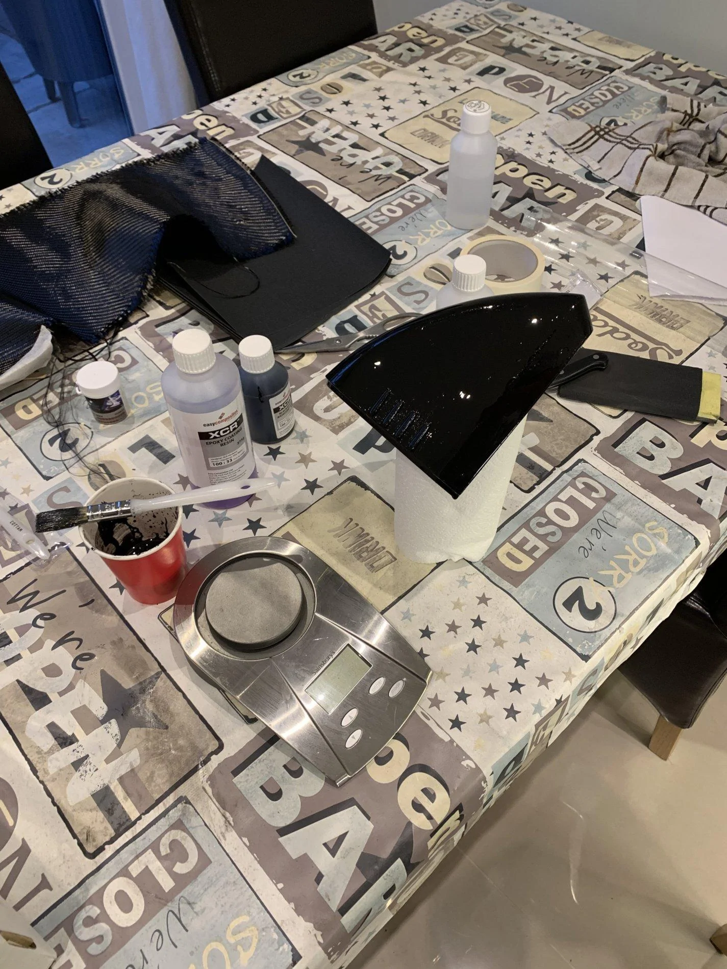

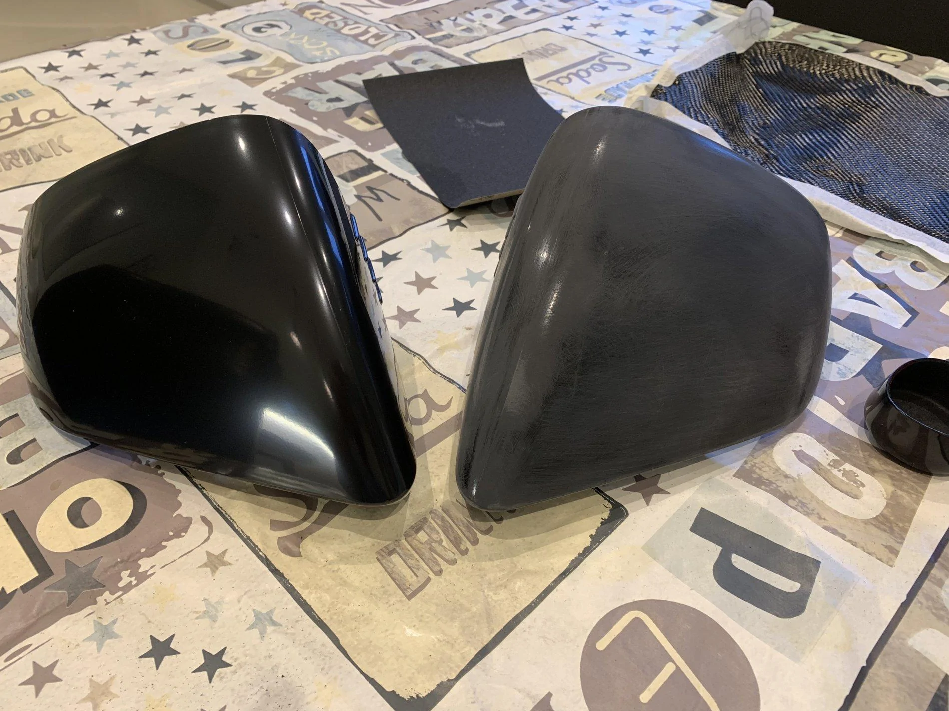

So first job was to key the unprimered mirror cover and they advise deep heavy scoring on exposed edges to allow for extra grip which I did too.
Then a black epoxy base cost was applied.

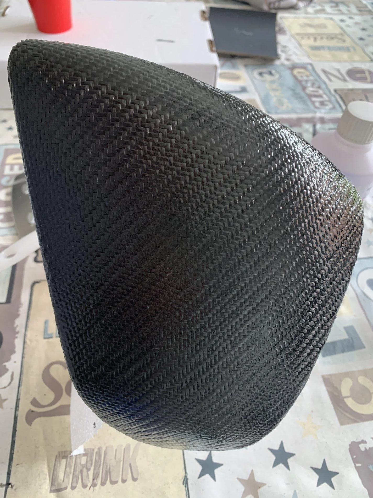

When this gets to the tacky stage the carbon fibre mat was carefully laid over and stuck down. Now I’m not going to lie this is the trickiest part by some margin and that carbon fibre is a pig to deal with. It’s so delicate it can very easy distort or fray so really take your time and know in advance how you’re going to lay it as you get one shot at it !

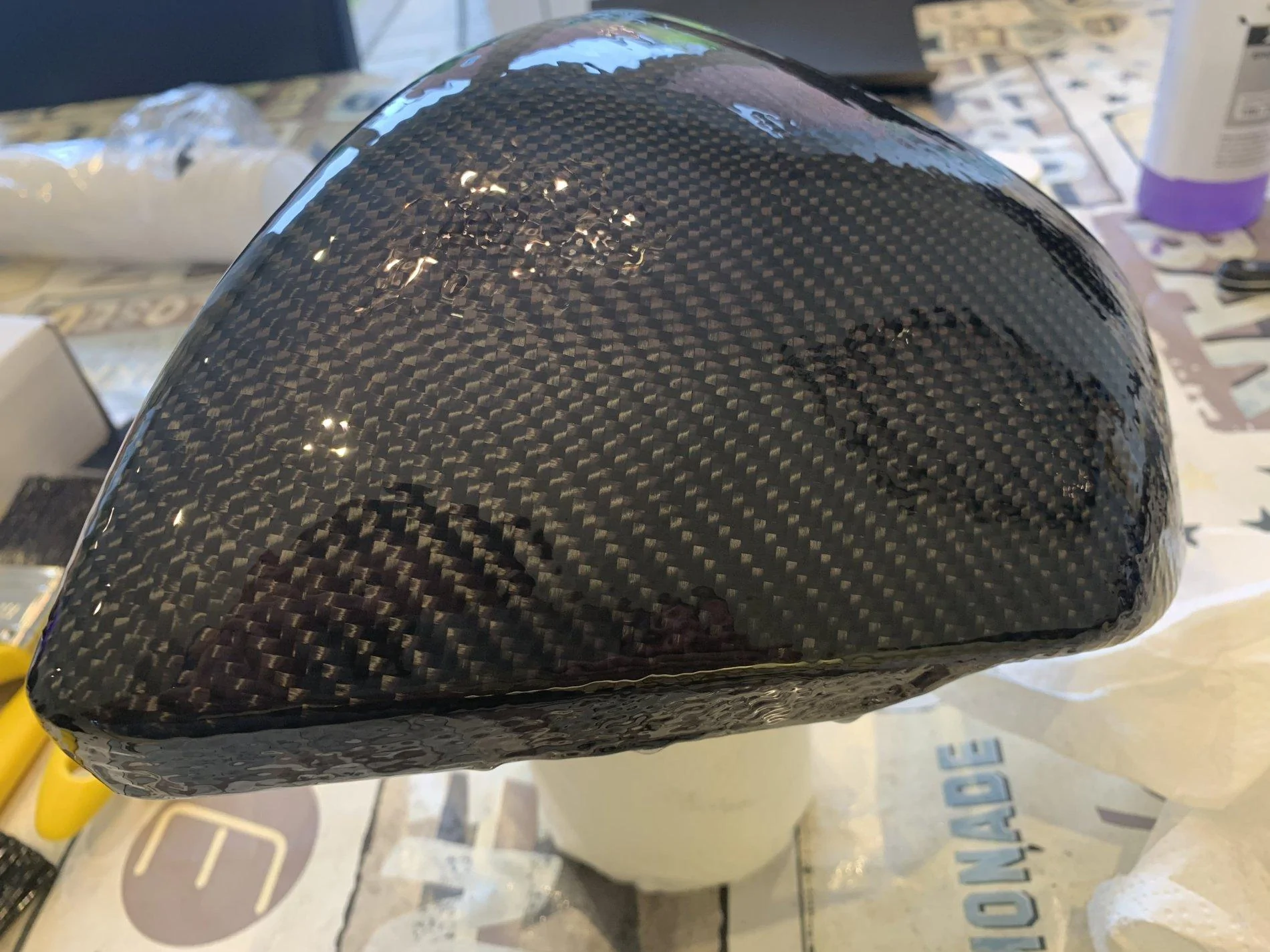

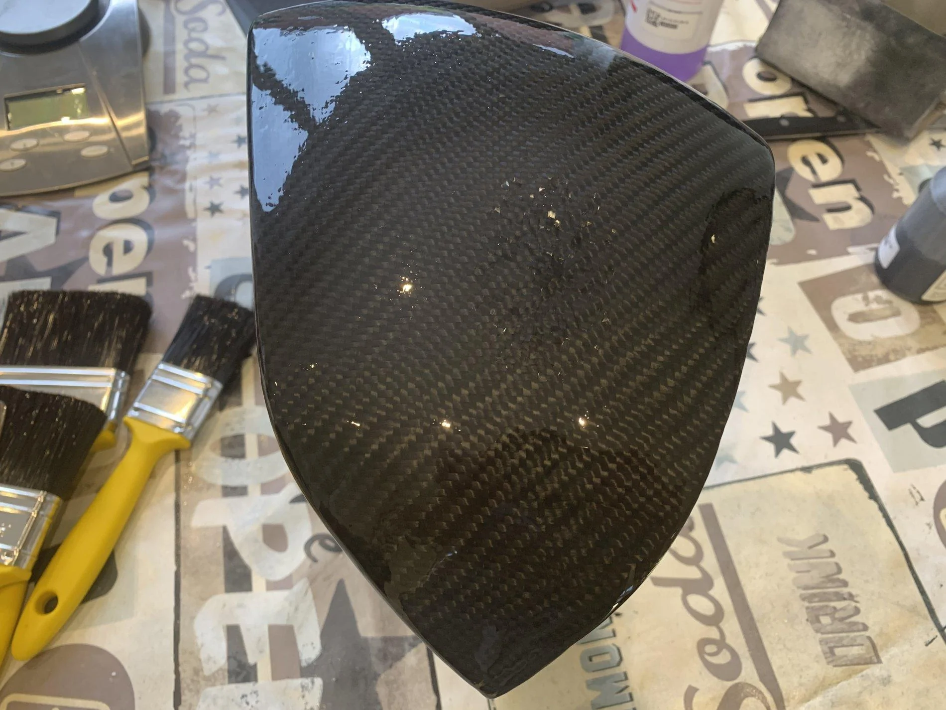

Once the base had fully cured overnight next up was the initial coat of epoxy resin, just enough to wet the fibres through. Then left overnight again.

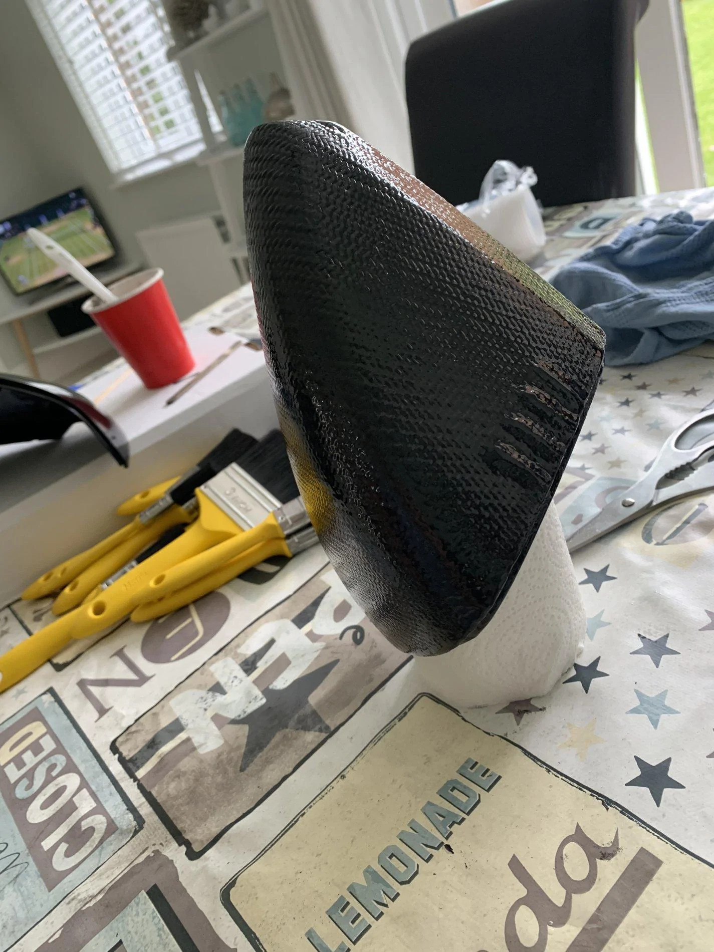

Following day I was thinking oh god, it’s looking a right mess underneath and on exposed edges where I wrapped it round. Trial fitment on car showed it was not even close to fitting as it was too thick. Then I had an ideal, out came the Dremel and I cut back the CF to the recess and it looks and fits great. Phew

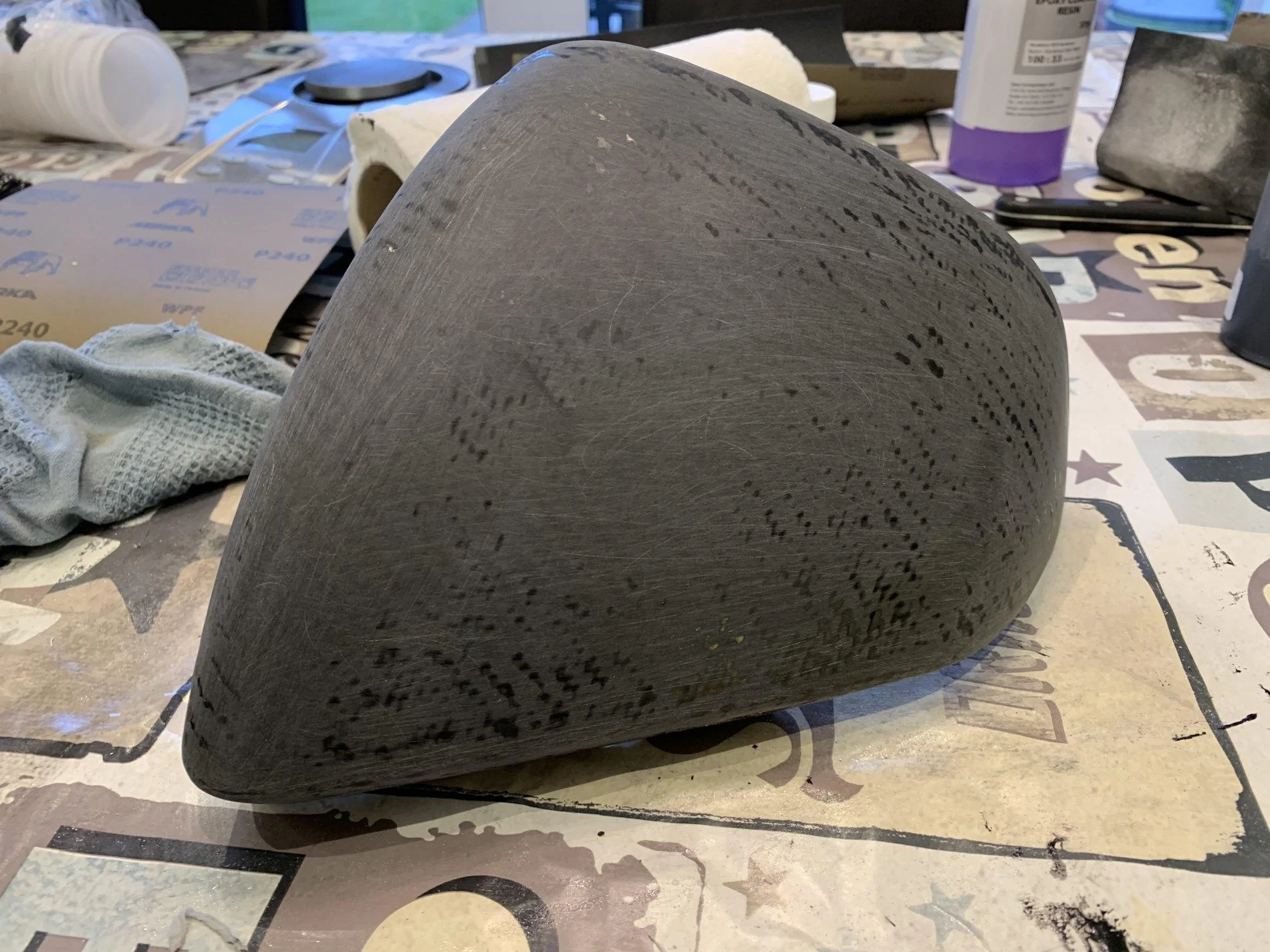

So next up was to sand high spots, key all over and get rid of excess CF.

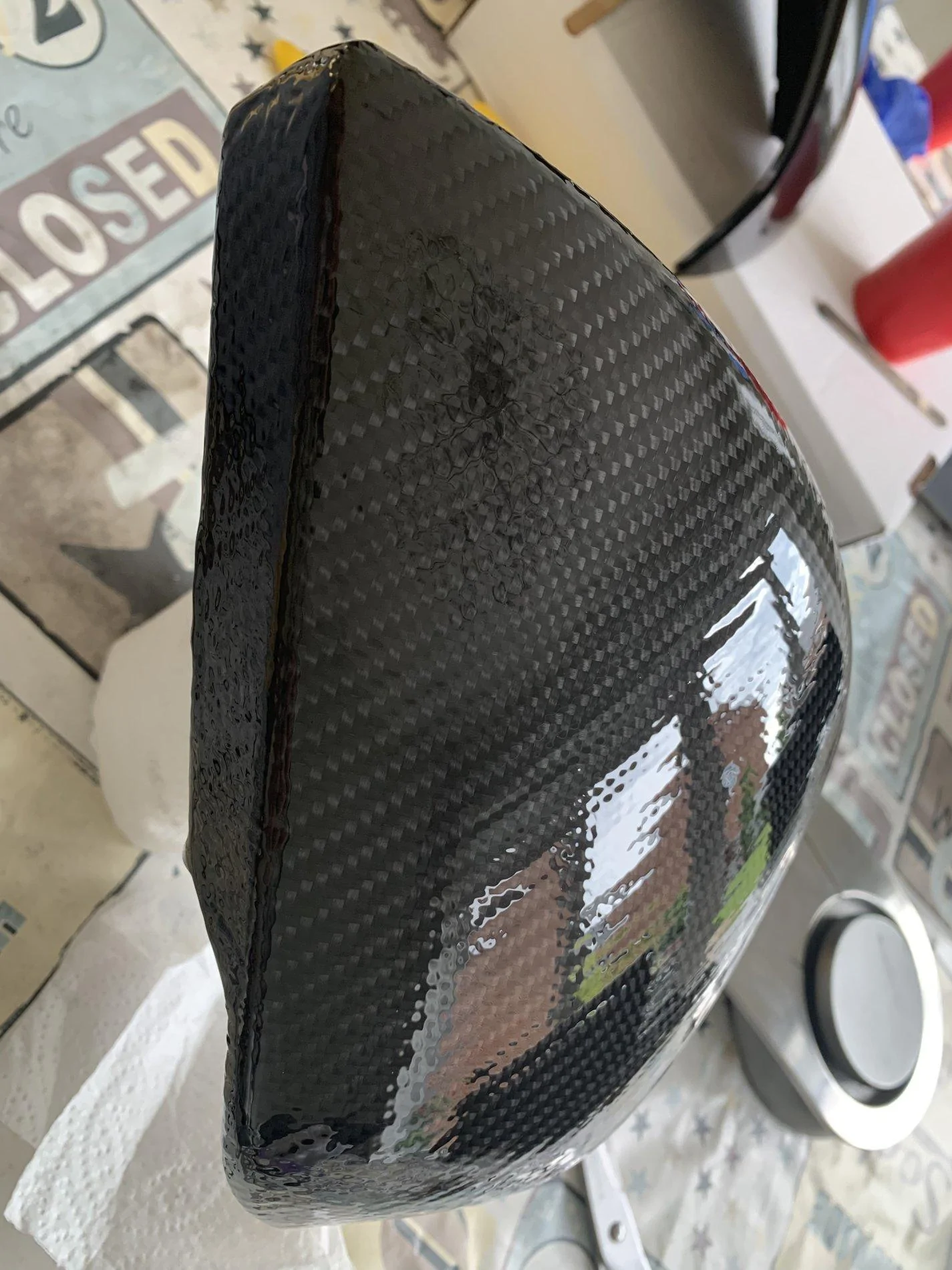

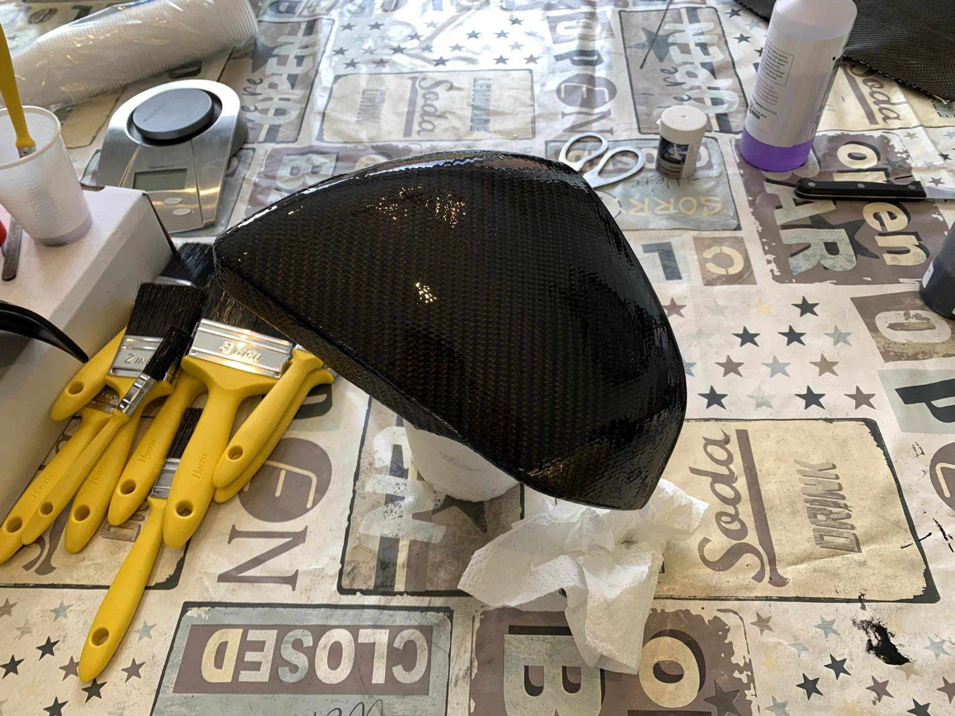

Wipe down with IPA then on to last stage three coats in quick ish succession of resin waiting circa 2 hours between the coats from the epoxy to go tacky before applying next layer.
So this is where I’ve got to now, it’s curing over night before tomorrow it gets wet sanding through the varying grades of sandpaper to remove orange peel and gain brilliant shine.

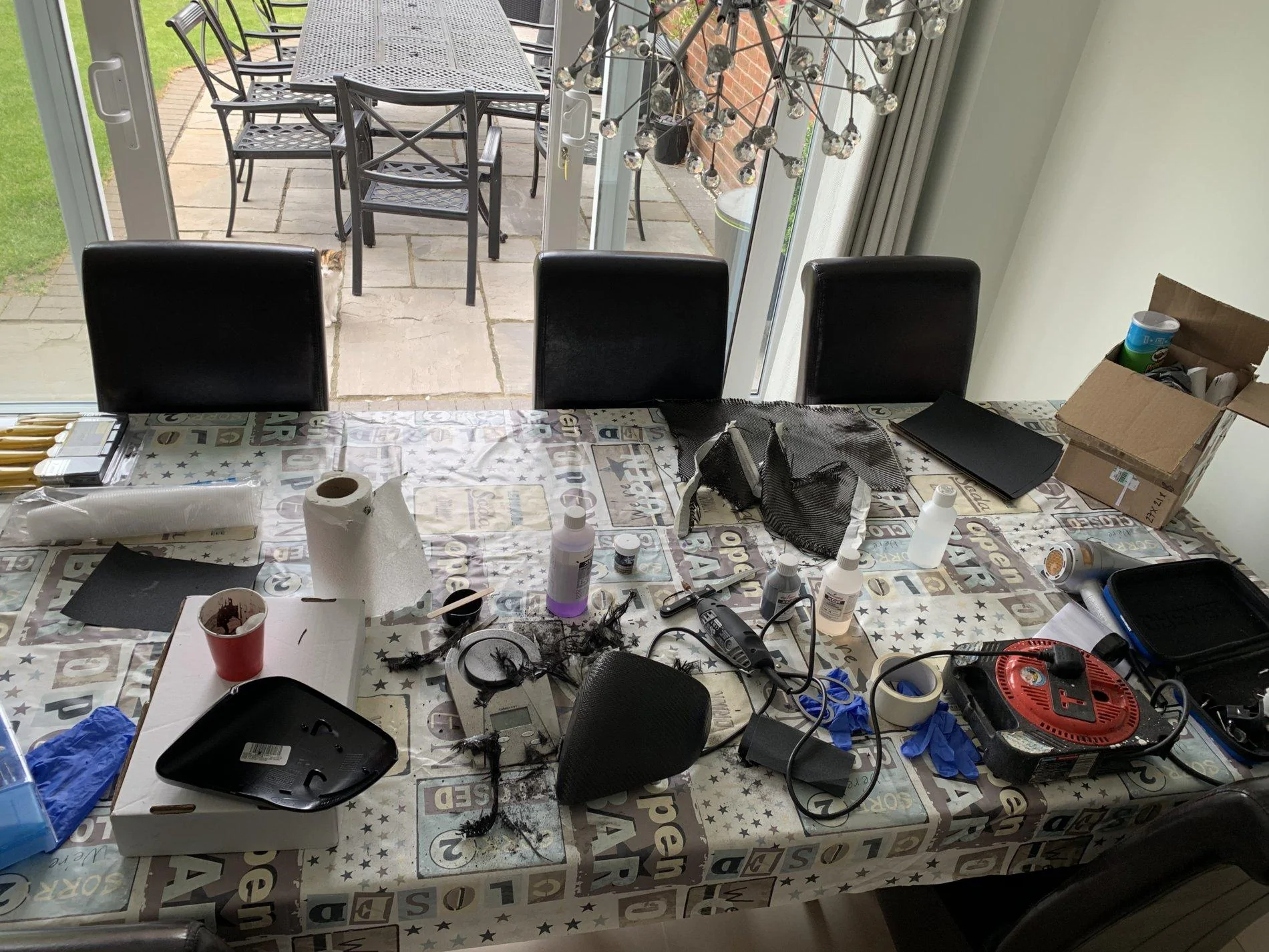

I’ve done a good job of trashing the kitchen whereby the wife is moaning a lot but hey ho this should save me best part of £300 !

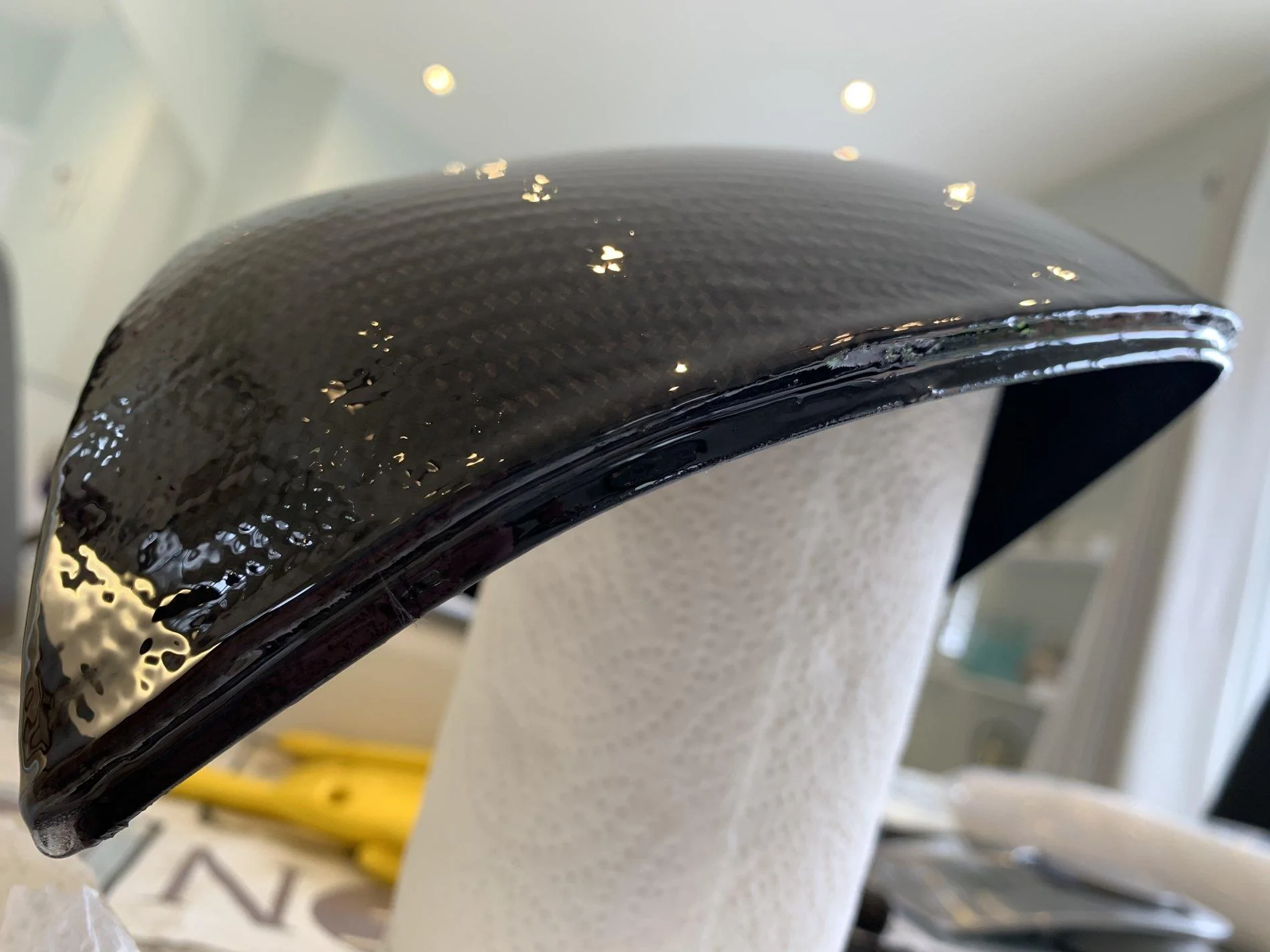

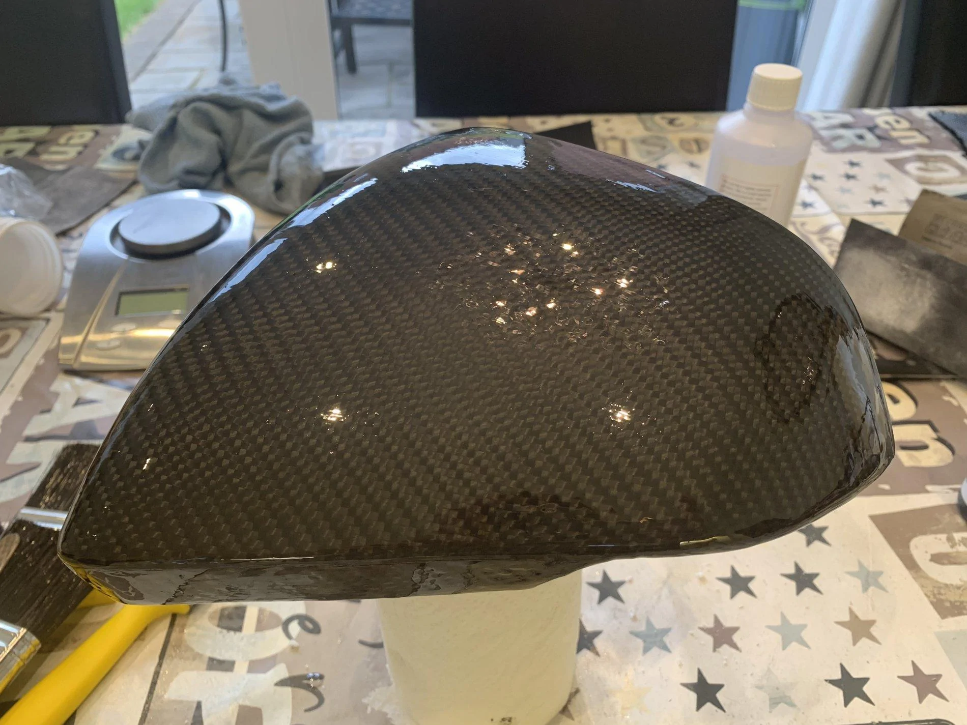

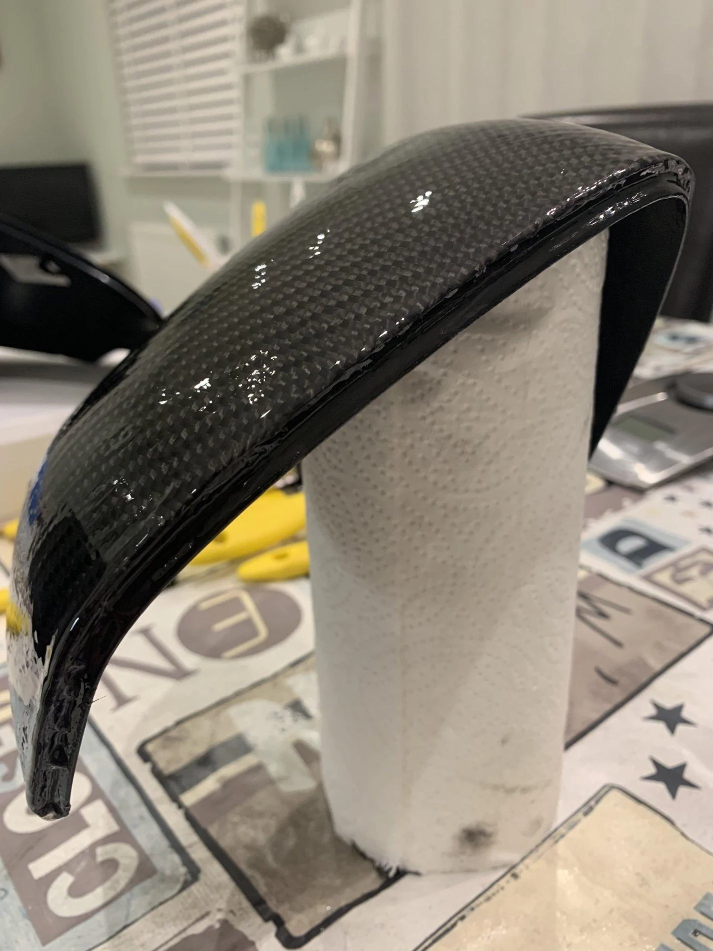

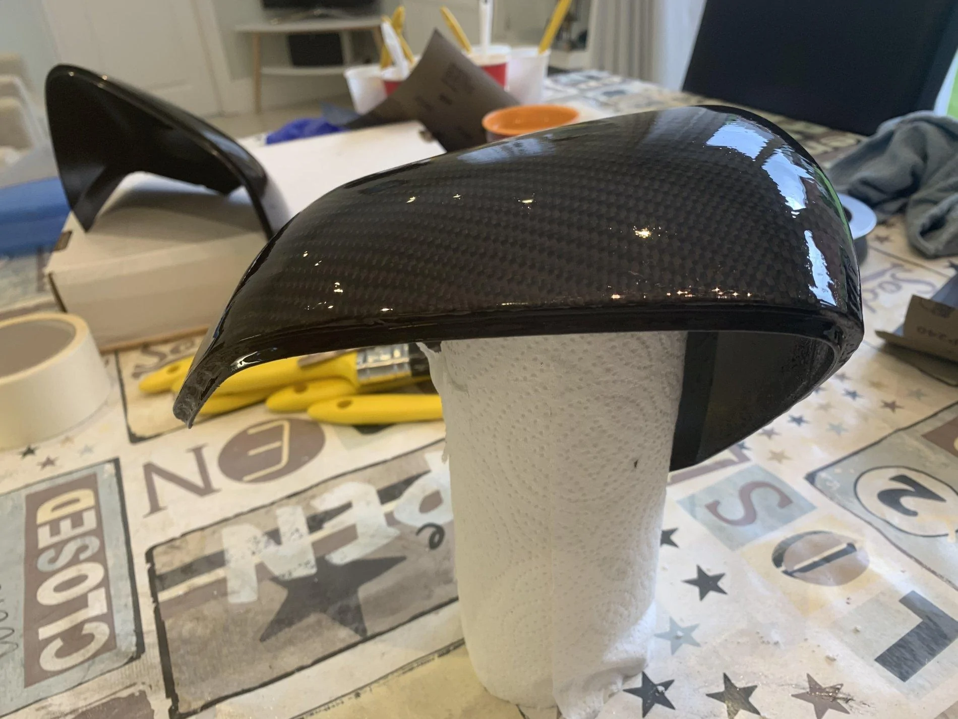

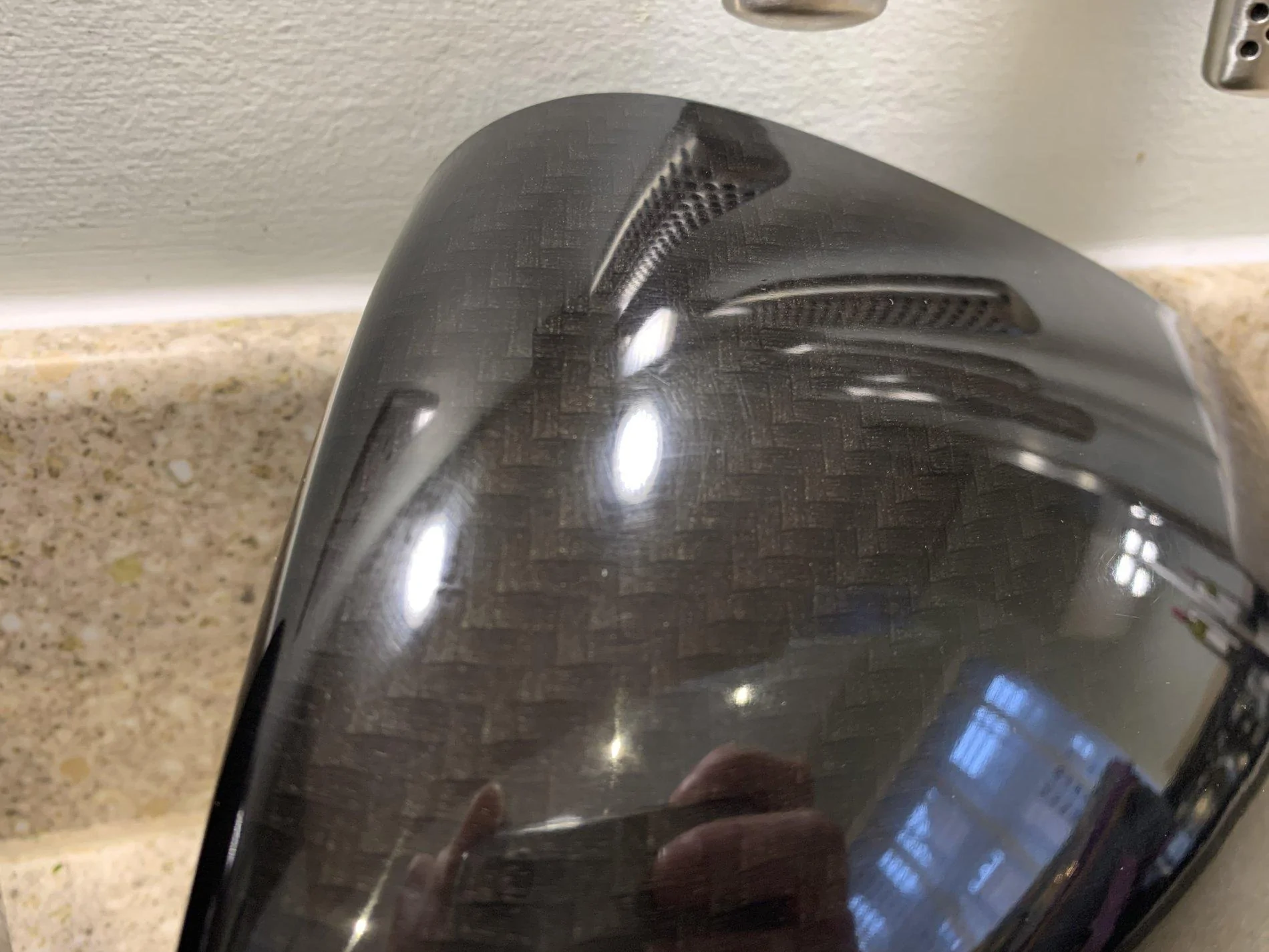

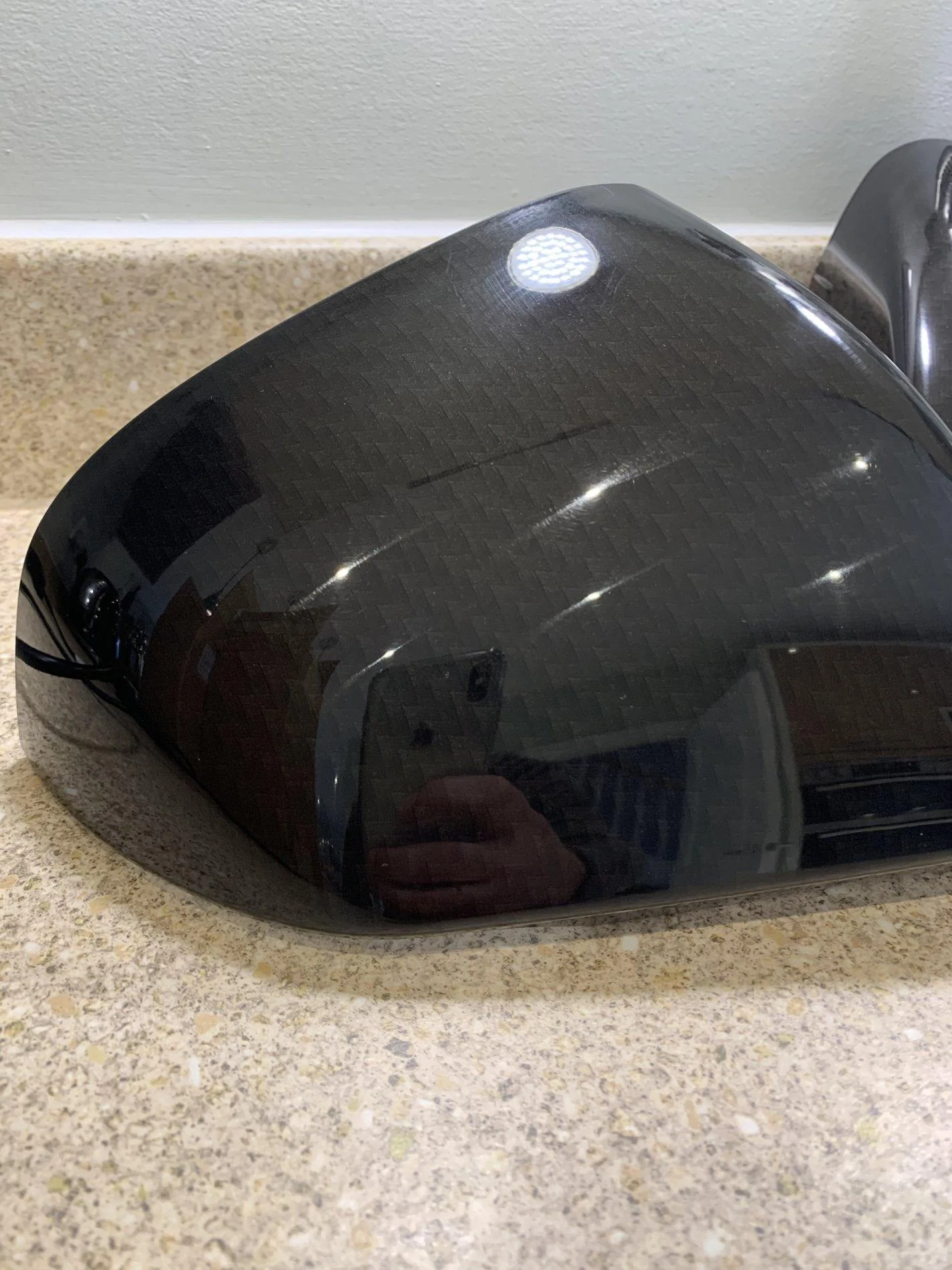

So I got a bit premature with this as theres still one more stage to go which I learned after rewatching the video !
Tonight I’ve sanded it back to remove orange peel and defects with 120 grit then 240 grit paper.
Followed by one final very thin coat of resin.

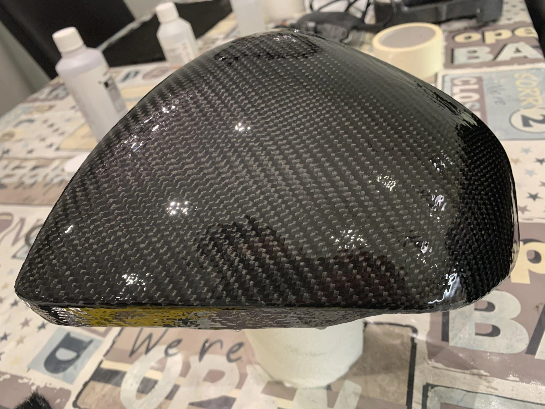

It’s really starting to look good now and very pleased with myself and for my first attempt it’s almost good enough to sell !

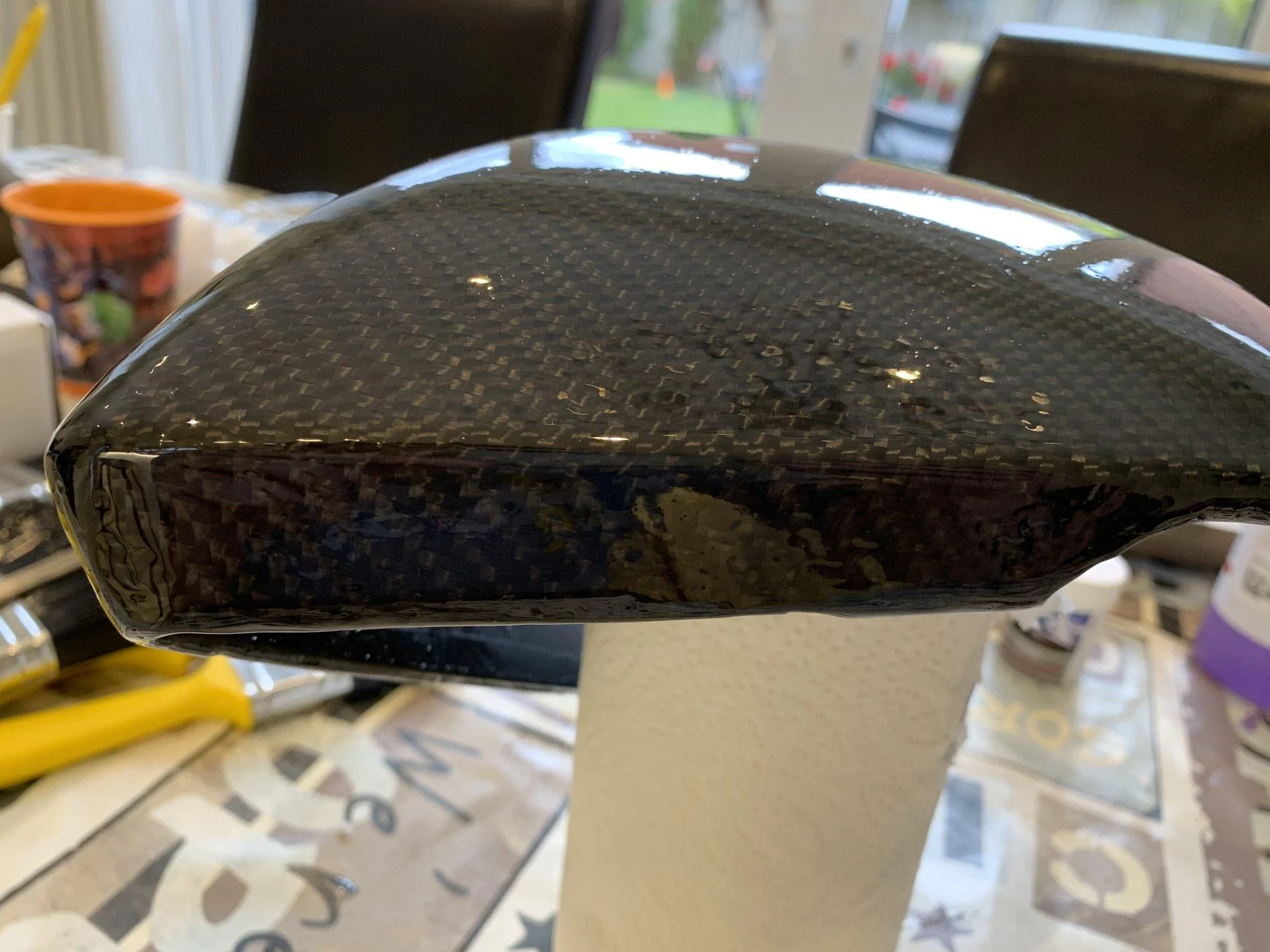

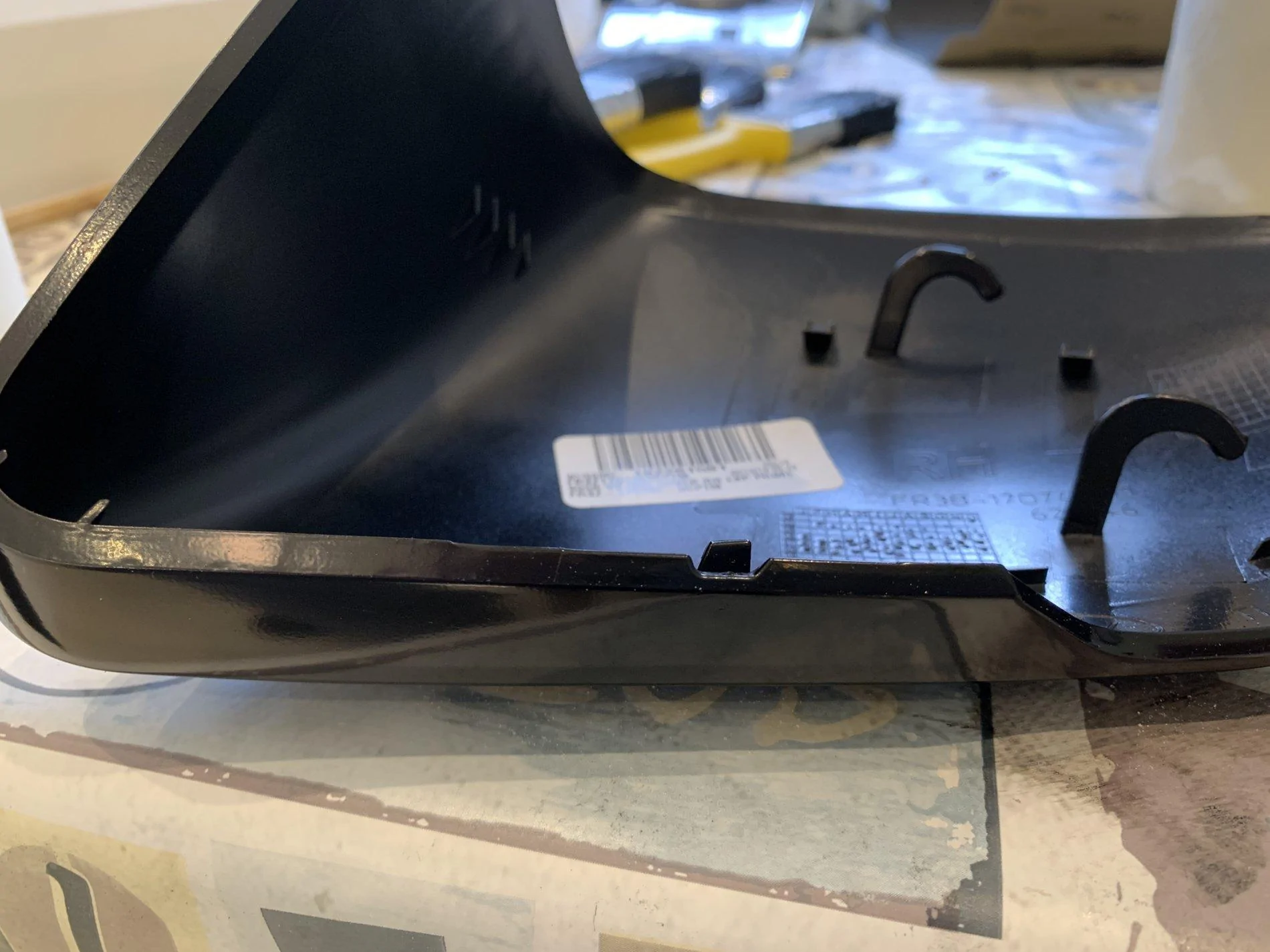

Only bits that let it down are the underneath edge, I know it’s there albeit you’ll never see it. It’s just not quite perfect.
See here
Not the oem covers come with a notch at the bottom already it’s just not as precise as it could be see below for notch

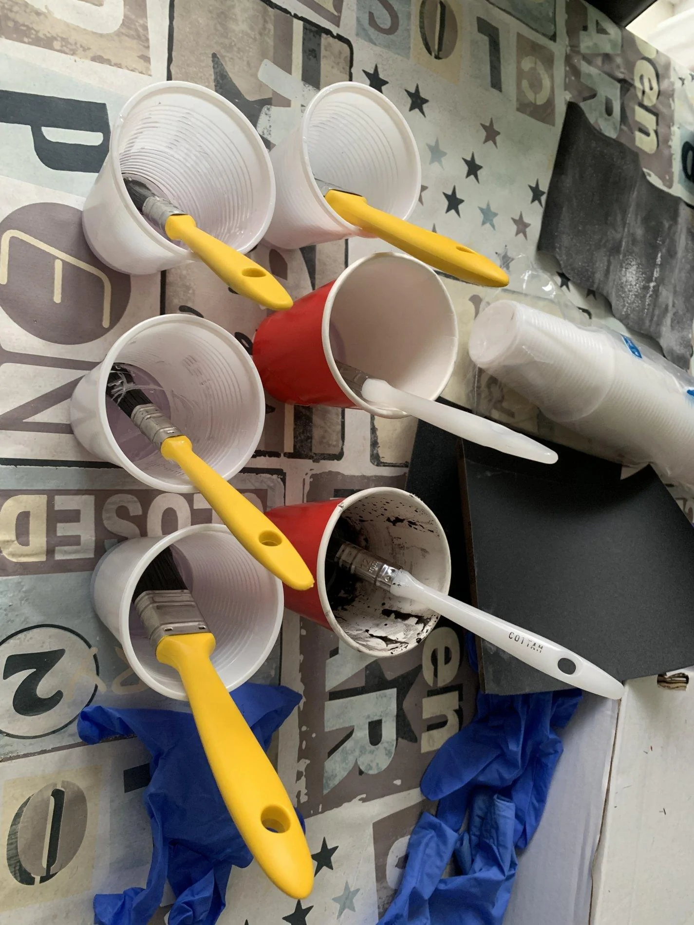

The kit comes with two cups and two brushes but I can’t see how you can do this with only two of each.
The resin goes off after a few hours and is rock solid and I mean super hard ! I’ve used 6 brushes and 6 cups for my first attempt. Even when doing the three consecutive coats after the two hour wait the cup and brush are set solid ! :facepalm:

P.s if you want to get the brushes out of resin, heat the resin up, then sit it in olive oil to loosen the bristles then hit it with some acetone/turp/ipa (girlfriend does resin art, and the stuff they use in carbon/fibreglass is the same shit)
