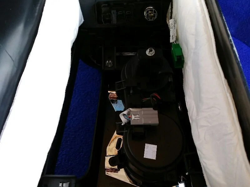

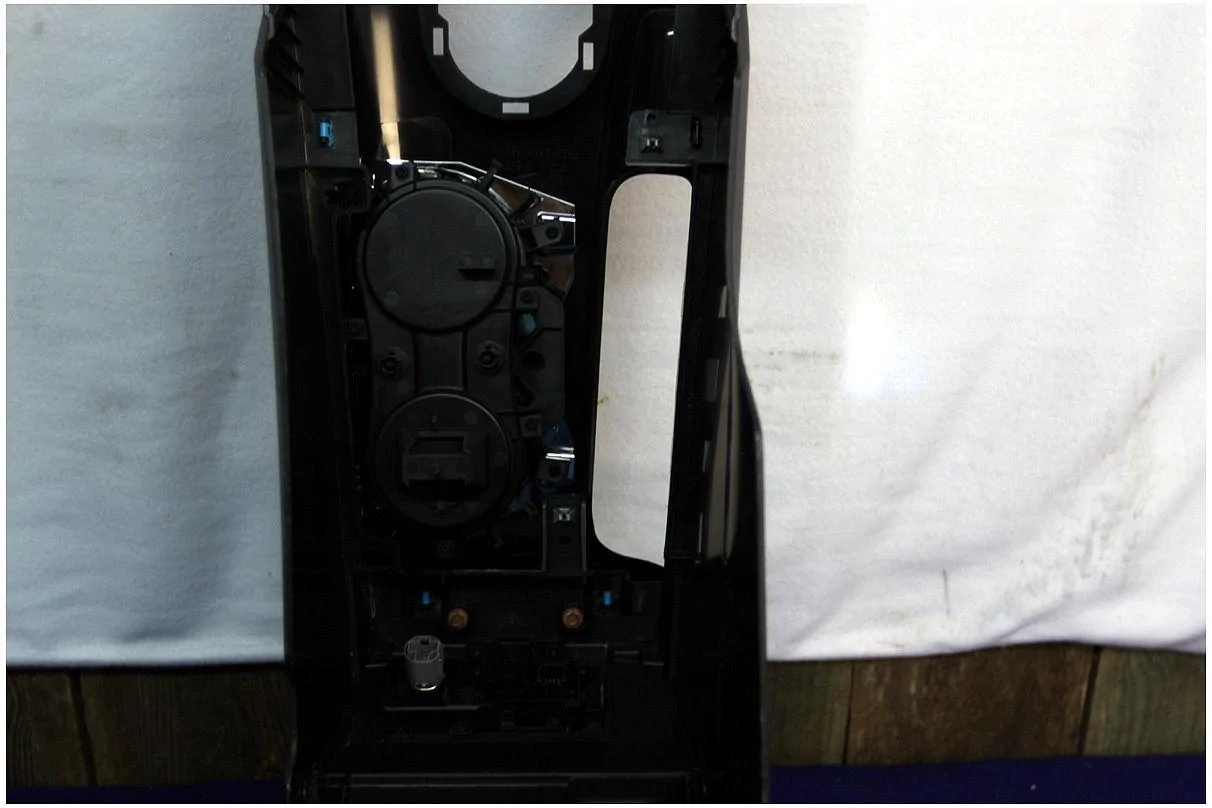

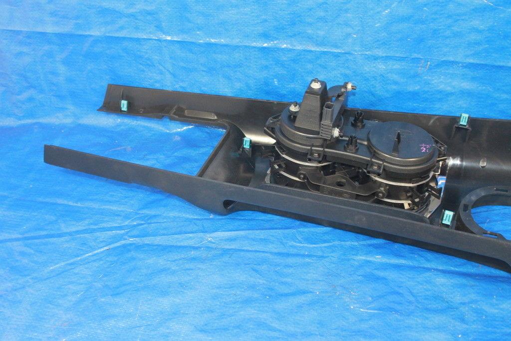

Mustang
i had a question about the illuminated cup holders and was wondering if they changed for 2017? I was going to pick some up off of ebay but noticed a 3rd different looking one and was wondering if you guys could enlighten me. The first pic is the one that is puzzling me. The 2nd is the standard non-illuminated and the 3rd is what I'm seeing out there for the illuminated/lighted version.
