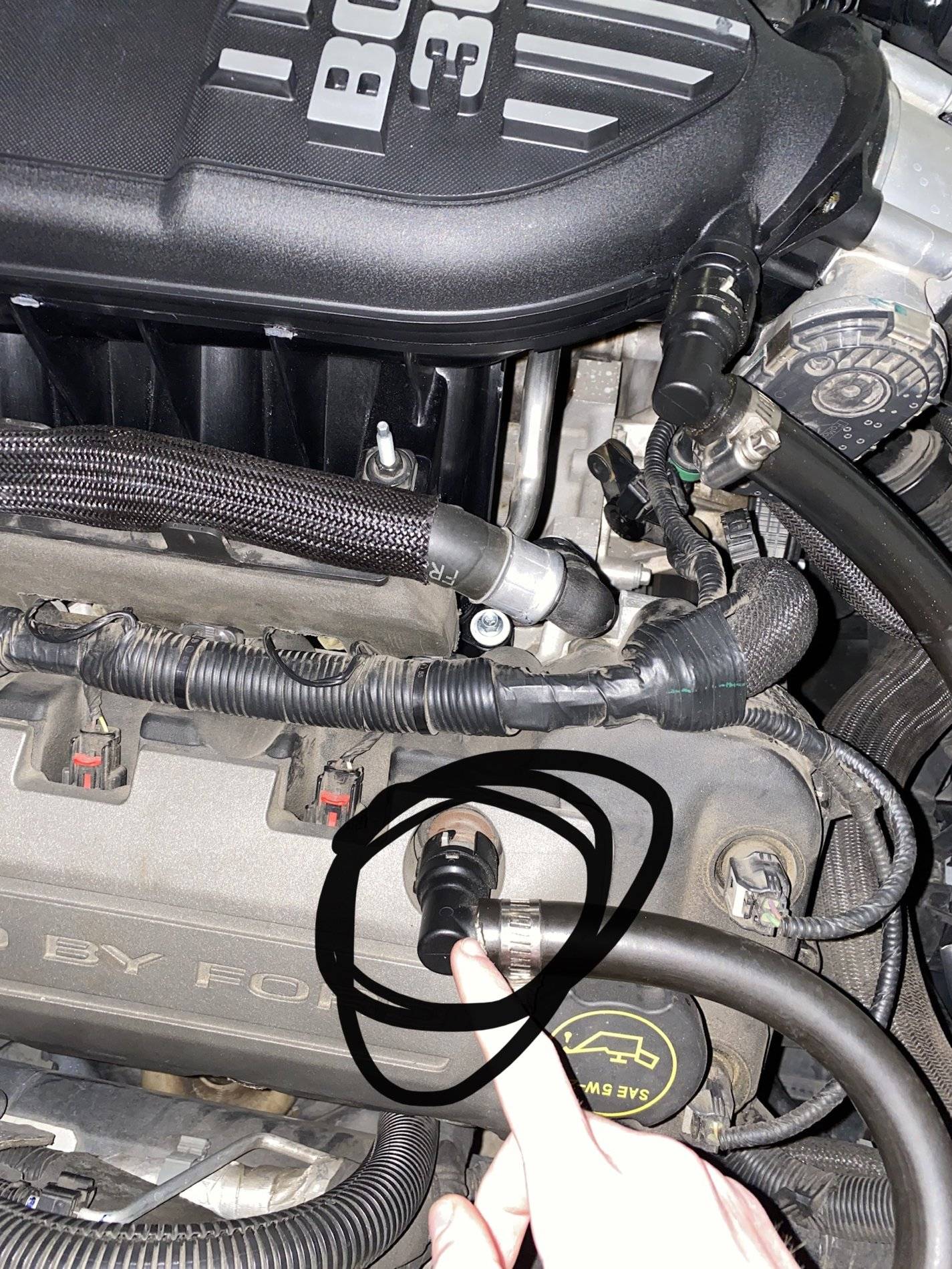

Turns out noise is coming from this, originally thought it was coming from the coil pack plug. Can feel it vibrate whenever the noise is happening.

What you have your finger on is technically a pcv valve. It is designed to let gasses in your crankcase escape so that they dont pressurize below the piston. The tube should run to your air intake so that the gasses are used in the combustion chamber (epa shit). On older vehicles the crankcase was just vented to atmosphere. The pcv valve has a check valve design and Im wondering if it may be faulty causing your noises

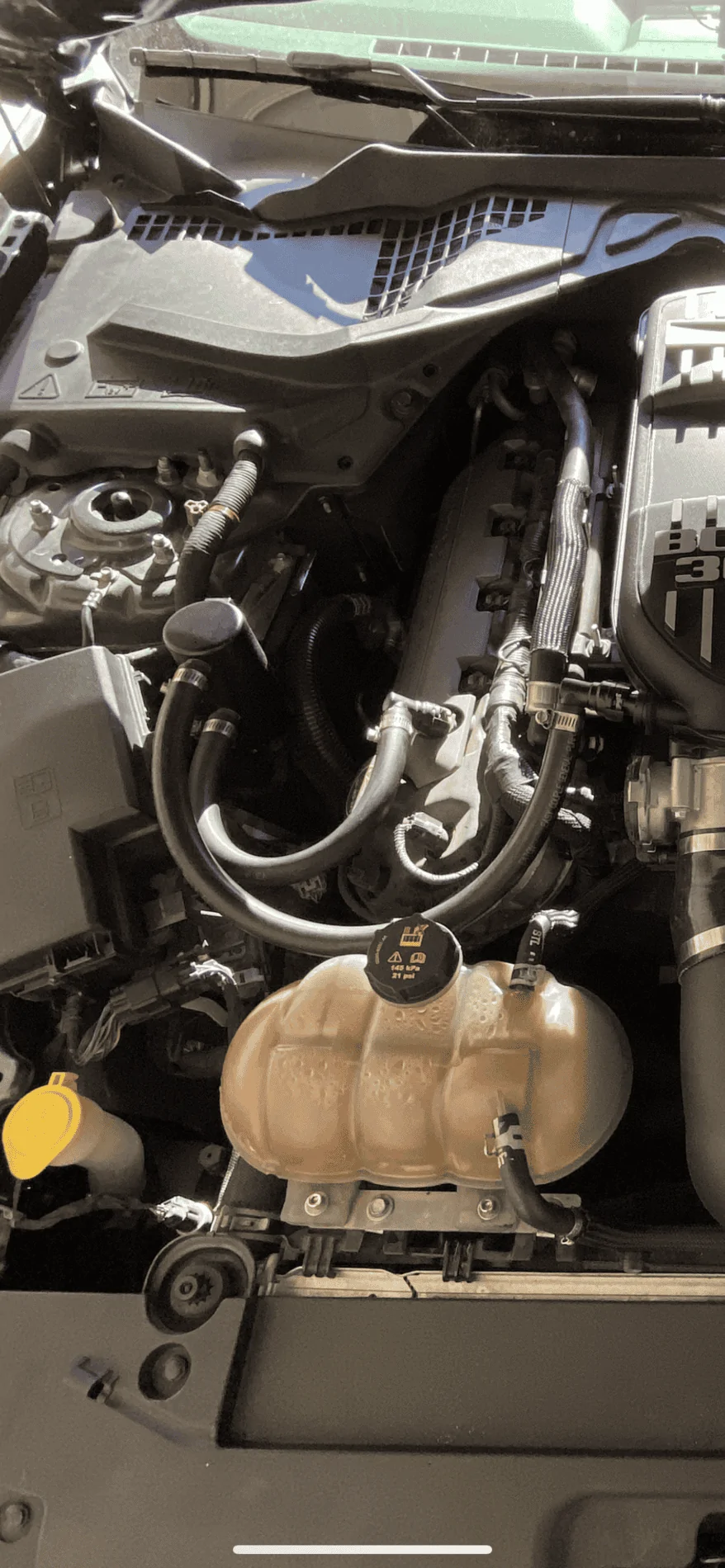

This is the setup for it, the noise appeared post tune from lund. I finally figured out it was that valve whenever I was trying to feel for the noise and noticed the pcv valve was vibrating when the noise occurred. Thanks for the info! Hope this picture helps
