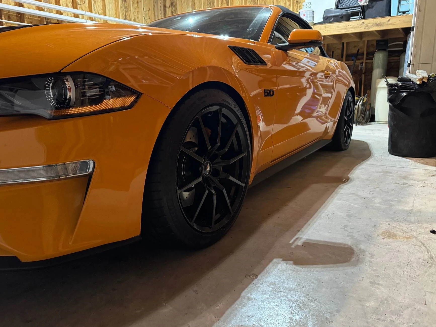

I’ve got a 2019 convertible GT. It had the black accent package with the black rims. I think the previous owner must’ve messed them up but he replaced them with some niche 19 x 8.5 rims. With a +35 mm offset. It has 255/40 19’s all around. Is there any advantages to the set up versus OEM? And if not… What would an ideal size and set up the four the car in preparation for a supercharge kit?
I hate the security software at my office. The page reloads more often than it will take an input, so I have to copy and paste this…
Maybe you should keep the tires while you’re checking stuff out and getting used to the car. Once they wear out, then it’s time to go shopping.
I think a stock, super-basic GT came with 255mm tires.
My GT-PP1 came with 255s on the front, on 19x9 wheels.
I have 275s on the rear, and my car can spin the rear tires and fishtail in 2nd gear, at part throttle.
Between that and your mention of forced induction, I’m adding one more vote for 305mm tires on the rear, with 19x11 wheels.
Whether you want summer tires or all-season, shop around and look at the traction and treadwear ratings.
Also, those brakes are silly. I can’t think what racing series even uses cross-drilled rotors anymore. Not Nascar, not F1, and certainly not endurance racing like Le Mans. In my 20+ years of autocross and however many track days, I’ve never heard any praise for cheese grater brakes.
When they crack or wear out or whatever, replace them with regular vented rotors.
Considering the previous owner did all that for looks…
If you haven’t checked the alignment, you should. If the PO ever even got an alignment, I bet it has practically zero camber.
so a dual 19x10 would be better since its same size…? I’m assuming the offset would be the same on both then…? Like a +35?
I wouldn't assume that about the offset.
There’s a way to use the same size tires, front and rear, but I think the front wheels need a spacer.
...Then you need to read a thread about spacers and see what kinds are safe and what kind is crap.

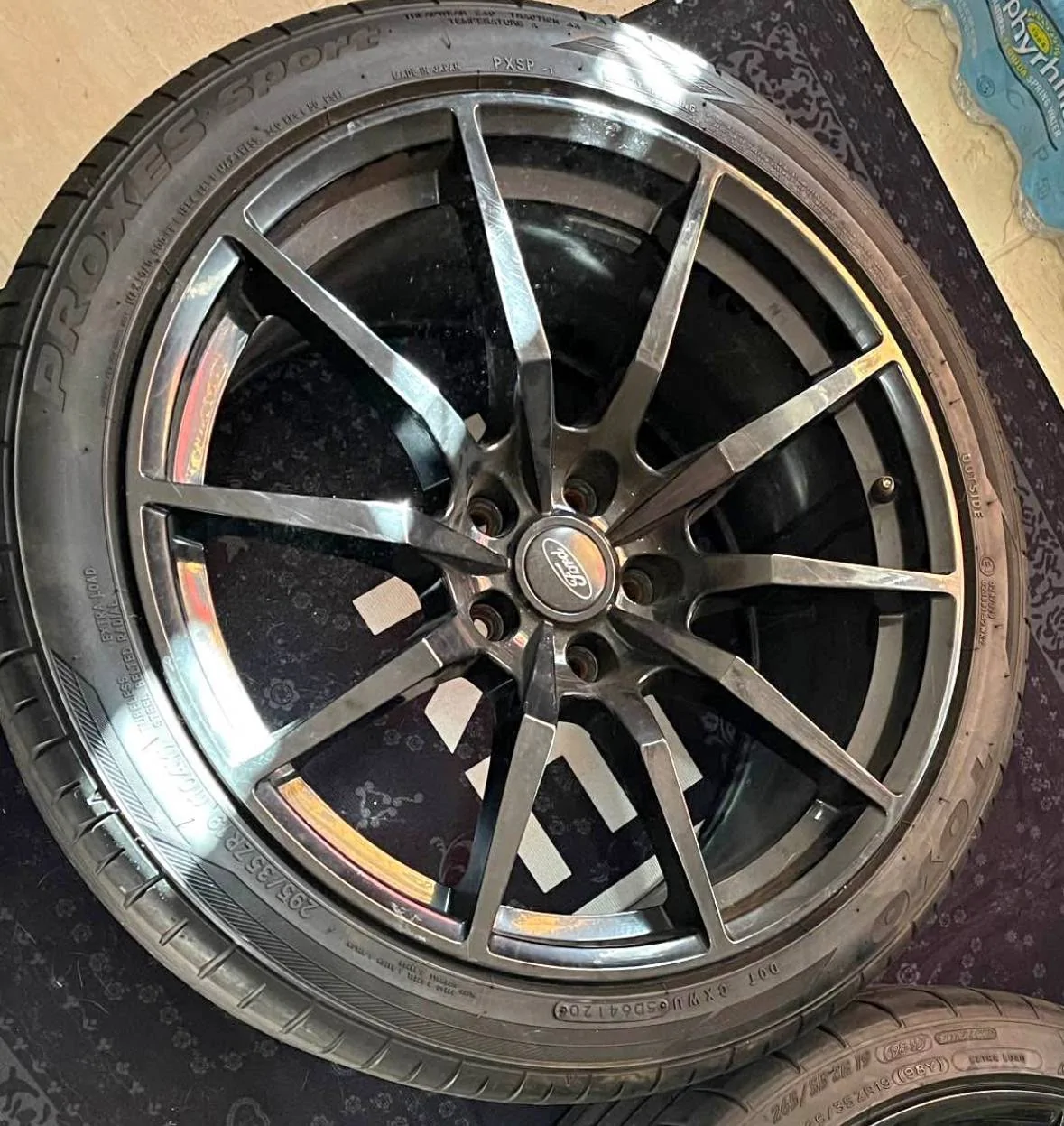

I found some GT350 wheels (10”/11”) with Michelin PSS 295/305 set up. I just need to make the 3 hour drive to get them.
Perna00
Perna00
Sep 11, 2024
42
155
86
Midway, Ga
Jacob
2019 GT converible
Got em’! Installed the Koni’s and Steeda strings also.
