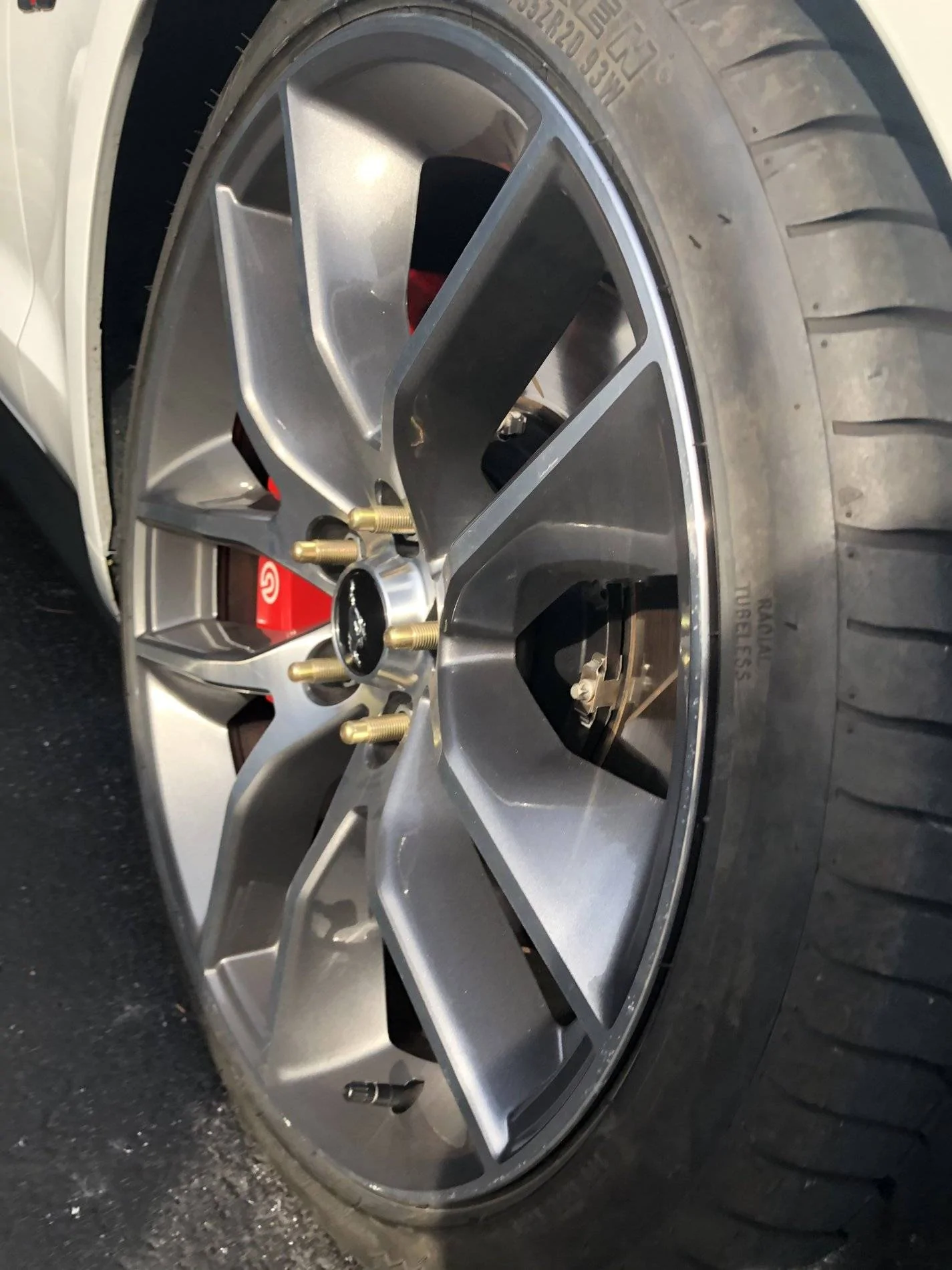

I just put some bearings with 3” studs on my car. My plan is to run a 20mm, maybe a 25mm depending. I could’ve gone with longer studs but I just used the 1:1 method. I have the stock wheels on for winter (with no spacers) and there’s a ton of thread left

What's the 1:1 method? Is that reference to increasing stud length equal to the thickness of the spacer? If you run a 25mm spacer with these 3" studs, are you still going to be forced to run an open lugnut?
No you shouldn't have to run open lugs with 1" spacers and the ARP 3.435” studs (100-7733). I ended up running open lugs anyway (stock width Ford Performance open ended lugs), but it shouldn't be required as long as the spacer is installed.

I only went with the open end lug nuts because the factory lug nuts deform. I’m always taking the wheels on/off my car so it didn’t take long for them to become damaged. And I have a badass impact gun that I like to use so that didn’t help the longevity of them either
