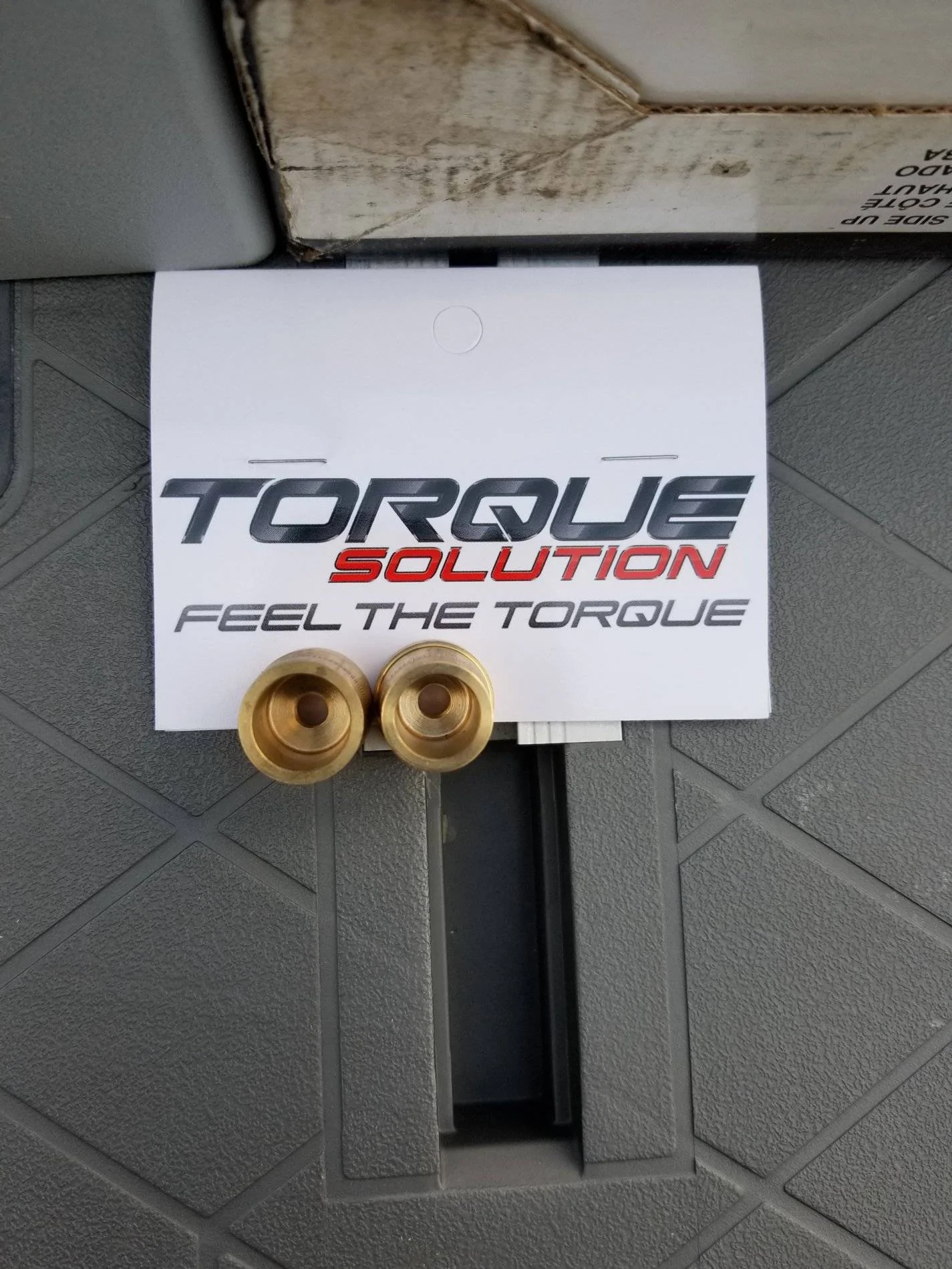

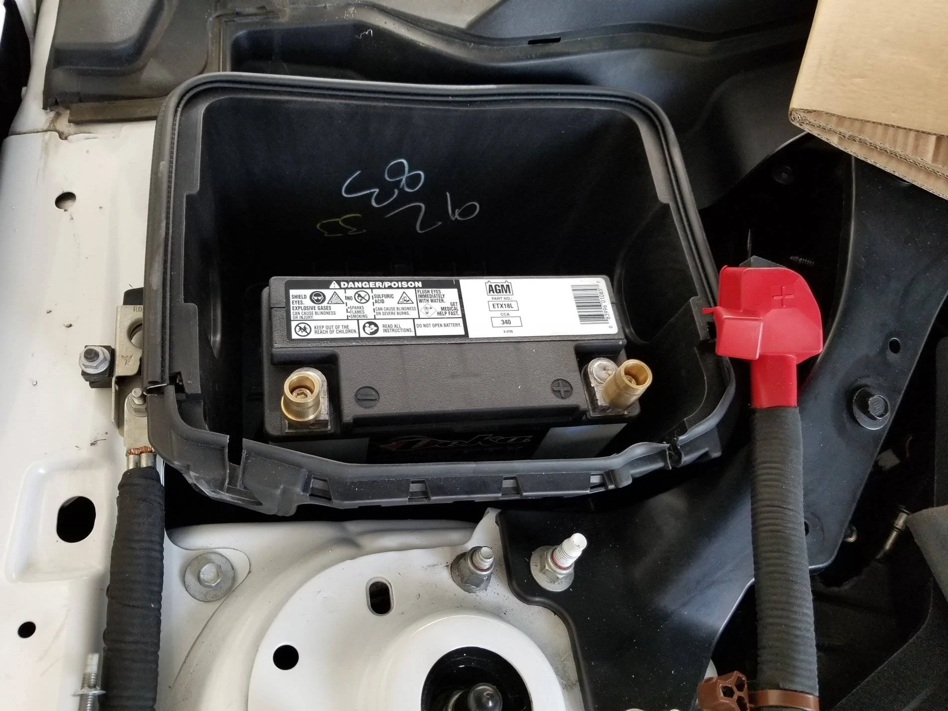

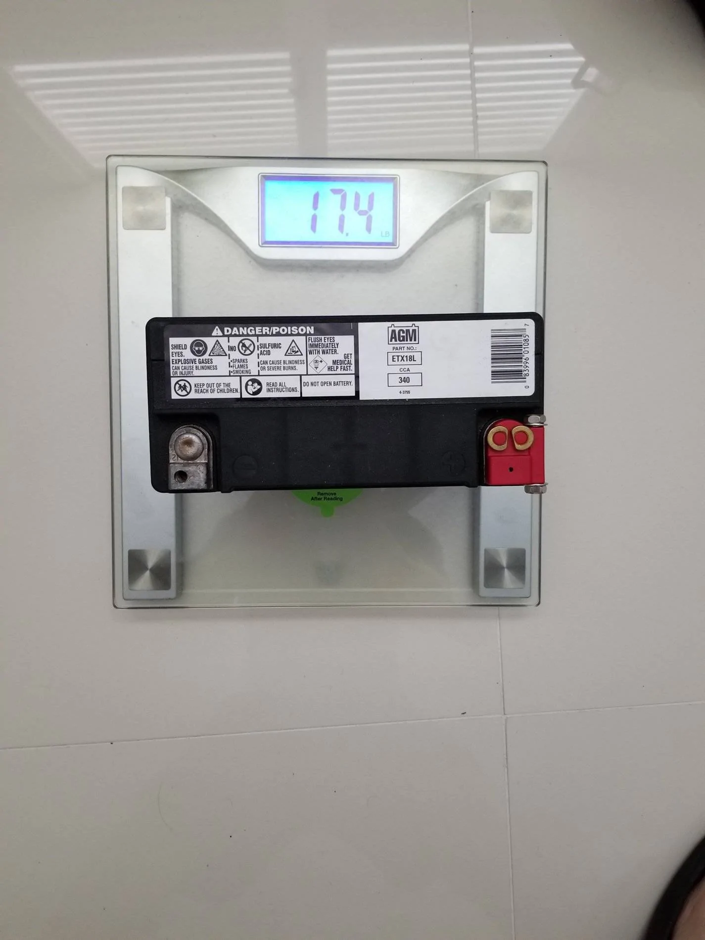

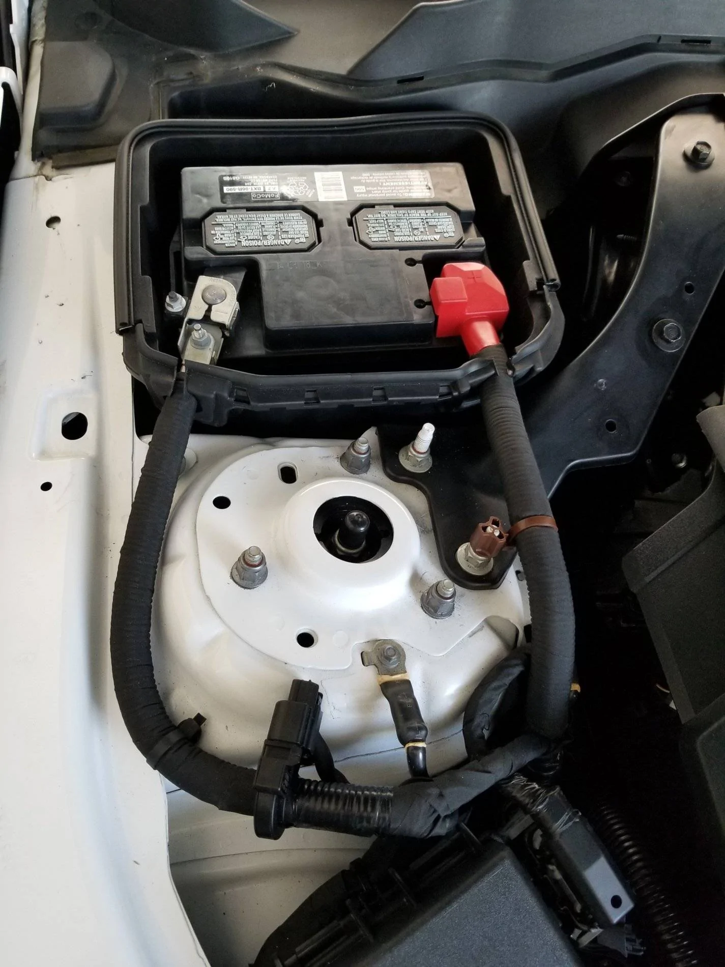

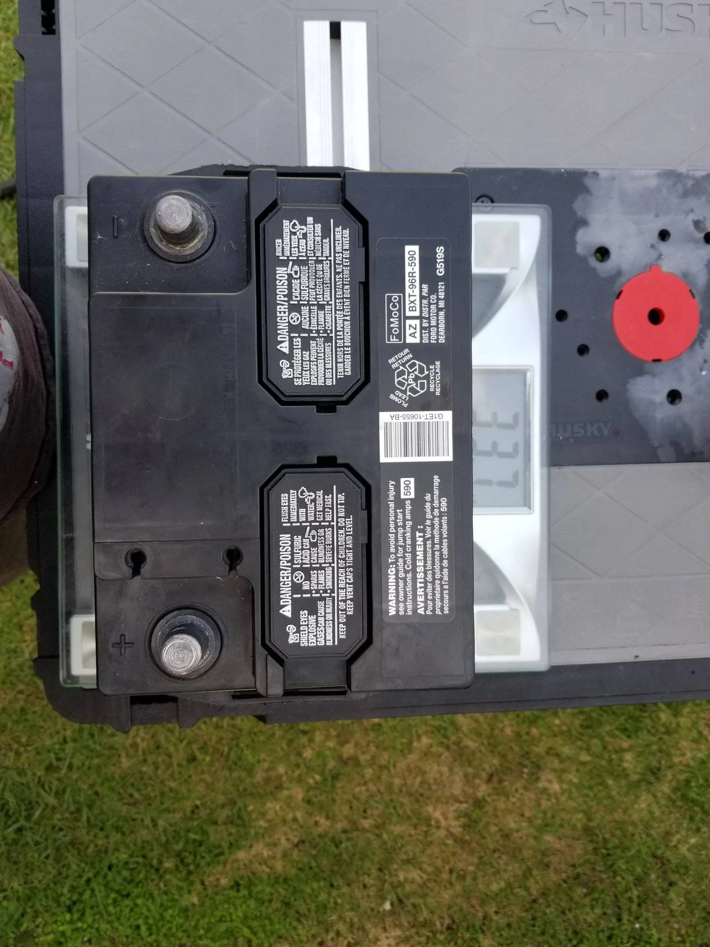

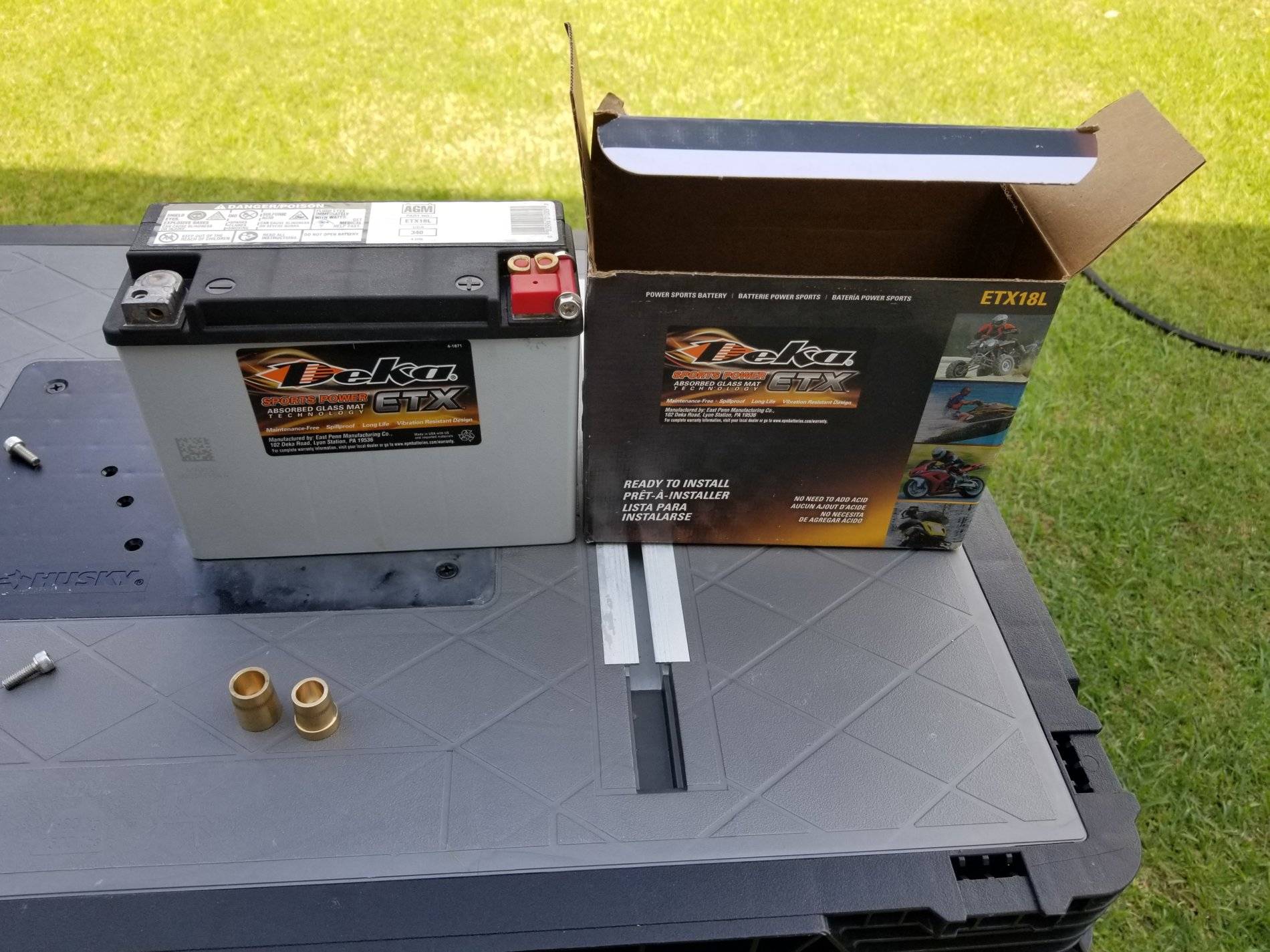

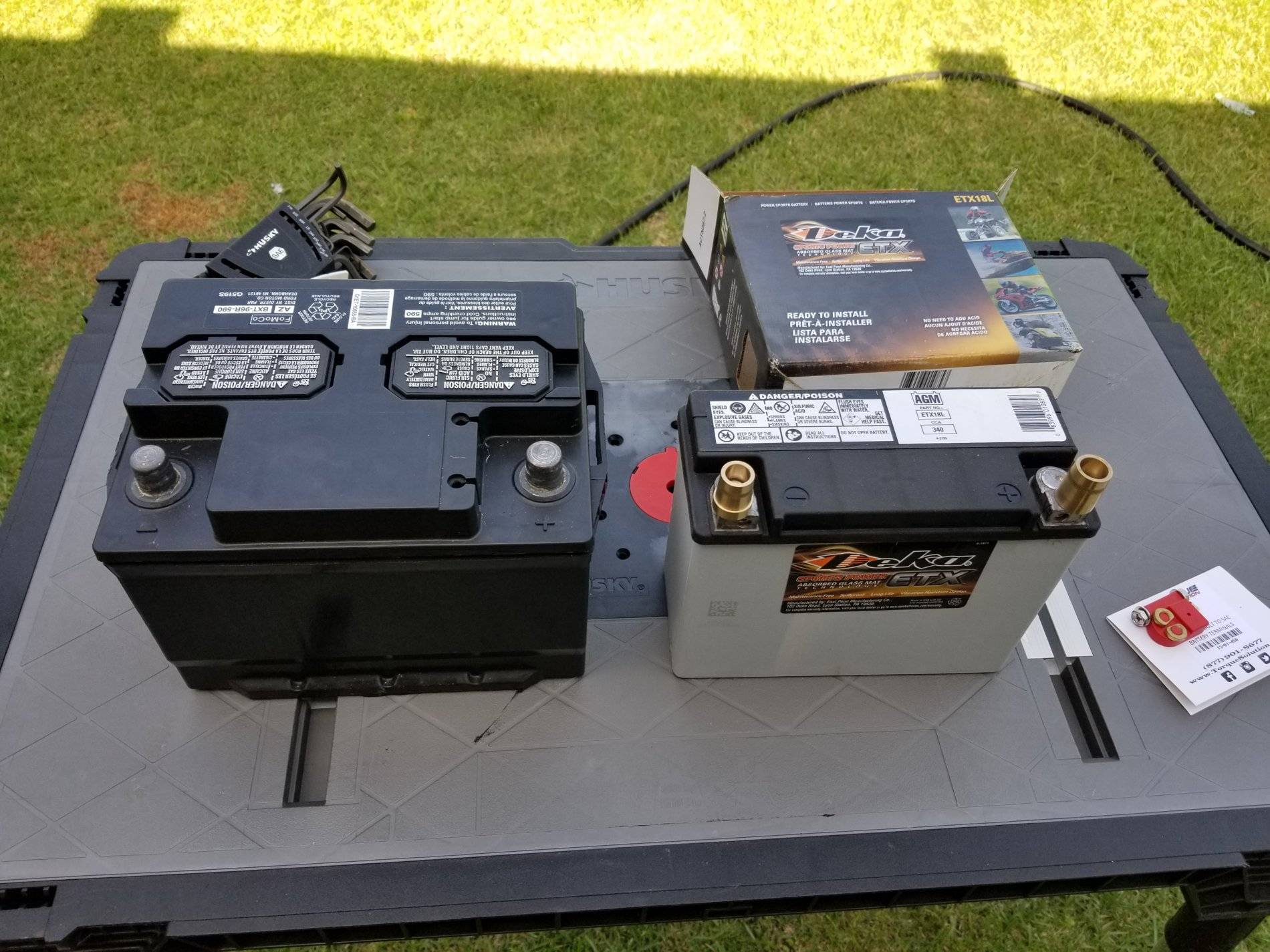

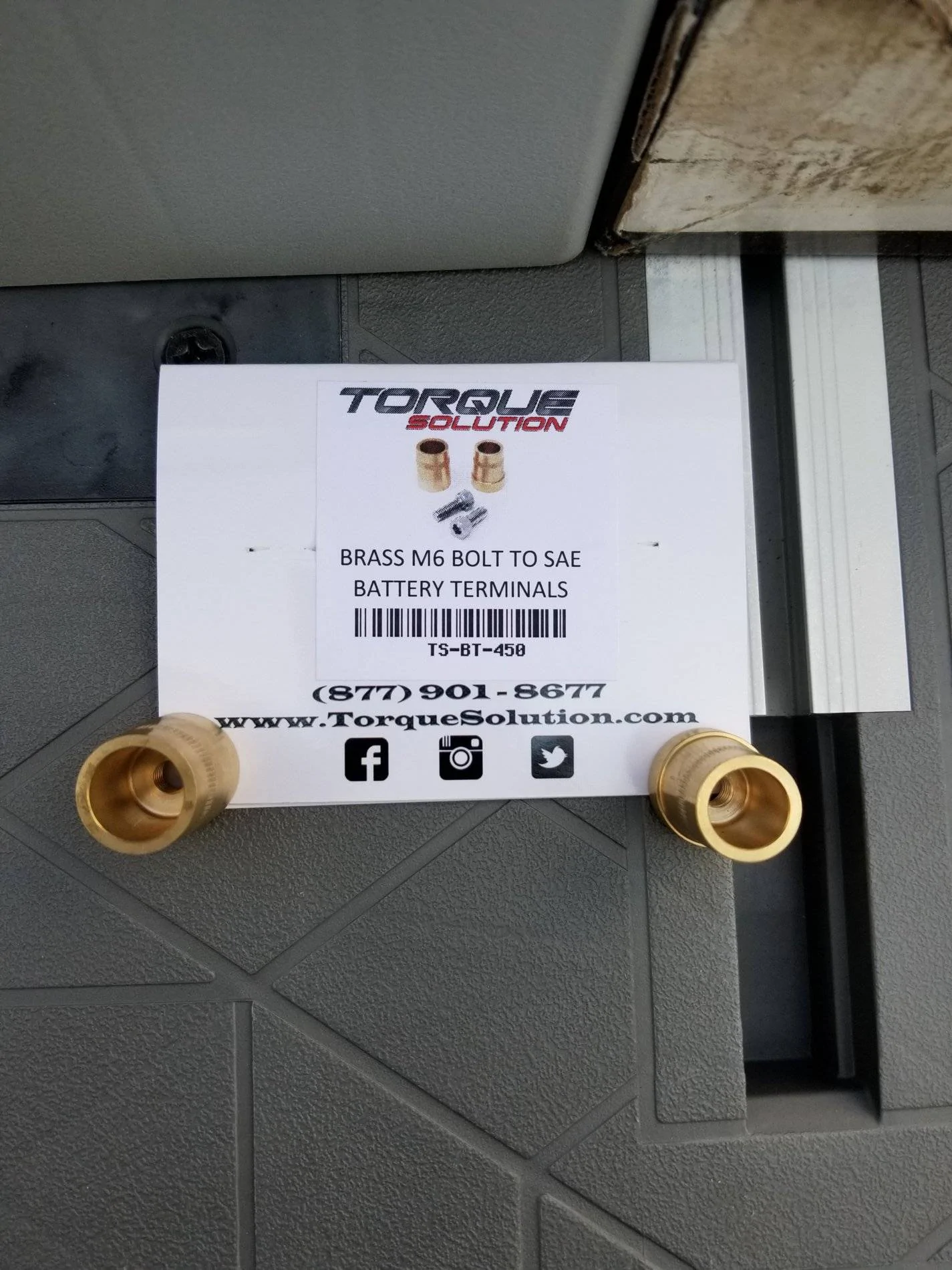

Installing my Deka ETX-18L for some weight reduction to my Hellion Twin turbo Mustang 2018. The gains are between 15 to 16 pound less. I change some stuff for reduce the weight of the turbo kit.

How'd you secure it in the box?
gstboy69
Feb 3, 2019
240
52
P.R.
Tony
5.0 2018
I fabricated a a small piece of wood for the space under the battery 3 3/4 x 6 3/4 for create a flat superface. Then I connected the cables to the poles (when you connected the poles the baterry are very firm). Finally use the plastic piece that came from the oem security tab a put in the back of the battery and finish very firm.
