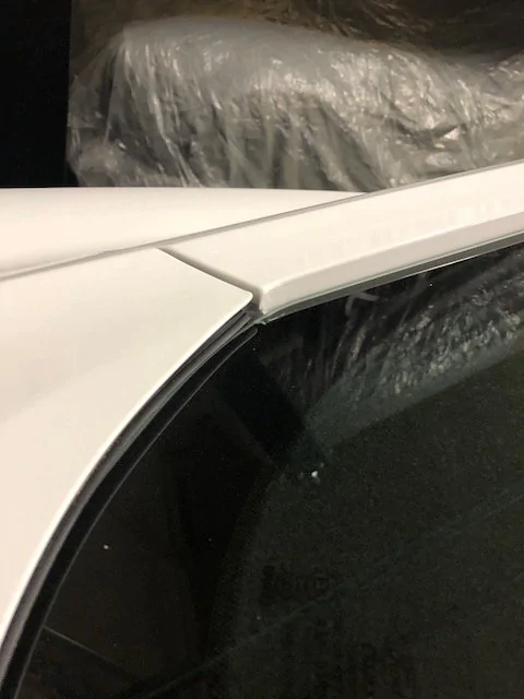

Anyone else have a decklid out of alignment this bad? I see what appears to be bump stop adjustment, but it appears it would raise the lid in the middle rather than the corner where the deck meets the quarter.

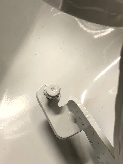

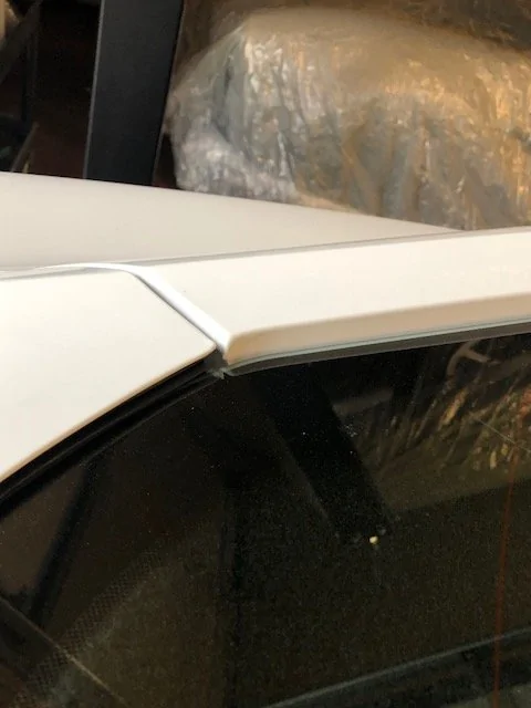

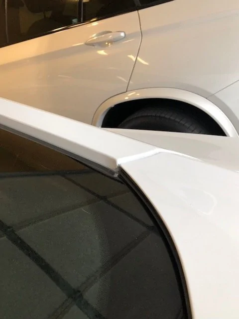

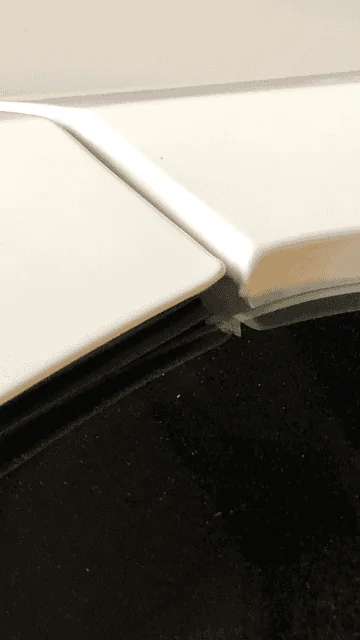

Pretty easy fix. I just adjusted the bump stops up. Here are before and after pics.
