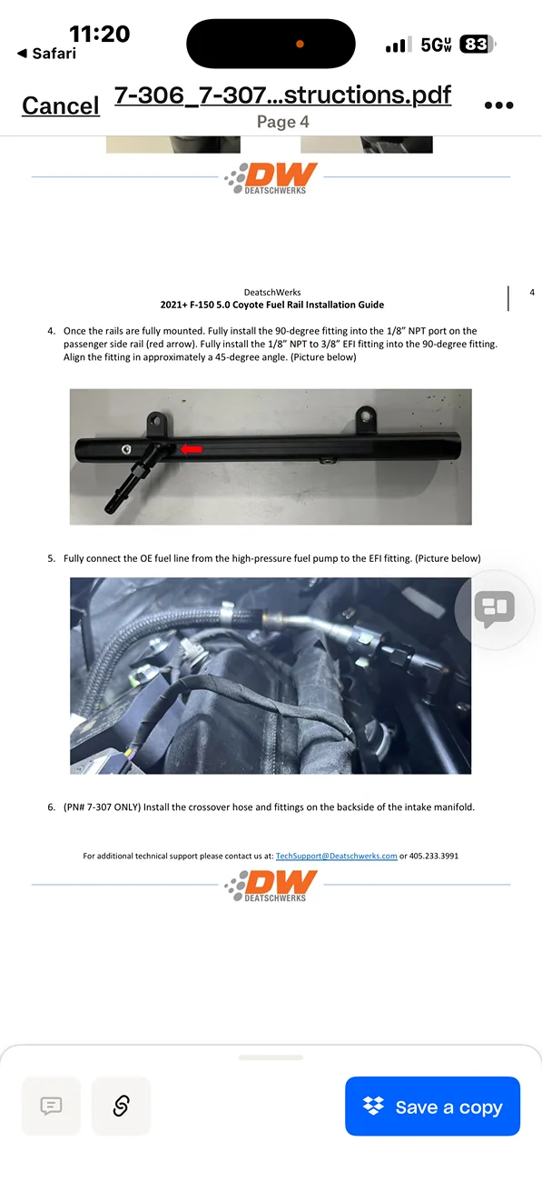

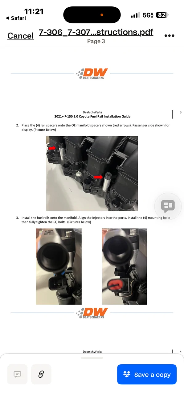

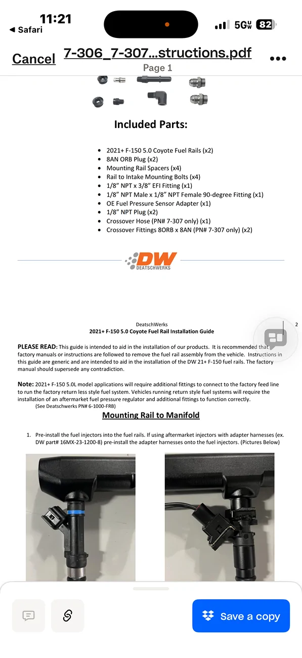

ok, so I have seen that and that kit is nothing like the one I have, thats for 2021+ models. I have a 2017 and it did not come with all of those parts. The injectors don't clip in, I do not have a 90° angled piece that the adapter connects to from the rail, no spaces for where the rails bolt in. Definitely not the same and not so easy.

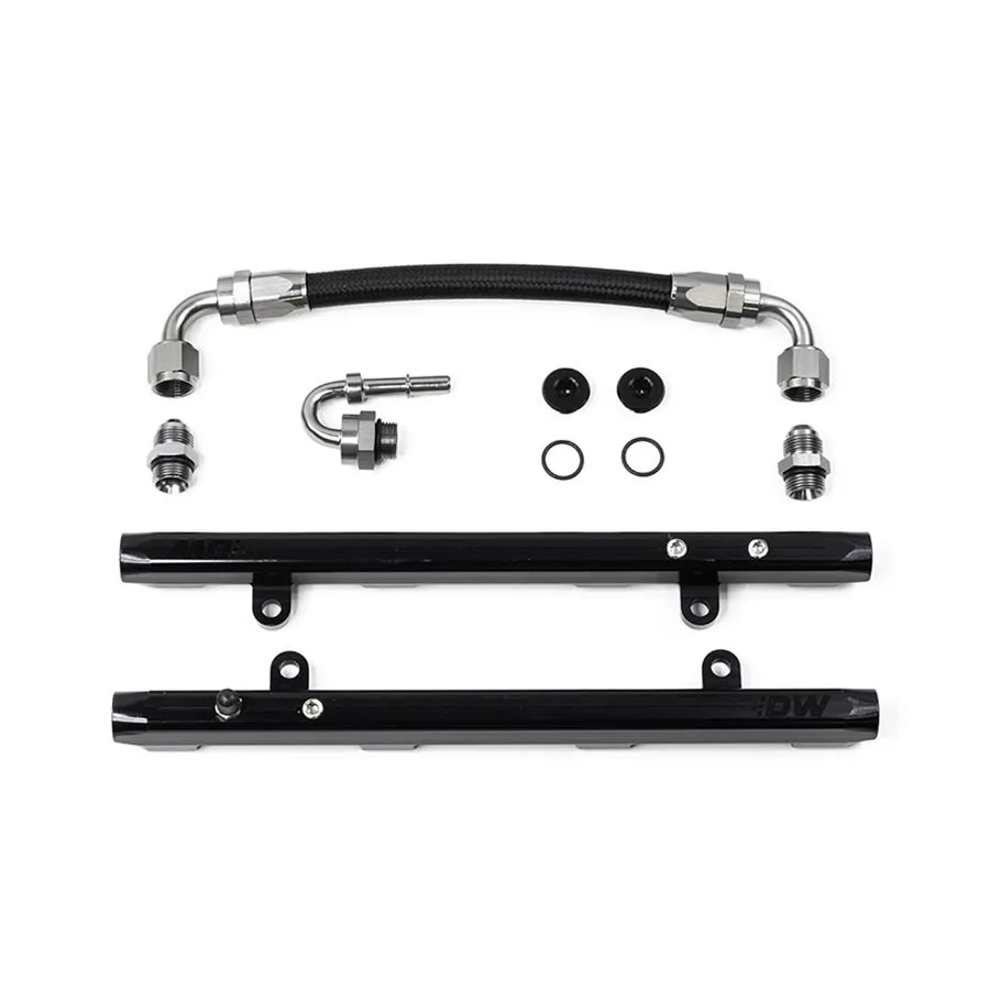

Is that it?
MSTORMIN919
MSTORMIN919
Mar 21, 2023
Fort Worth
Markus
2017 Mustang GT

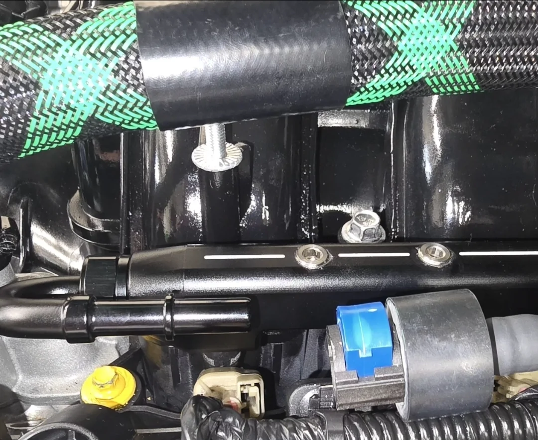

It is and before you say the 180° fitting is what I connect my fuel line to, its about 2" too short

Thanks, do you know where I can find that barbed 3/8" piece?
