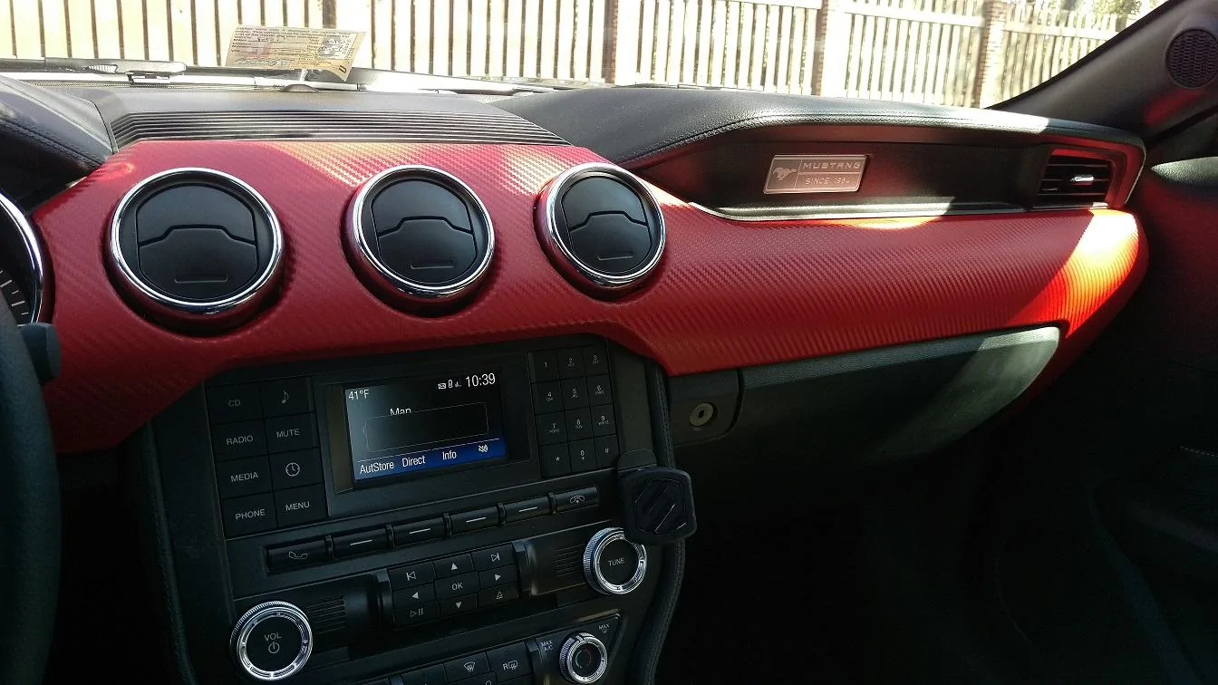

You're a lifesaver. I thought there was something stopping me from pulling it off.
Here is the finished product.

No problem at all. looks great by the way! I'm going to have mine hydro dipped.

Thanks! I thought about doing that, but really like the realistic look of this wrap. Plus...I already had a 6' x 4' roll of it from when I was going to do the hood of my previous car. Didn't want it to go to waste :)
