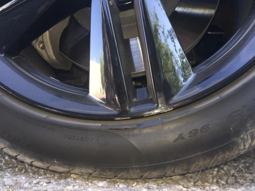

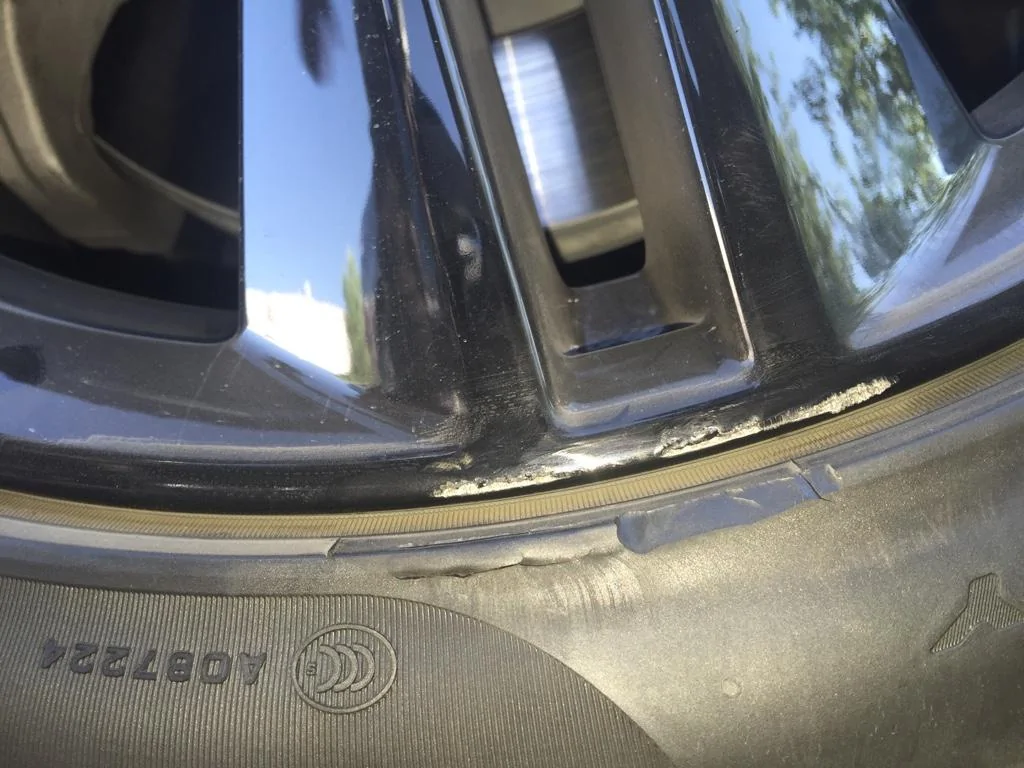

I hit a curb and lightly damaged my wheel, i want to know if any of you guys know how I could fix this.

I hit a curb got mine redone right around $190 Hub Cap Heaven Nashville, sorry that happened.

Polish high spots down and then use filler (AKA: Bondo) to fill the scratches and then spot paint that area. Either airbrush or brush touch.

I agree, it's just paint. Do it yourself for about $20-30 instead of paying someone 10 times that. All they're going to do it remove the tire and repaint the whole wheel; you cant just cover the rest and paint the small area scuffed after prepping it and hit it with a bit of gloss. The smaller area you paint the more you will not see it.

Your tire has damage and should be replaced. Same thing happened to me and the tire had to be replaced.

:cool:Replace the tire...............There are many shops that will fix that wheel. Prices of repair and quality of mend, vary alot.

I used Black Nail Polish, works well and has held up nicely.

I did the same thing on mine. went to auto zone picked up some touch-up paint. cleaned the spot & painted. I know its there, but to see it, you have to look for it
