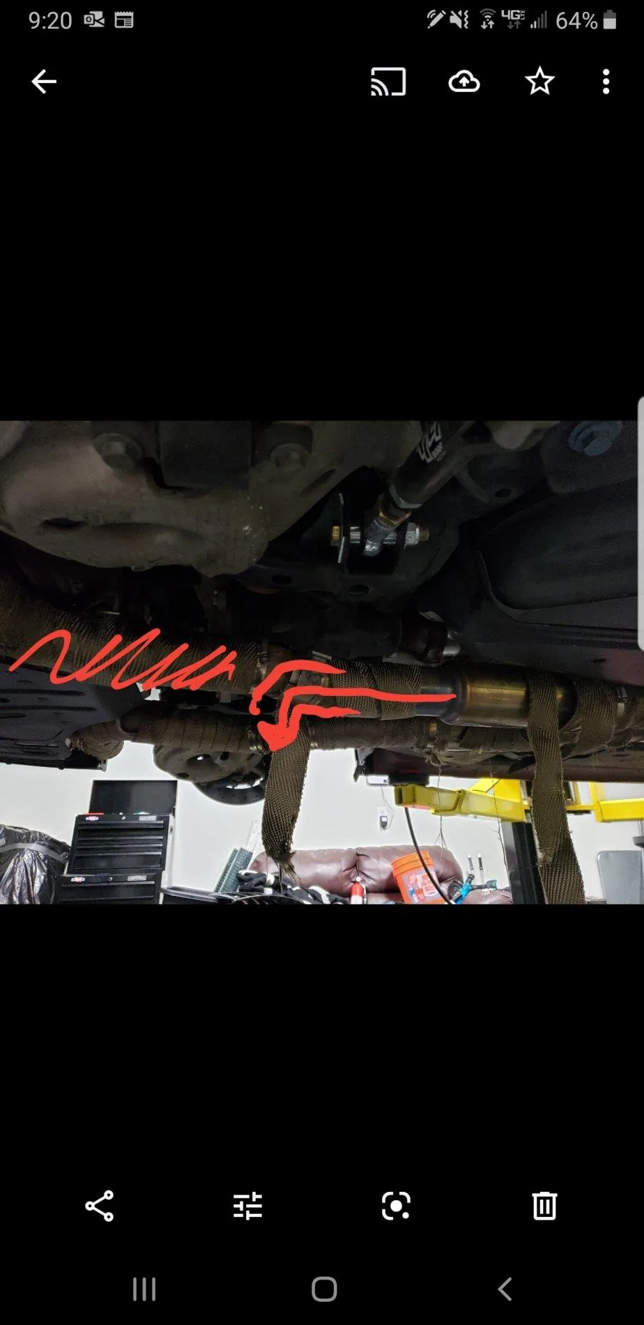

Back from the trip to VIR and Road Atlanta where I was on track with mostly purpose built race cars and one thing became evident - I need more slippery aero and serious weight loss.
Looking at the rear end, I'd really like to put an aggressive diffuser on. This also opens up the opportunity to reduce the weight of the mufflers.
Couple of questions:
  1. The "loud" pipe is essentially a straight pipe through the muffler, correct? In other words, when in sport mode the mufflers aren't really muffling, are they?
  2. Thoughts on coming out of my resonators and just shooting the exhaust down towards the ground?(completely removing the mufflers)
  3. Will this cause unacceptable heat under the car?
The ultimate plan is to side exit exhaust, but I want to wait until I can route it where the fuel tank is, which will require a fuel cell. Not ready for that yet.
Pic for reference (ignore the messed up wrap, made contact with kerb when I went off track).

All of the above. It will be louder, hotter and smellier. There might be some unforeseen aero effects. I noticed that Fathouse Fab does custom titanium work... I’ve been seriously considering going that direction in the off-season. Titanium from the exhaust manifold back and ditching the active mufflers.

I run a Kooks setup, with their O/R Xpipe and through the OEM mufflers. I have no resonators.
I guess your trying to lose weight out back, perhaps you can go with the one company that makes the cats delete pipe from the OEM headers back to the X, cut the resonators, and pick up a flow through pipe out back. A little more than doing a dump as you suggested, but should keep the heat in check. It would be loud though.

If you do dumps right before the axle I doubt there will be heat issues as it sits there because the exhaust is dissipating and the thermal energy is getting distributed into the atmosphere with the exhaust gases unlike pipes that are just cooking shit underneath the car like a space heater. Then one thing I'd wonder about though is if you dump in front of the axle, is the exiting hot exhaust going to shoot up into your diff cooler...
Planning on running the FP350S diff cooing setup, so I don't *think* i'd have a problem. But don't for sure.
