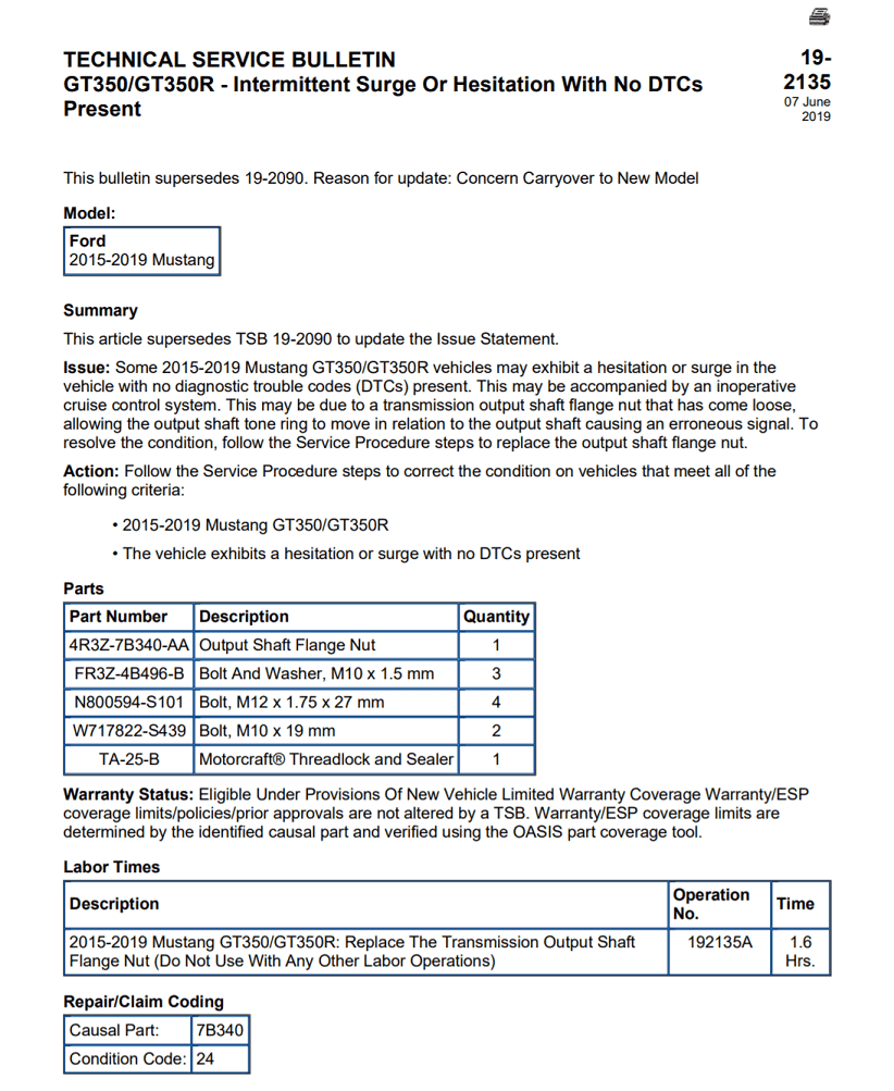

I was driving 4 hours home from Pitt Race last weekend, empty tank, filled up 93 octane and within 5 minutes the car started surging while getting back on highway. It did this in all gears. It was a bit intermittent and I figured bad gas, so kept driving.
on the highway, my cruise control would not engage, hitting the button would not turn the indicator green, and if it did activate, it dropped itself out right away. At a toll, I got the wrench icon that said “see owners manual” and also a message “hill assist disabled”. The surging was not all that bad and mostly subsided so I kept driving home, cruise would not work despite restarting car a few times.
I drained all the gas and filled the tank with fresh gas. It was running smooth and cruise worked again and I scanned codes with my reader that came up empty (wrench went away). However, 1/4 a tank into the new gas today, I tried setting the cruise on the highway and it activated then kept dropping off, and now won’t activate at all. No wrench, no codes, and it’s not surging, but once in maybe 5-10 miles I feel a little “kick” as if the engine misfired.
any thoughts before I take it to the dealer? I’m concerned this might be intermittent they won’t notice the kick/surge, but not sure why cruise is not working.
Edit: car has 6800 miles, seems to run perfect if driving aggressive. The kick I notice seems during going more easy. I noticed the engine just started drinking about 1qt or more of oil per 500 miles recently, never used to consume any but have put in 2qts in the last 6 weeks now.

Wow, now that is helpful!!! Thank you, will take it in and show them this.

They have to replace the tailshaft nut at the back of the transmission - they have to take the exhaust system and the driveshaft out to access the nut, but the nut itself is only a couple of minutes work.

Presume you mean just mid pipes, or do the mufflers also have to come out for some reason? I ask bc i just masterfully zip tied my new awe switchpatch valve remote system all up in there ;)
As far as I know, everything from the x-pipe slip joint back is one piece, so the whole thing including the mufflers has to come off to access the driveshaft flanges.

This tsb was done (thank you so much JAJ, I am sure it would have been a wild goose hunt otherwise) and I picked the car up today. Drove straight 3.5 hrs to mansfield OH with cruise working great and no surging. Will hopefully round out a successful season of 20 or so track day’s tomorrow with the last, and my first time at, Mid Ohio with 5x25 min or more sessions :).
if I don’t post any follow ups, presume this was indeed the culprit and the proper fix. The tech said the flange nut did feel “a bit loose”. It was not a small job, glad there was a TSB for sure!
