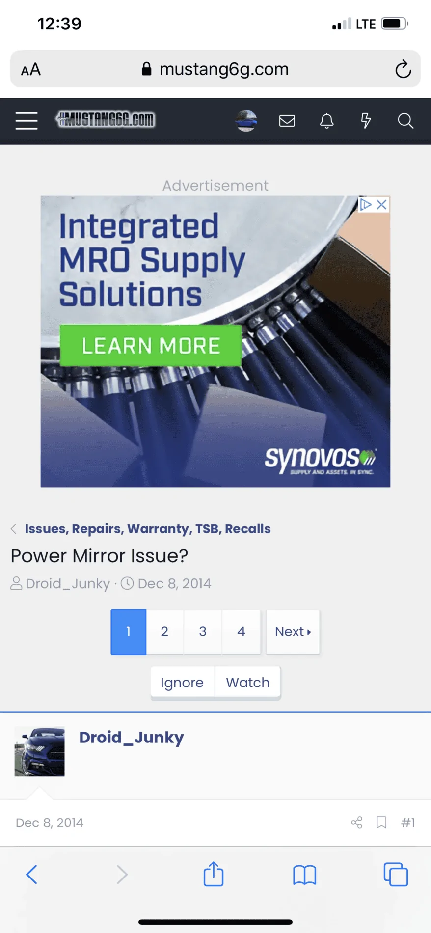

https://www.mustang6g.com/forums/showthread.php?t=13527. This is covered in the thread that I copied. I took mine in and they covered it under warranty. Hope this helps.
I was not able to open the thread. What did the Ford Dealer do to fix the problem?
Yeah, that link is corrupted man; it takes you to a crap site, not to the thread that is supposedly linked. So please tell us what exactly your dealer did to your car. Thx.

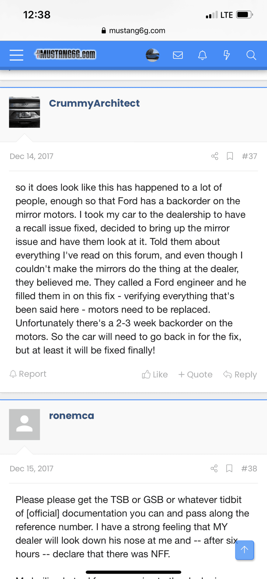

Well it fixed mine. Call ford and ask them if you seem to think this isn’t the problem there is a whole thread dedicated to this problem try using the search button

Well, they had to reset the door module after replacing the motor. That could have fixed it :). The 2015 and 2016 cars had known mirror motor issues. I don't think mine is, but it's always possible. All I know is there's no way I'd take my car to a dealer just for that:devil:. If a mirror acts up again, I'd reset the modules first. And if it happens again, I'd just live with it, since I rarely use the memory buttons anyway. And if the motor eventually craps out, I'd just replace it myself :). Glad your issue was fixed though.

SSM 49217 may offer some help - if vehicle is still under warranty (3/36), take it to Ford and tell them to review the SSM:

Good to know it's the software... although you'd think it takes less than 6 freaking years to find that out. Geez. Oh well. I reset the DDM and hasn't happened again. Any way to reprogram that module ourselves? Thx.
