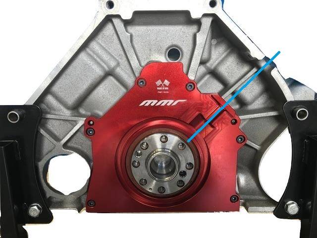

Double check you got the right sensor as ford changed it for 2018+.
Is the sensor just sticking up above the metal causing the bolt to not align properly with the hole?
The sensor has a gasket oring thing that meets with the rear cover to help prevent debris getting onto the crankshaft trigger wheel or the magnetic end of the sensor. The sensor just might need a little force pushing down.
If you are having trouble getting at it from the top you may be able to go under, pull the starter and see it that way.
Getting the sensor to seat is pretty easy, getting the connector on is what i would think to be the hard part. Remember the bottom part of the sensor is going into a hole on the rear cover so it can read the crankshaft trigger wheel.
Blue line represents how the sensor will go into the rear cover so it can read the crankshaft trigger wheel (not included in picture but would bolt right to the end of the crankshaft).
That's pretty much all I could think of. If you can get it out you can get it in.
