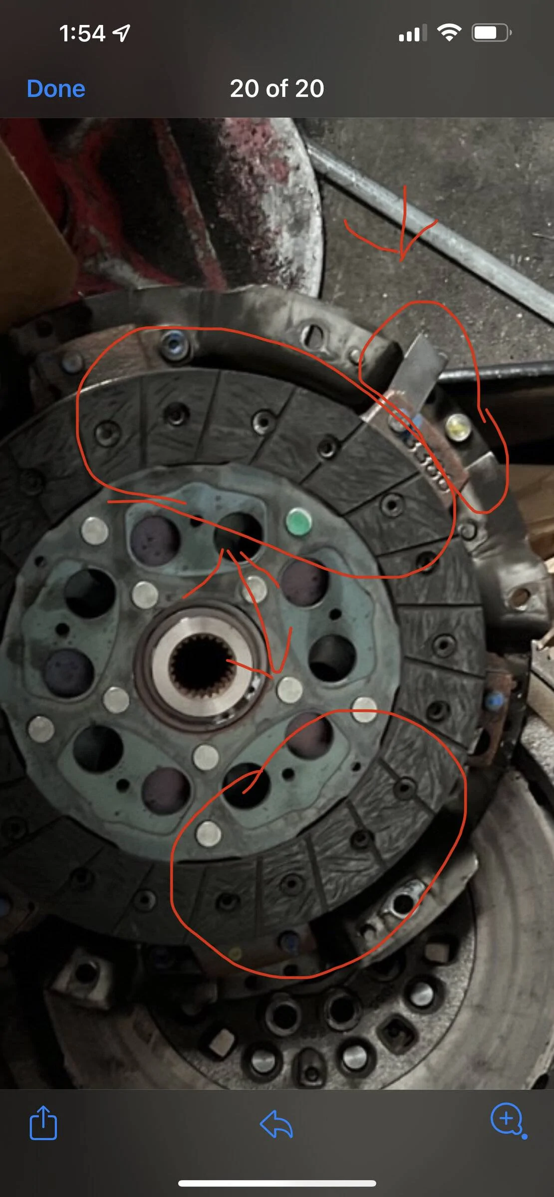

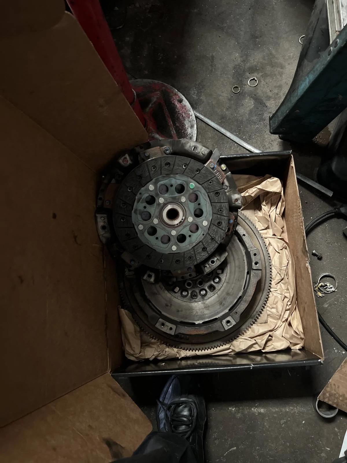

Sure enough it was the clutch/flywheel just added a few photos for anyone in the future having this issue
