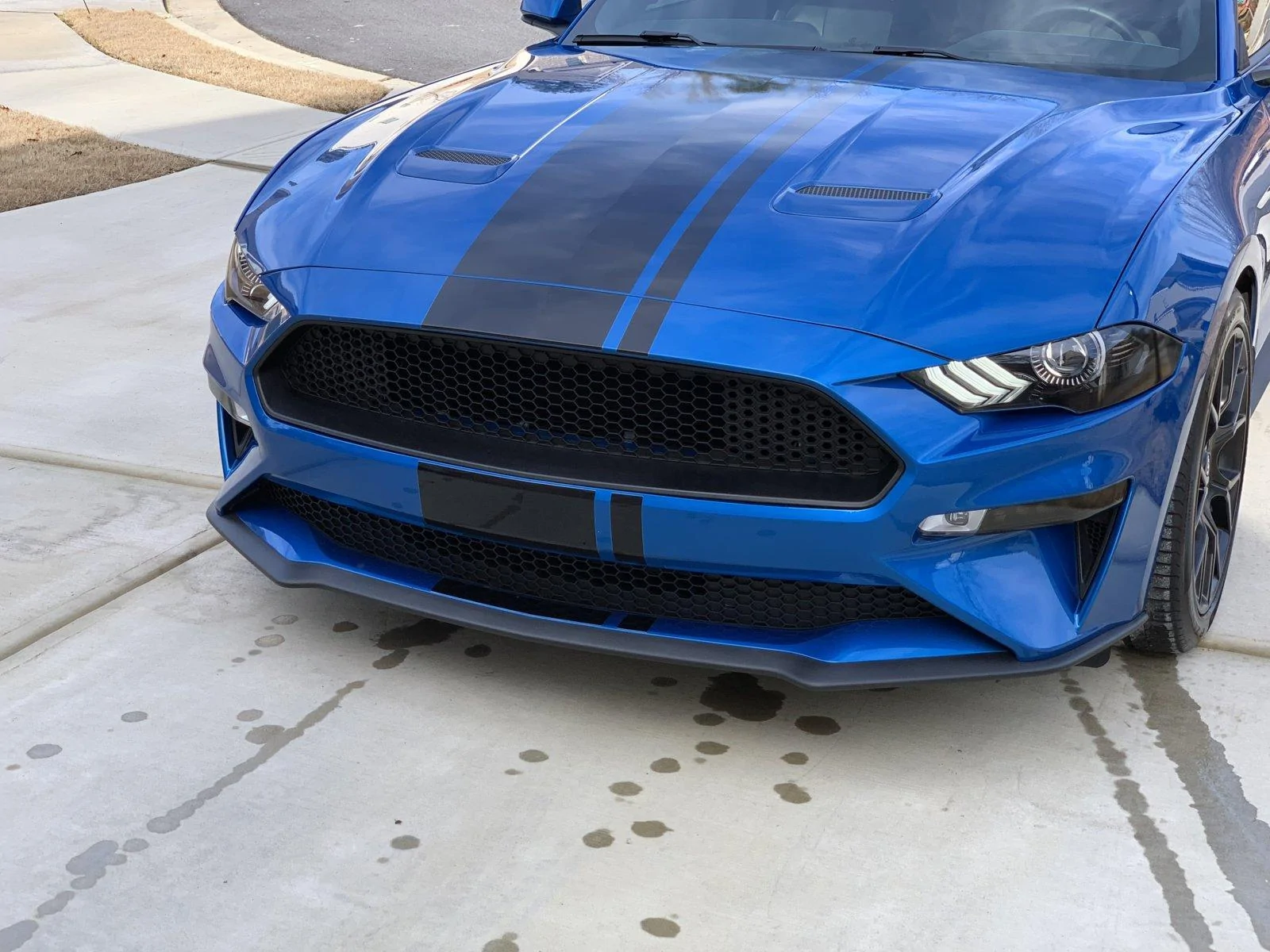

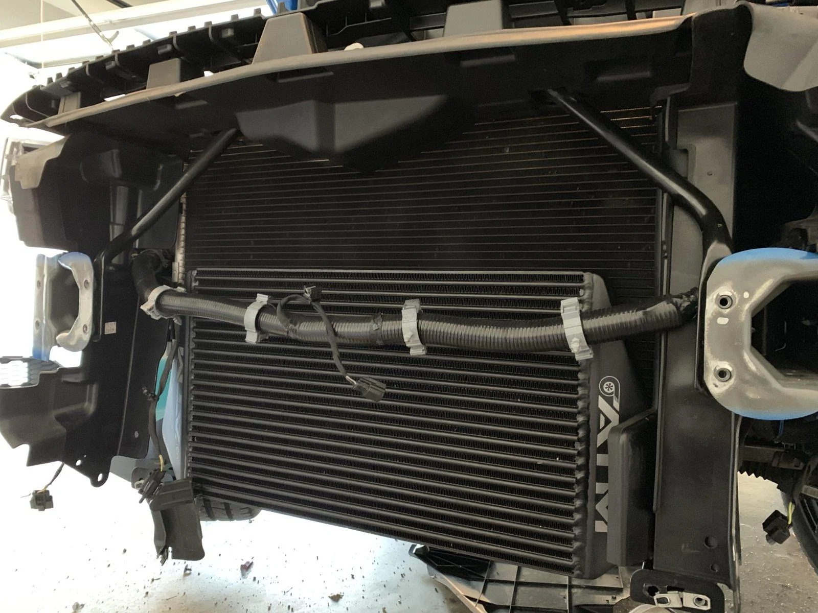

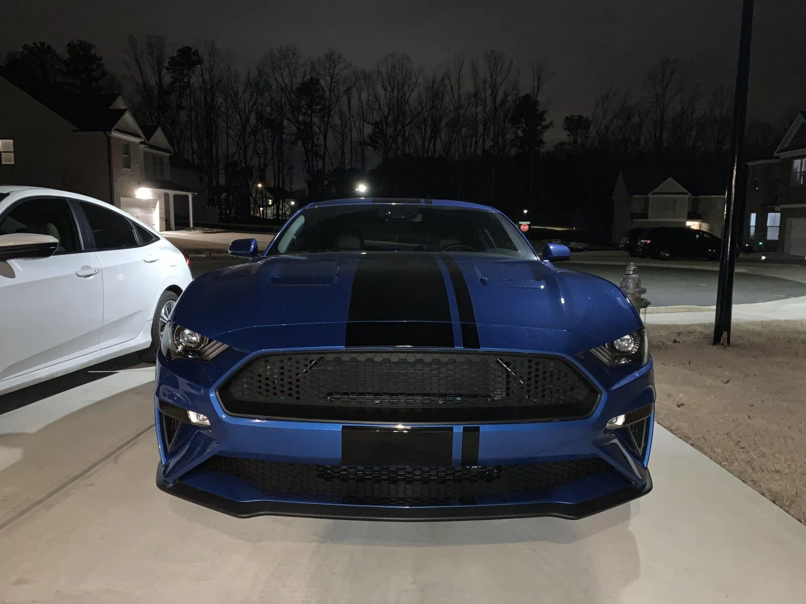

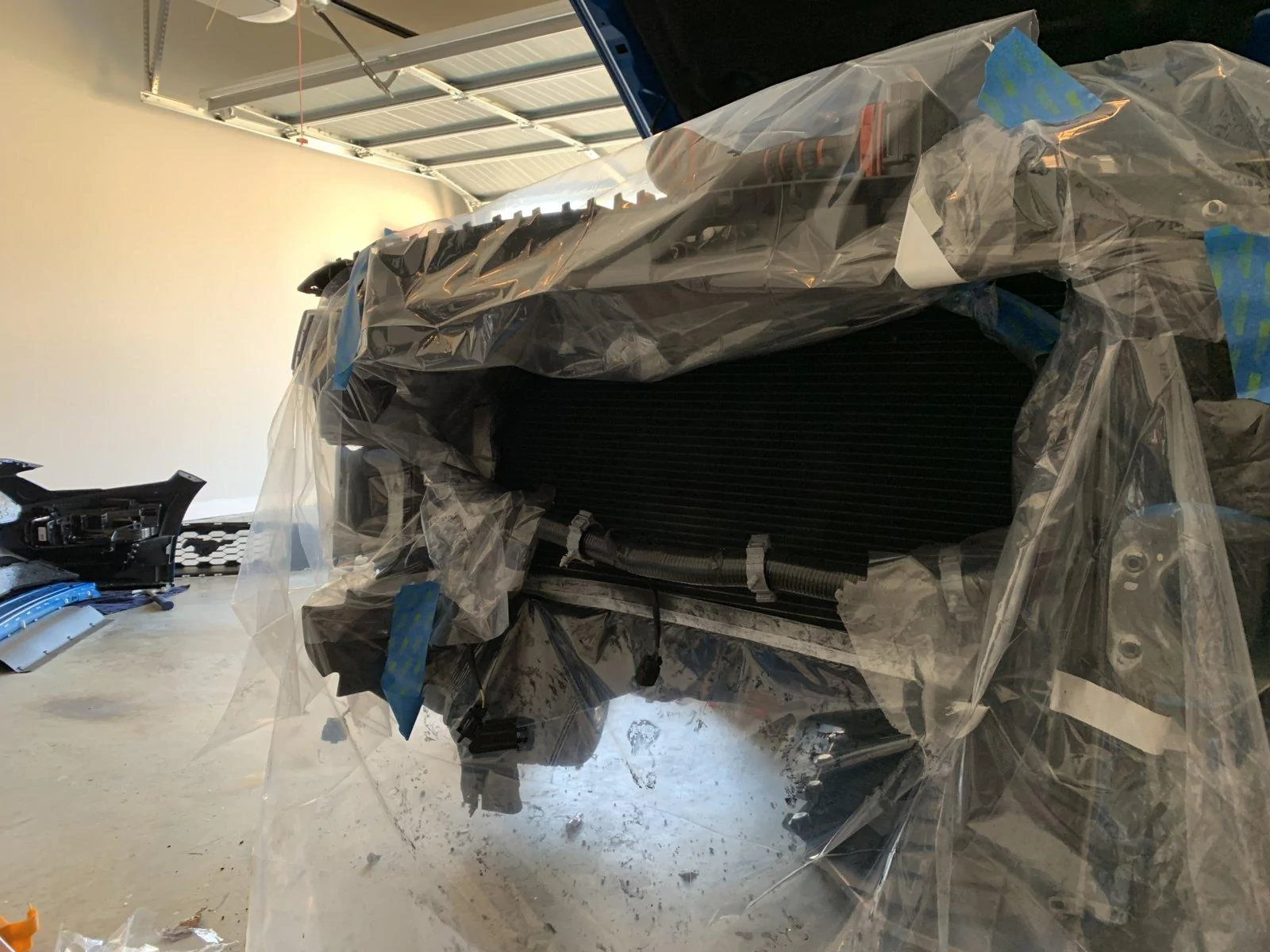

Every replacement FMIC has the same chance of voiding your warranty, they're all 100% non-factory. But the chances of any FMIC causing a warranty claim to be denied is low. I also went ATM partly because I wanted a black FMIC, but also because everything I've seen put it among the very best of the full size ones. I also painted the radiator black and installed new grilles when I installed to keep more of a blacked out look on the front end.
More photos of your car please
TicTocTach
Mar 15, 2018
983
1,010
DFWTX
Clair
2018 EBPP
Agreed - that Velocity Blue EBPP is a beauty! Makes me think about putting my black PP wheels back on sooner than later...
