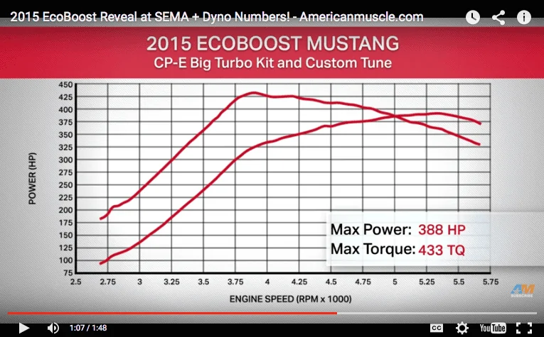

Im sorry not trying to thread crap here but I honestly thought this kit would be more impressive. maybe more tuning it will get better but for a nice twin scroll turbo with a high quality borg warner, I figured this turbo would have exceeded by a ton over the MAP journal kit. I still have faith in it but damn I would not have released that dyno.

I spent 35 minutes on it, I spent days on MAP's car.

You must not have read the thread, that was on basically a 20 minute tune as the car was being put on the hauler.......

no worries Torsen
as Adam said and I mentioned before
cut and paste from above
no boost leak check was done
needs a fresh set of 6510's
the downpipe necks down to 2.25" (OEM connection) so we could install the Flowmaster exhaust.
the tune is a pump gas tune even though we added a little RGC for safety
I'd say the car is partially tuned - time wasn't on our side when it was on the dyno
The car transport was literally sitting outside AM waiting for the car to ship to SEMA

Again Im not thread crapping here and I know it wasnt fully tuned. Just suggesting that yall should have never allowed AM to post a dyno graph like that.

People have been waiting for the results vid ever since the install at CP-E. So if AM didn't post anything, rumors would start leaking, etc. If anything I commend Woosh and AM for posting real numbers, even if they weren't as high as some people may have expected (initially).
I'm curious to see what happens when the exhaust is opened up, and the tuner gets more time to make things happen. :headbang:

just to clarify a few more things
this car belongs to an AM employee - it's not a shop car
the turbo is an EFR 8374 w/T4 twin scroll exhaust housing capable of 750 HP
He isn't asking for a tune to break any records and doesn't plan to put down more than 400-430whp on the stock motor
Adam will fine tune it in the coming weeks at which point updates will be available for all to see
soon after, he will install a built block with some head work for the big numbers
thanks for everyone's interest!
