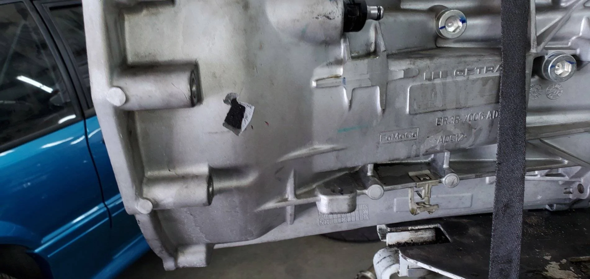

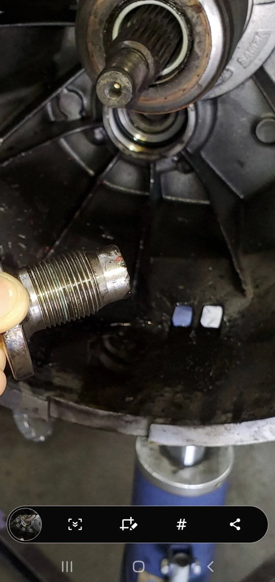

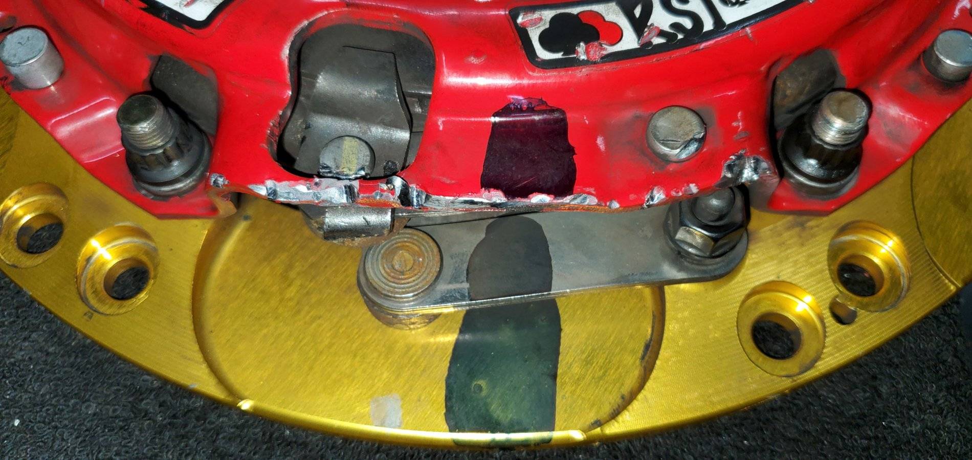

Counter shaft bolt was the route to my problem smh. Some how the counter shaft bolt backed out on it's own and caused alot of damage. Don't now how or why. I've never even heard of this bolt before.
