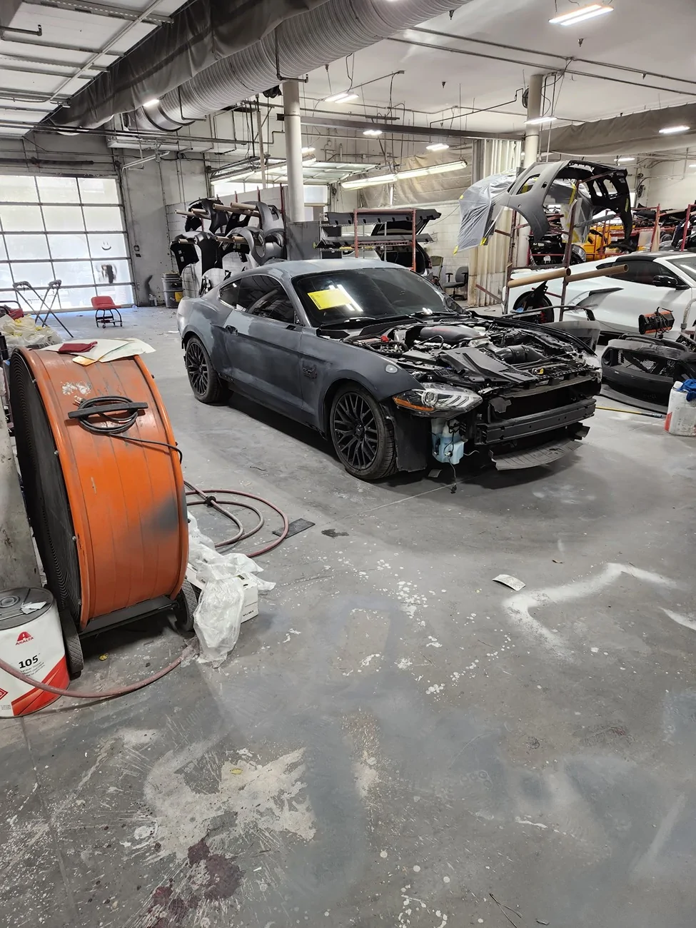

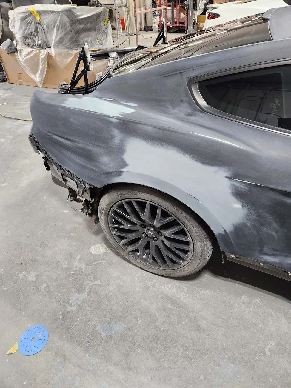

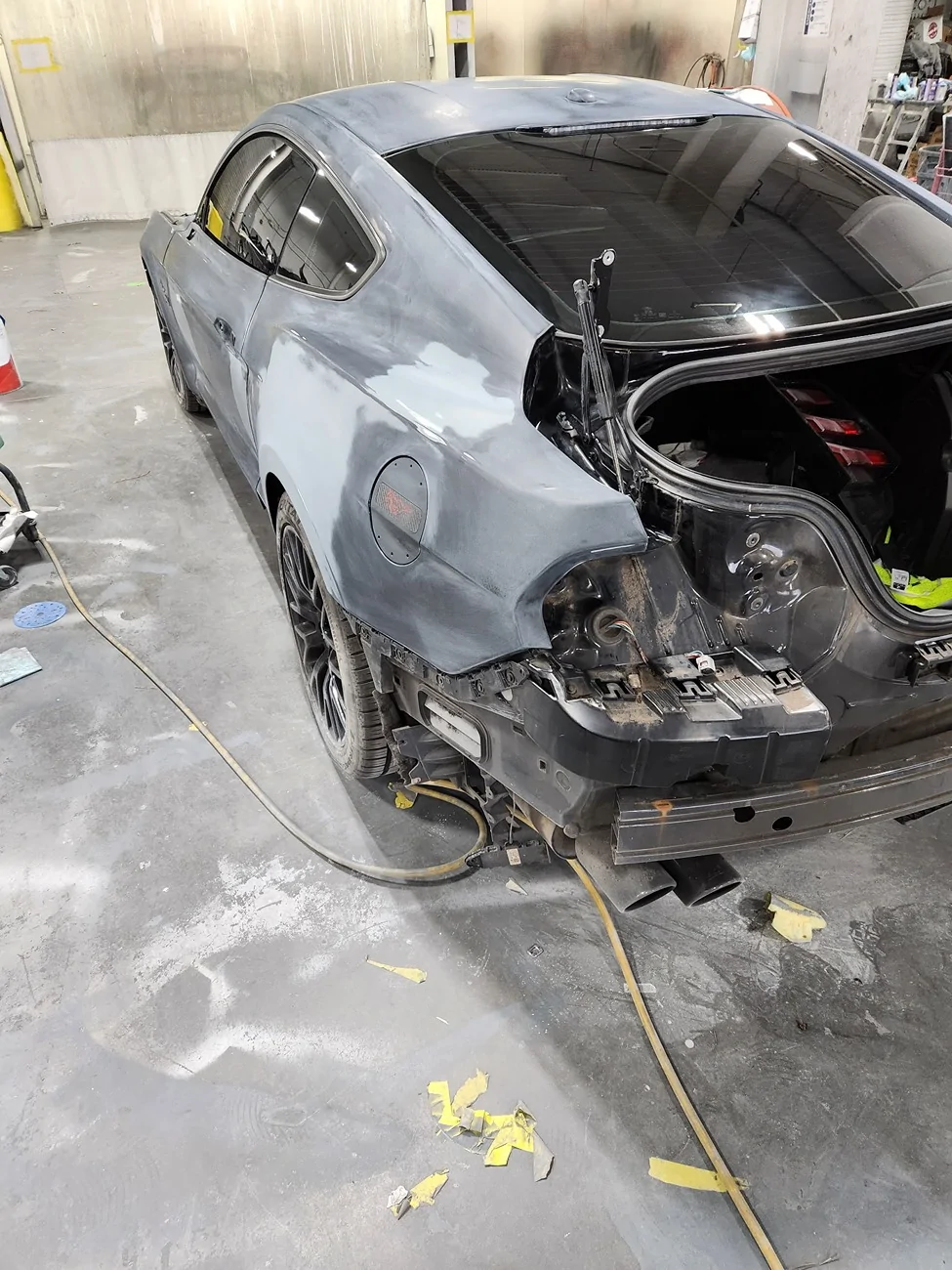

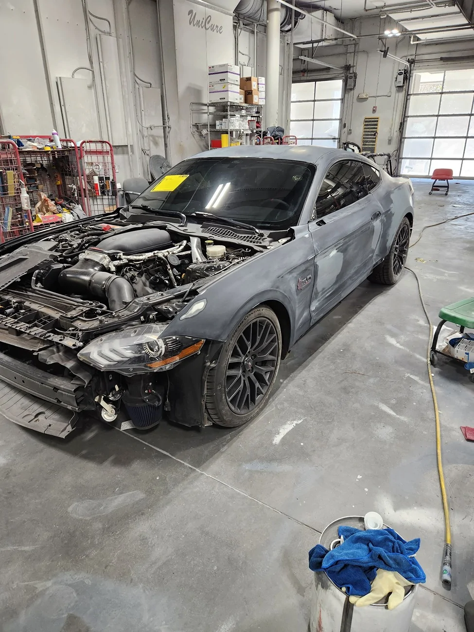

I've had mine repainted. I kept mine black, but went with another shade of black. (I know that sounds stupid, since black doesn't seem to have shades!)
As stated changing the color should be approached with caution. That adds enough to the cost, that it will make you reconsider. I bought my own paint and paid the painter $11,000. That was with the lifelong friend discount! I know someone will feel like that's not much of a friend. Considering the time, work effort, and manpower spent on my car it was a steal. Whatever you see wrong with your car, the painter will see triple that. My car was Shadow Black. I went with House of Kolors Jet Black. Ford Shadow Black has more hues in it than just black. HOK Jet Black is just that, Black! It's not easy nor cheap to paint a car. My price without the friend discount would've been $15,500 for paint. With an additional $4,500 to wet sand & buff, plus ceramic coating. My painter threw in painted stripes because we're like brothers. I didn't even know he was adding those. So that would've been another 4 or 5 grand. The time and work they put into those cars is more than we can imagine. Especially to make them flawless. Also if a painter sees a black car coming, they toss the Vaseline in the trash!!
Edit: My car was in the paint shop 4.5 months. It could've been done sooner but I asked him to take his time.

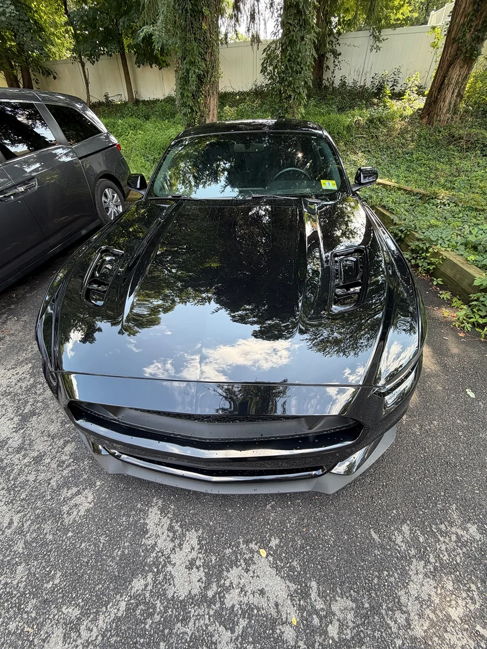

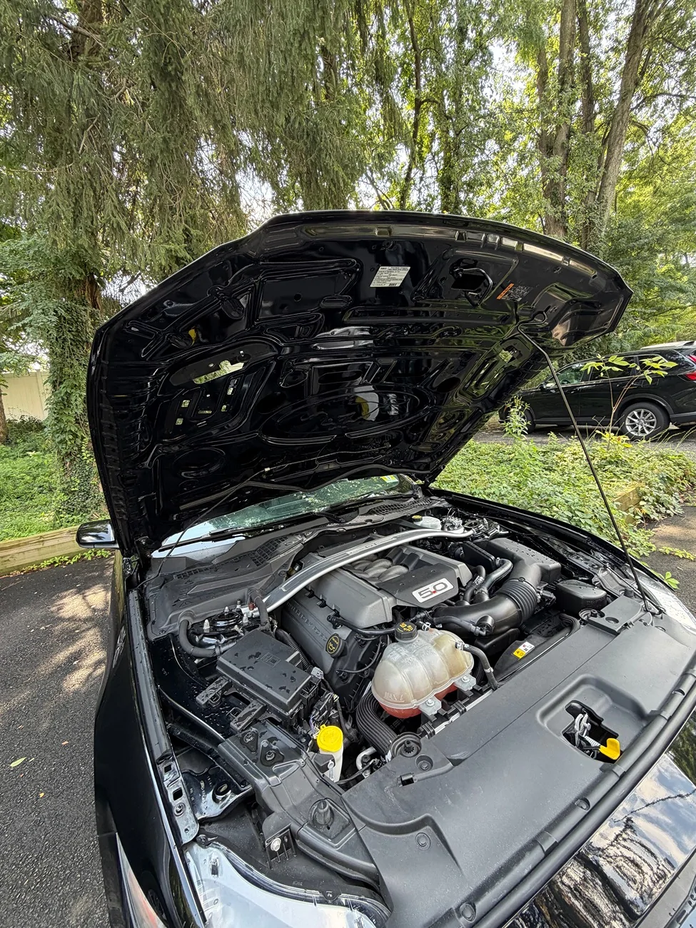

My hood was full of paint chips when I got the car, I'm having it stripped and repainted now. (Just the hood)
The body shop an also recognize the oxidation around the edges and said they knew what to do. They stripped it, treated it, sealed it, and painted it. Whatever that means, but it looks great.
