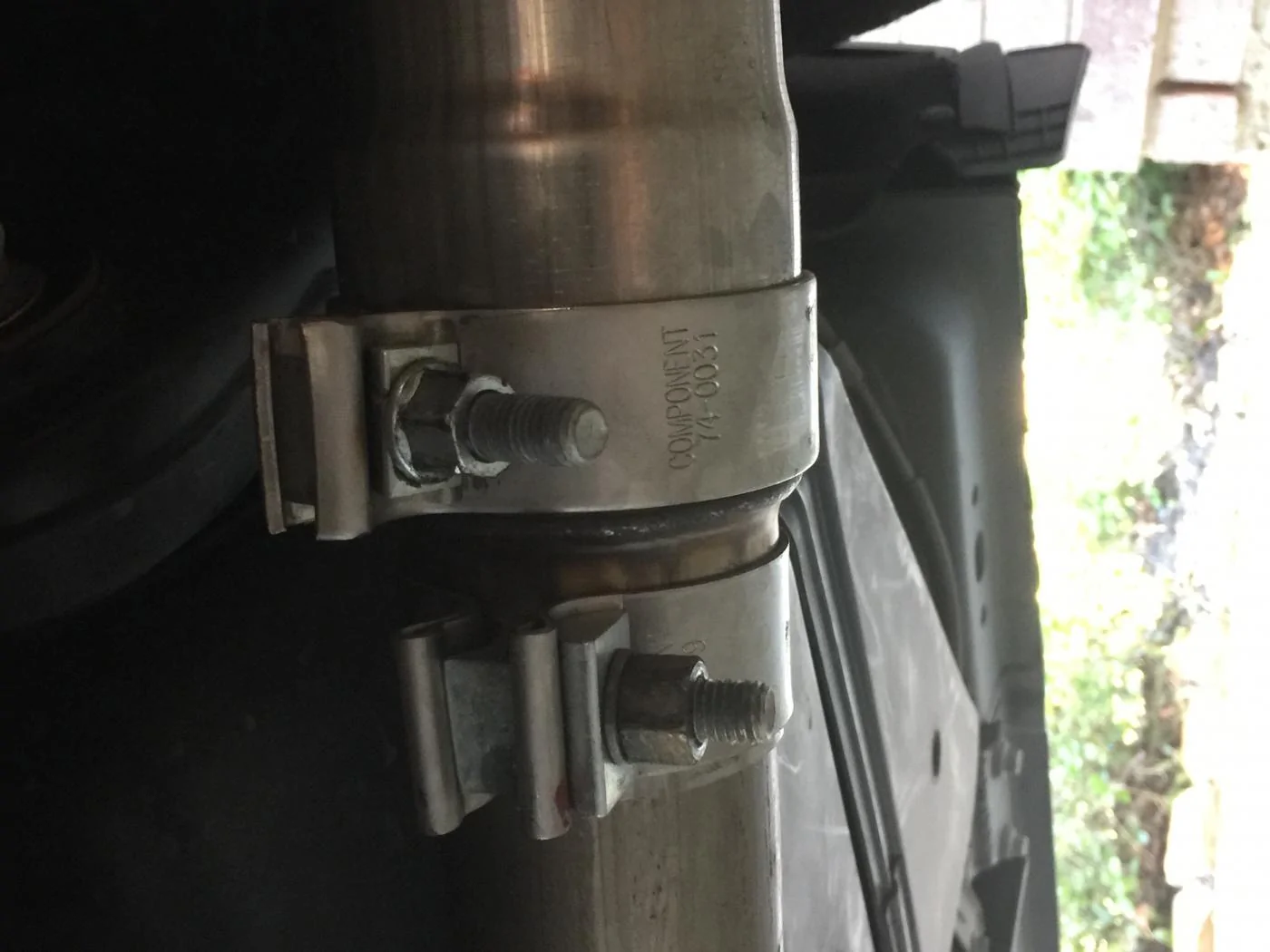

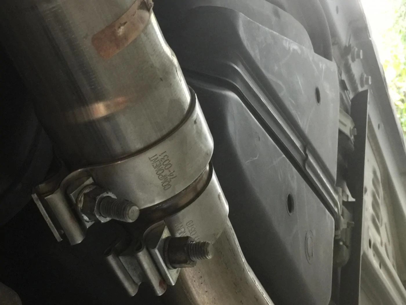

spoke to my guy at corsa.
he would love to get some pics from guys having issues.
there are a lot of variables from the angles, the torque, re-torque after 100-500 miles, where the clamps are lined up at etc..
[email protected]
if either of you guys would shoot some pics of over,

I'll get install pics tonight. Pics of clamps on pipes should go far, lol.
But Corsa actually finally emailed me back and asked for install pics, so install pics they shall get...

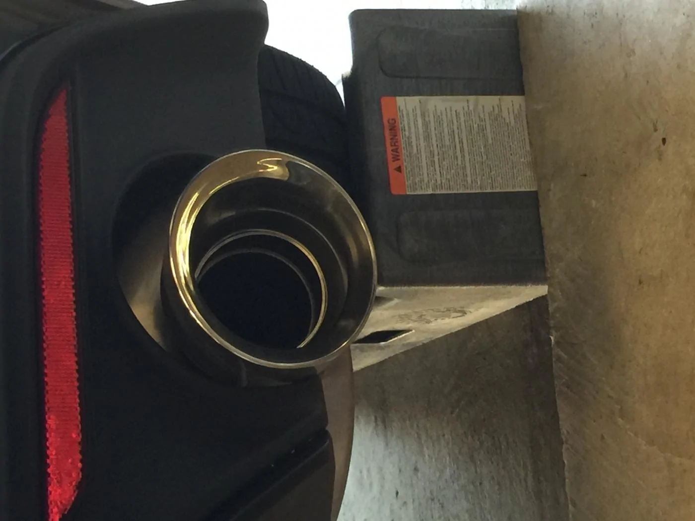

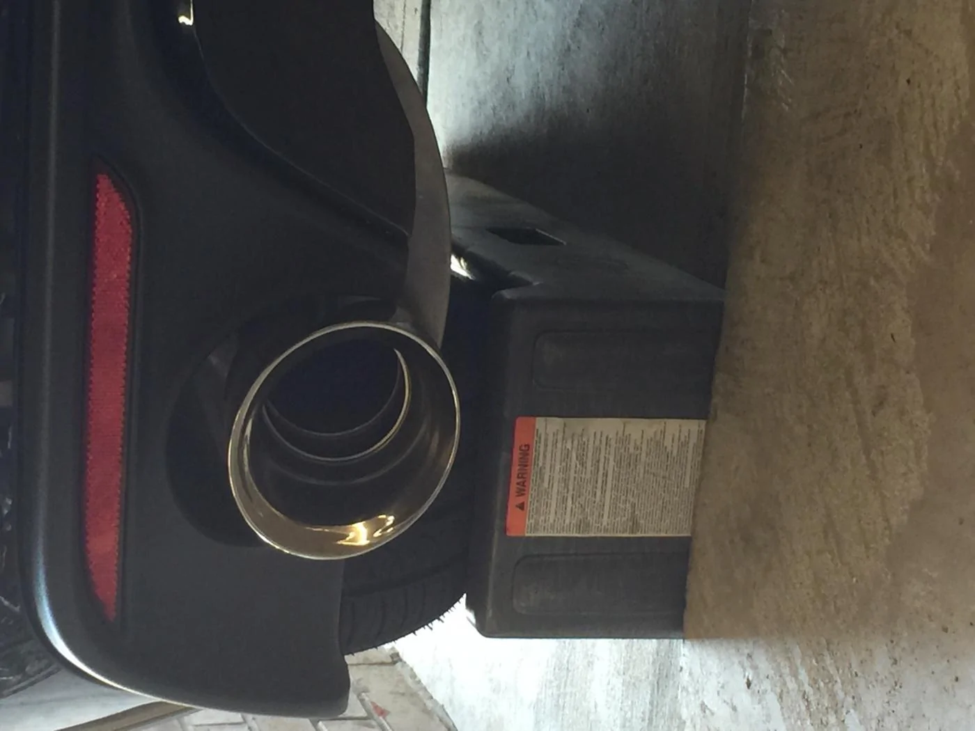

Mine for sure sag because the hangers allow the mufflers to sit way too low. To fix this you have to hold the muffler up with a jack (or your knee) and then tighten the clamp (and then hope it doesn't rotate and sag again).

I'm guessing that's part of my problem also. But I shouldn't have to heat and bend on a $1,000 axle back. Cuz once I do, you know they won't warrantee it lol
I'm about to back it up on the ramps and get install pics for Corsa...

Install pics, if I posted them correctly
