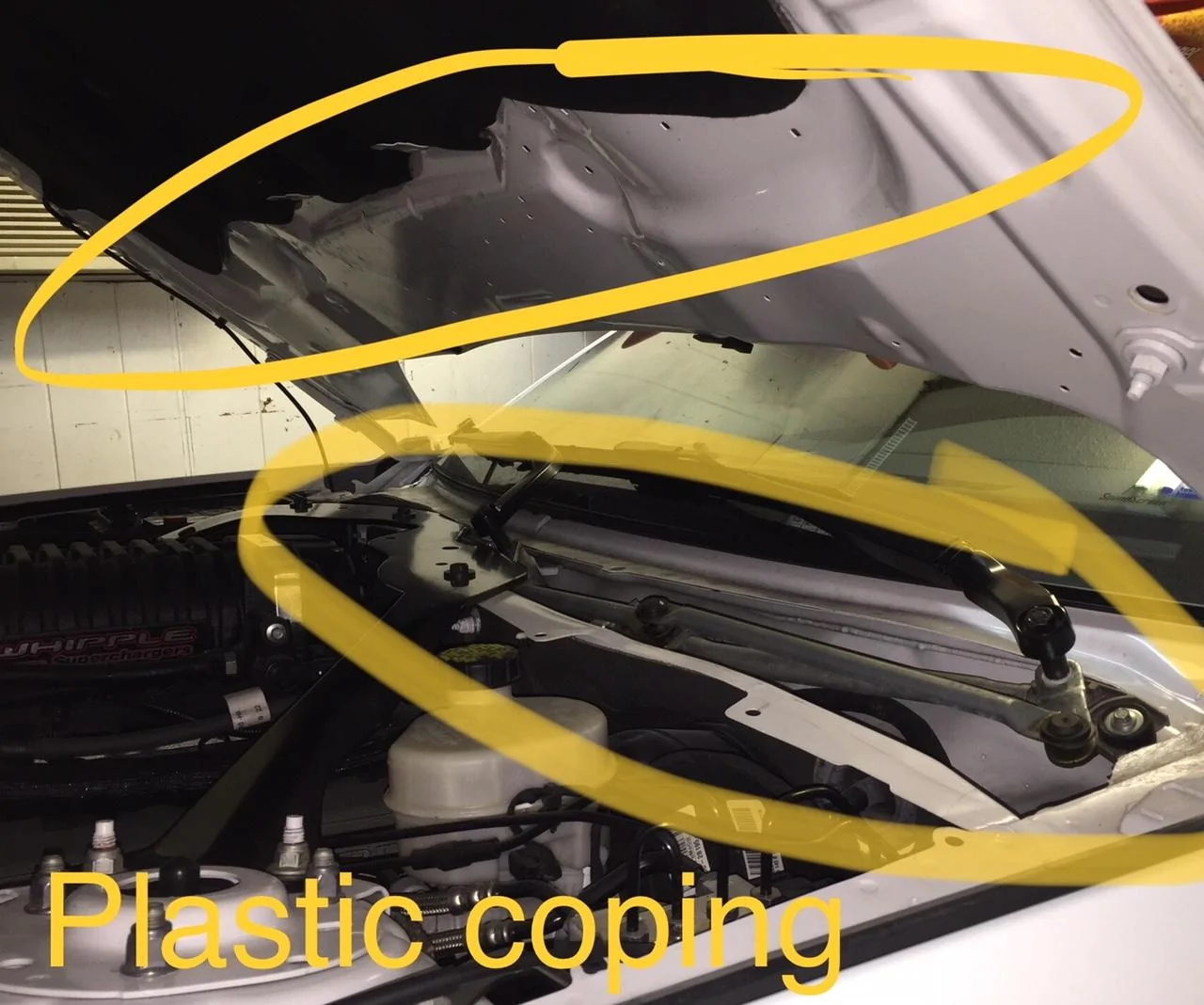

Sorry to dig up an old thread but what is this coping everyone talking about?
I believe it is the weather stripping/seal at the back of the hood/engine bay.
By removing that seal it allows airflow to come out of the back of the hood and take more heat out of the engine compartment.

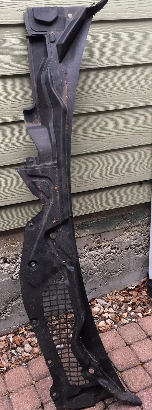

Firewall plastic piece is coping. If you look at battery cover and coping stock, you notice it has a raised section to mate with rubber weather strip on underside of hood.
Removing all three opens a large gap that allows substantial ventilation especially sitting stopped in traffic.

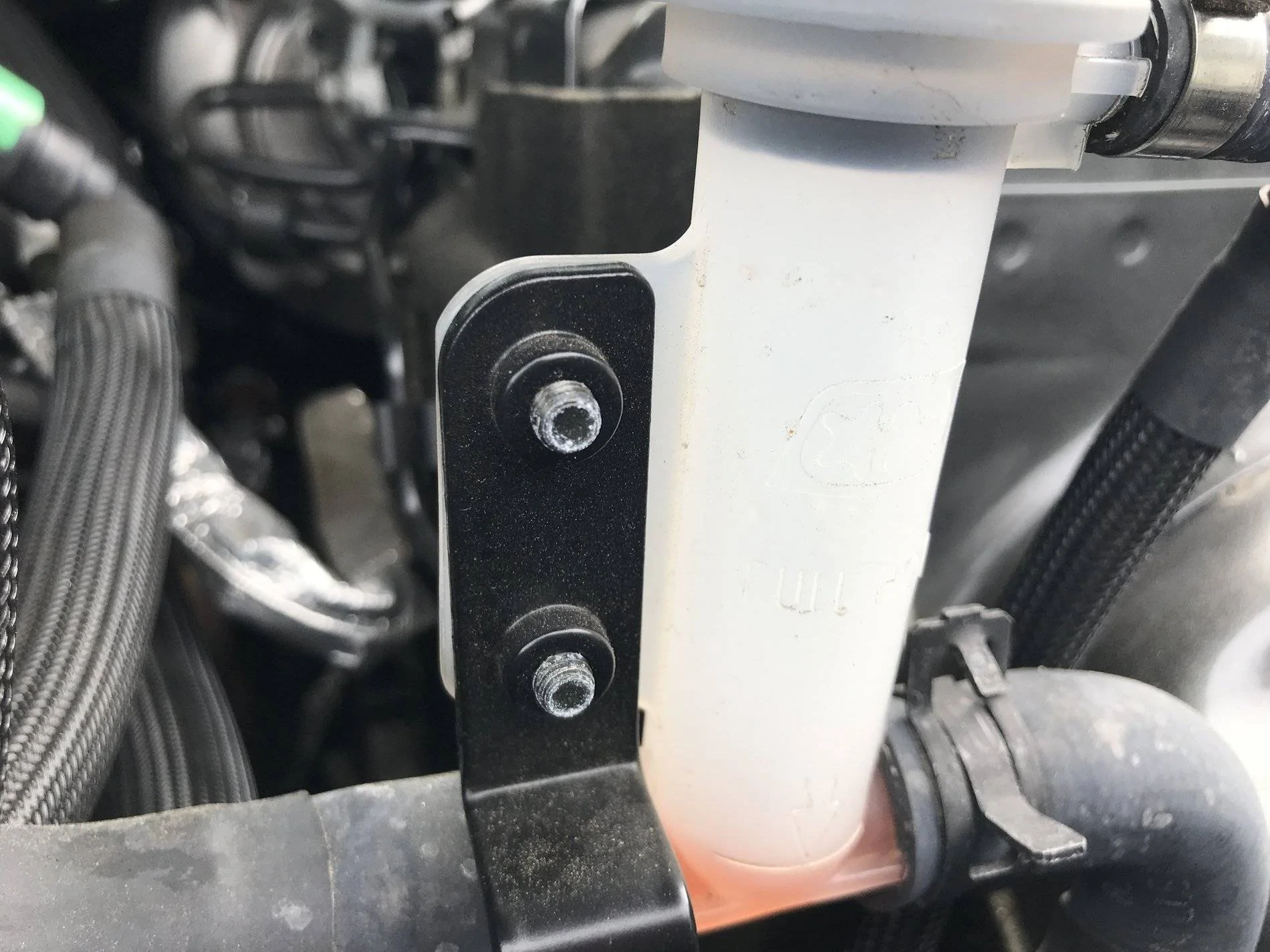

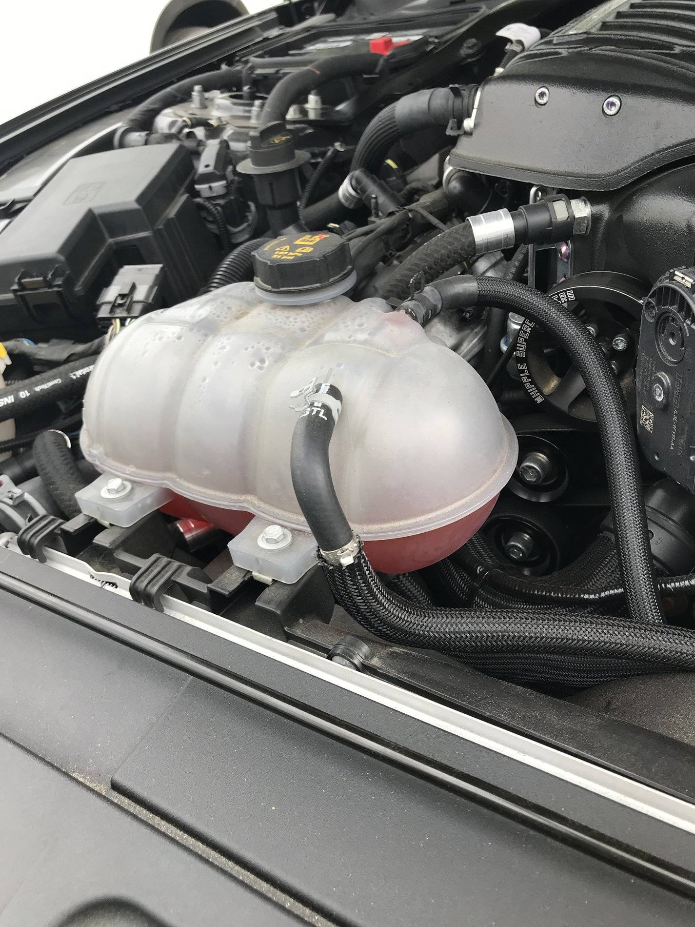

Can we get some pictures, I’m a visual learner. Here is my level currently; totally new to this car so learning a lot day by day.
Can I just go get some Ford coolant and call it a day, or so I need to mix distilled water and coolant ???

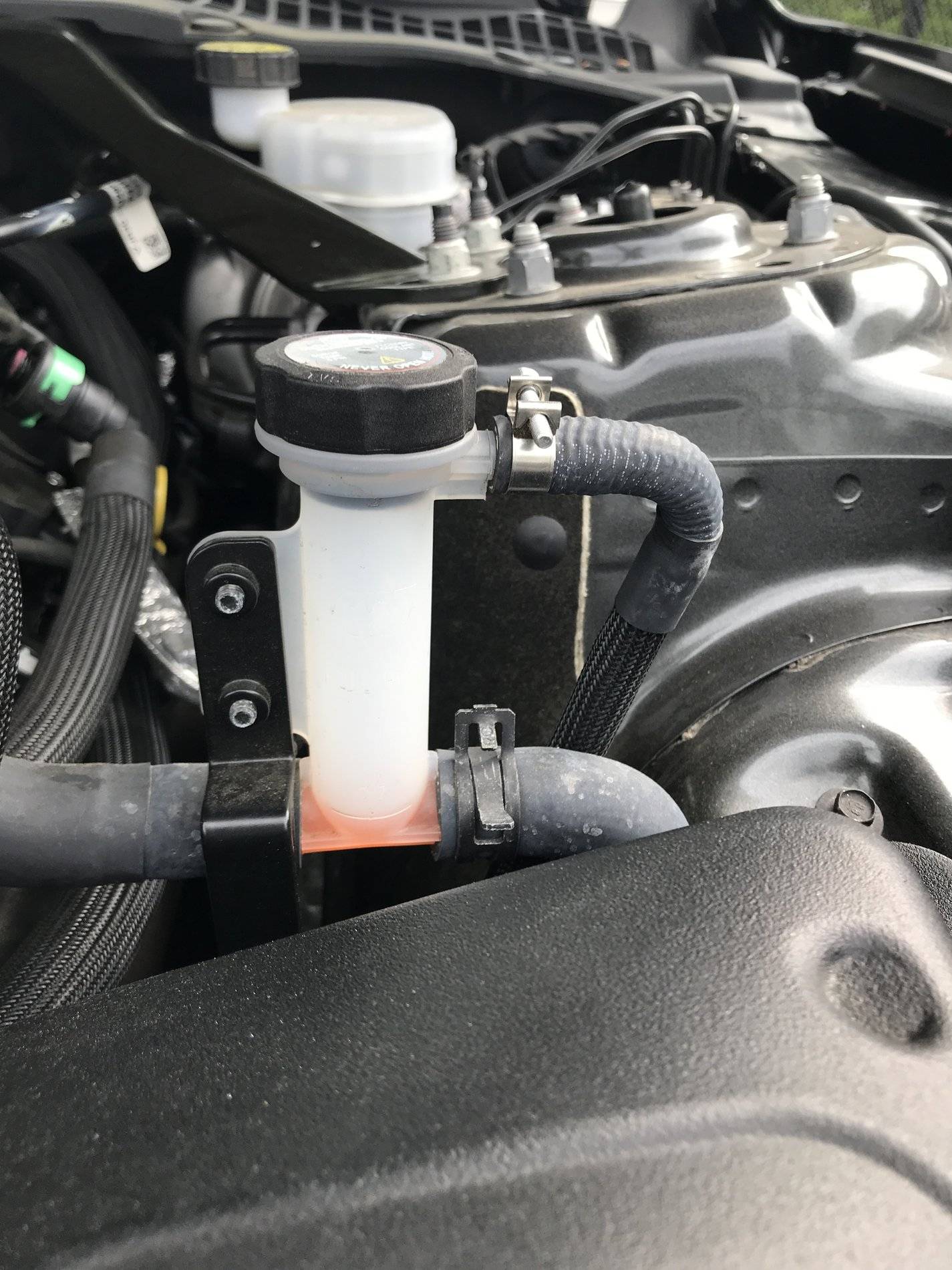

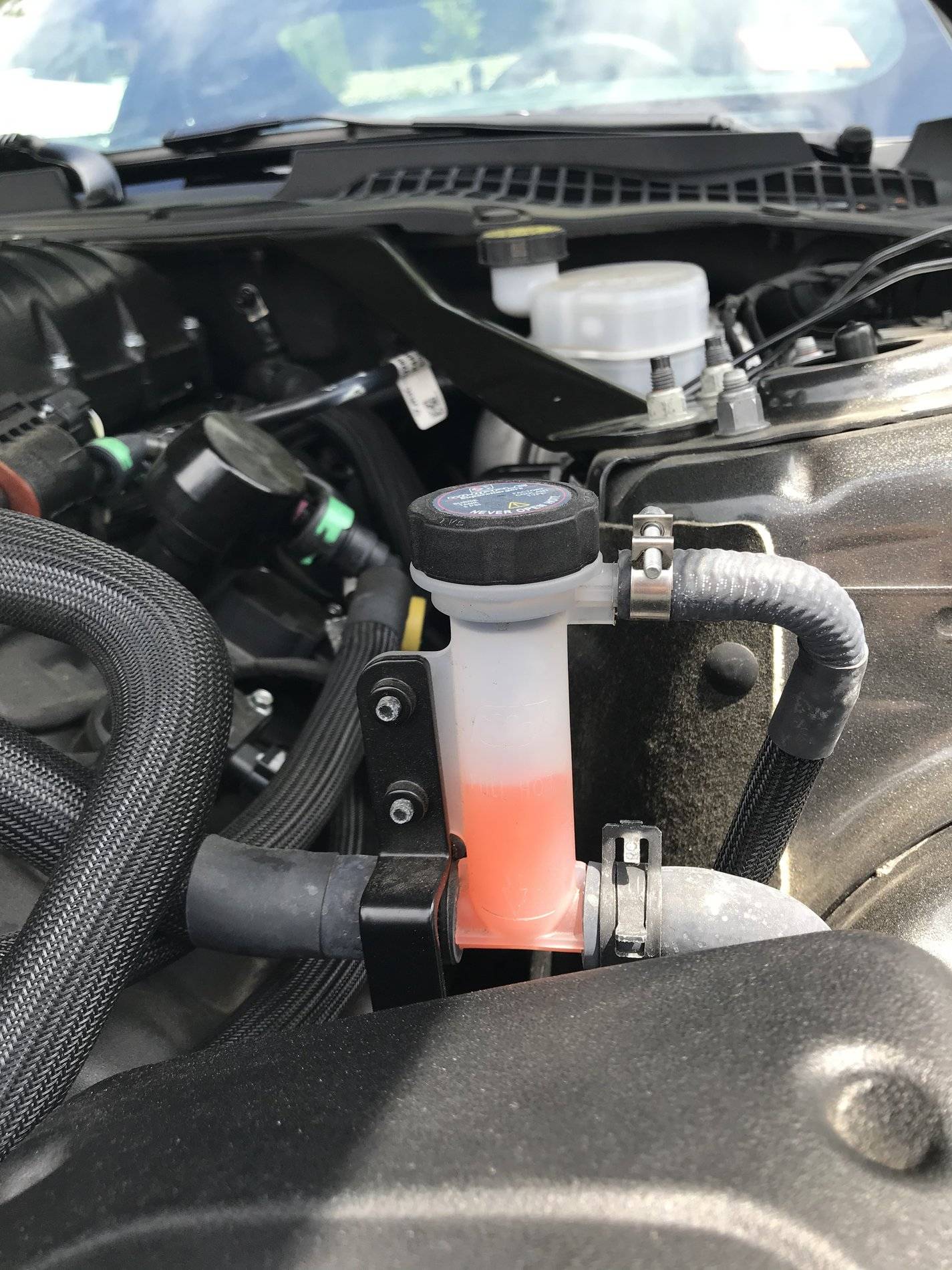

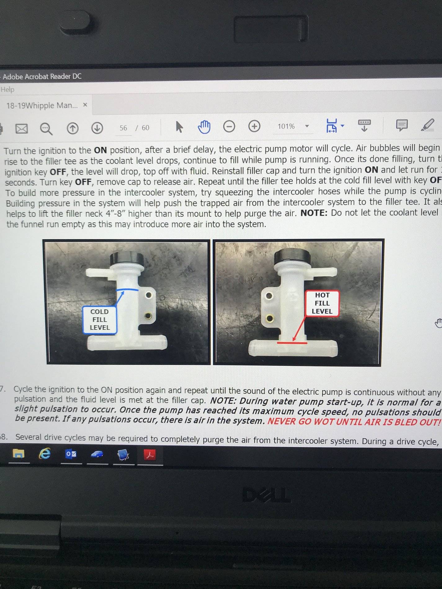

Honestly, I want easy as possible with common sense for motor & power preservation. I drive around town, I rip here and there. This won’t be a trailer queen and this won’t likely be taken to the track (straight or road course).
I’d prefer to dump some proper, pre-mixed coolant in the radiator and Whipple inter cooler box and call it a day.
What’s odd is; the Whipple instructions call for a higher level when the car is cold. Mike is lower. When I turned the pump on, The level rose and I could see the fluid bubbling / shaking around a bit. But it’s basically opposite of what Whipple has laid out in their diagram. Here are the attached photos from CAR OFF to CAR ON.
