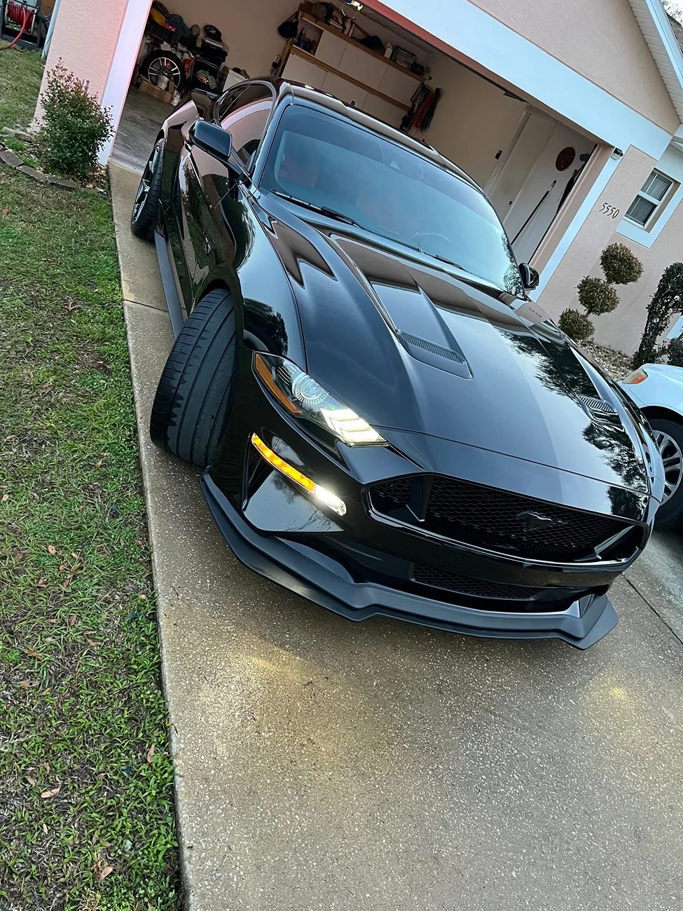

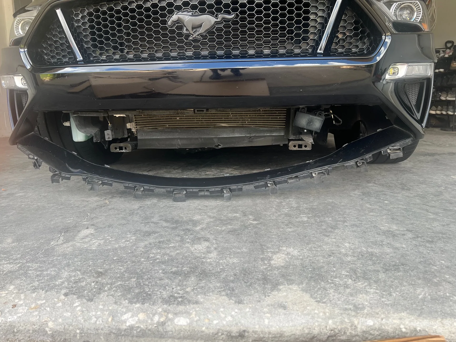

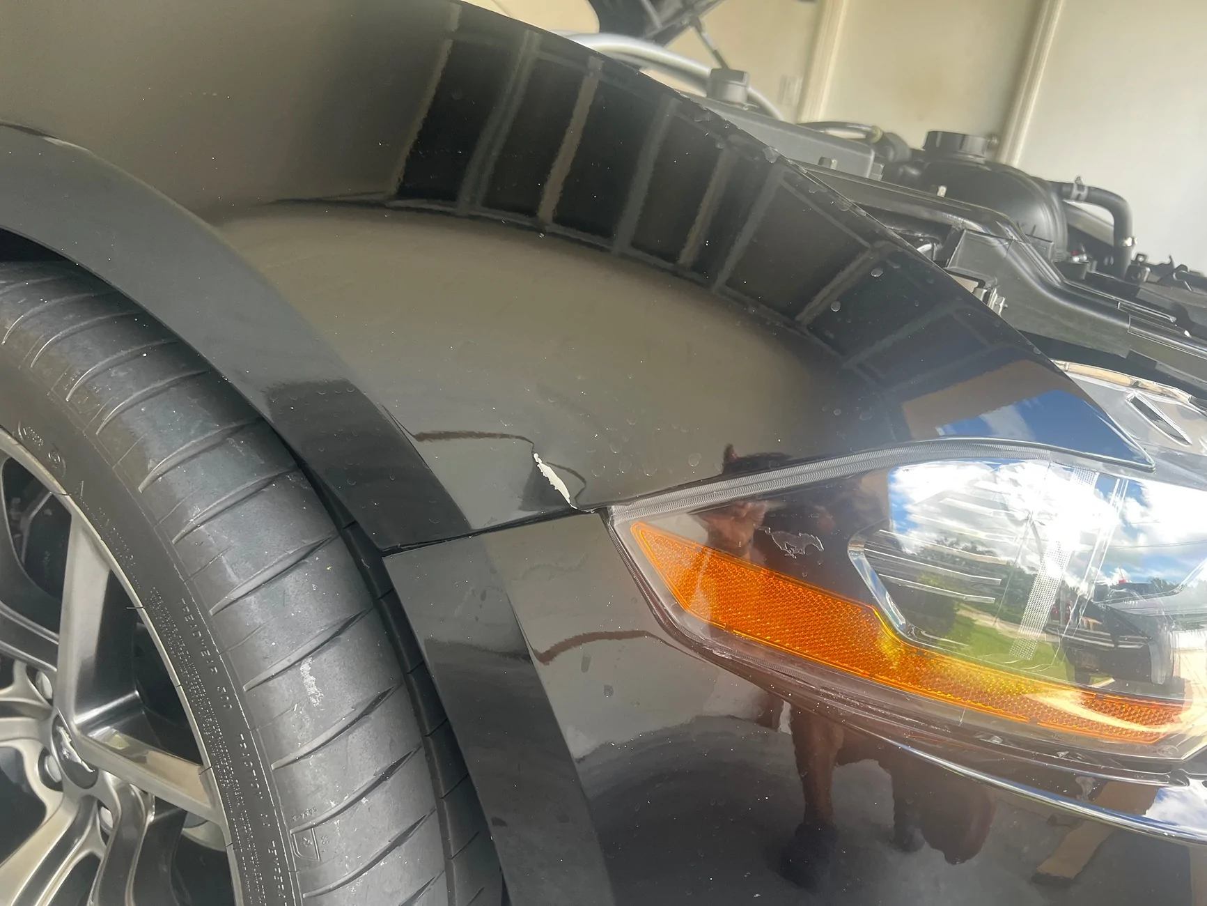

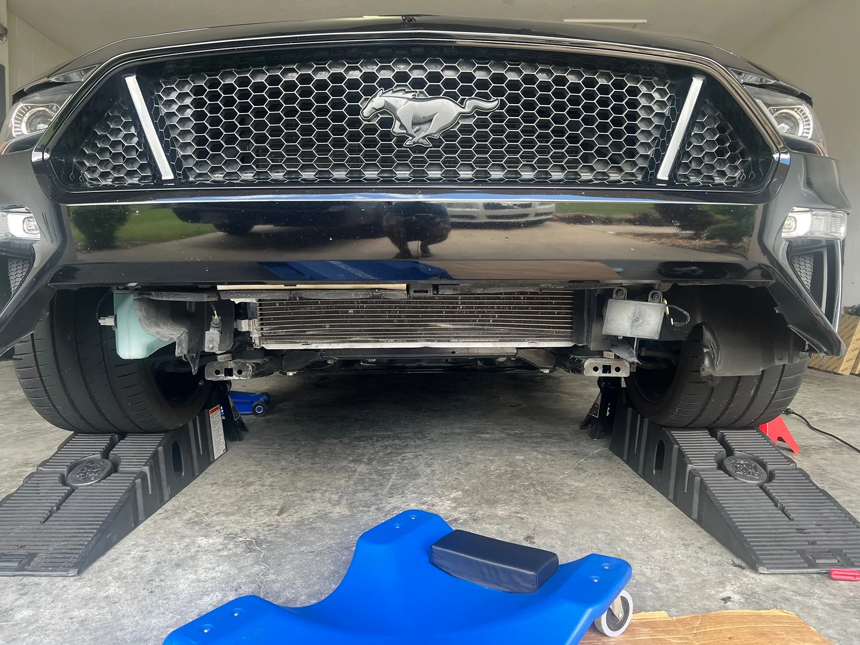

I have a question?
I recently hit a half piece of an 18 wheeler tire on I-75. It ended up damaged the whole front of the car and costing nearly $10,000 to get it fixed. The question is that where the car is being repaired isn’t able to recalibrate the collision warning box in several attempts. Since I have a Lund tune in there, I was wondering if that can cause the issue of not being able to do the calibration?
I attached before and after impact.
thank you in advance for your response.

that one photo of the damaged lip looks like a sad and shocked s550. ive seen too many children's shows
