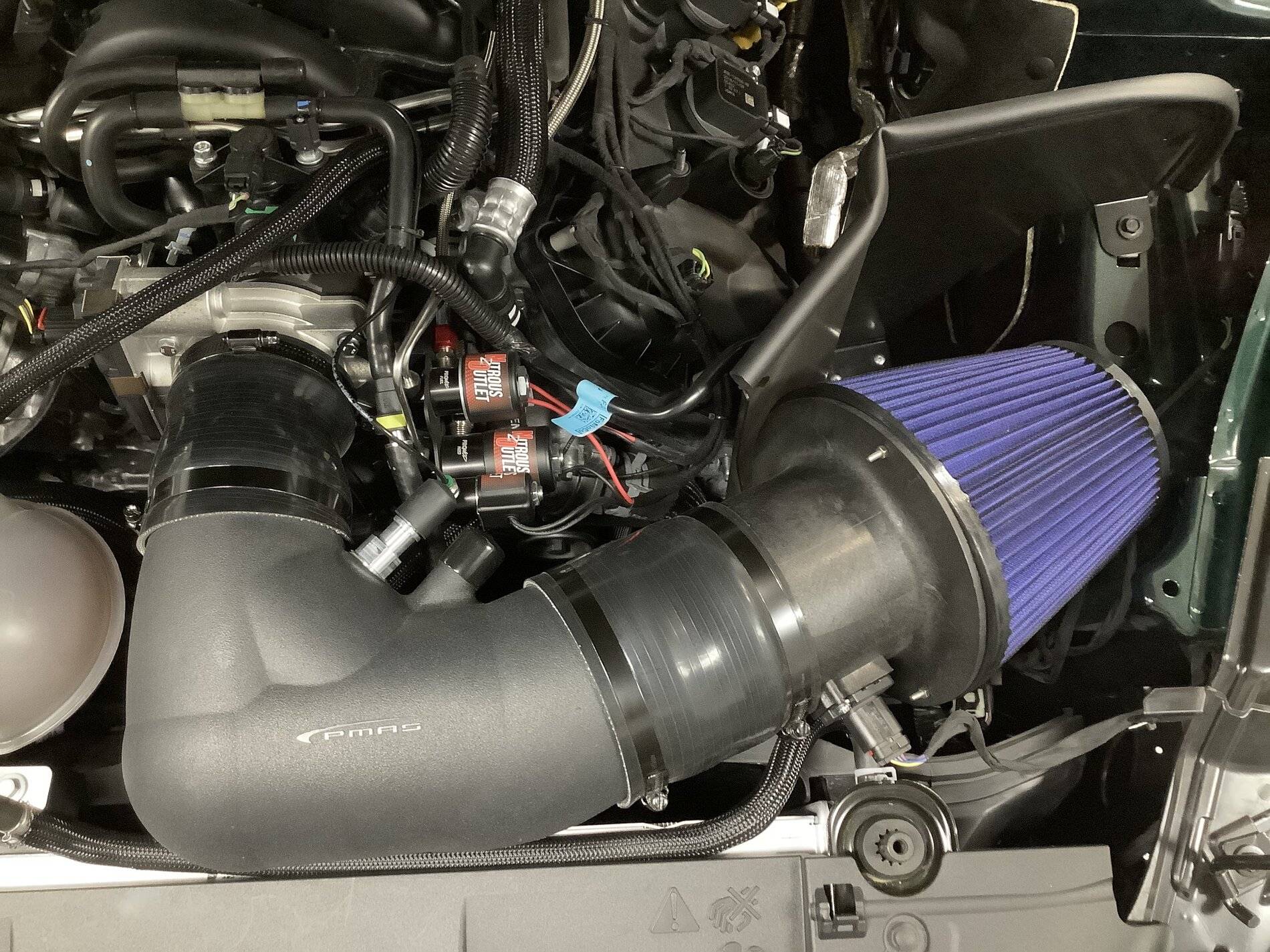

I think a sealed air box is best, as it shields against the hot engine bay heat. My PMAS serves its purpose in that it allowed me to run my nitrous plate kit., although I would rather have had a closed box like the factory one with just a drop in K&N air filter.

Anytime you can lower IATs that’s a good thing and good for performance. I would say that there is a performance gain to be had with any kind of lid on it because it keeps the heat out. PMAS looks better than the JLT. I can’t really say that it makes any more power over the factory box because it still allows hot engine air to be sucked in like the factory box. I only bought it because I needed it to facilitate my nitrous install.
I would suggest trying the plexiglass (it’s cheap enough to buy a piece of plexiglass), on your factory GT350 box and then monitor IATs with and without it in place to see the gains, or confirm it with some Dyno pulls.
