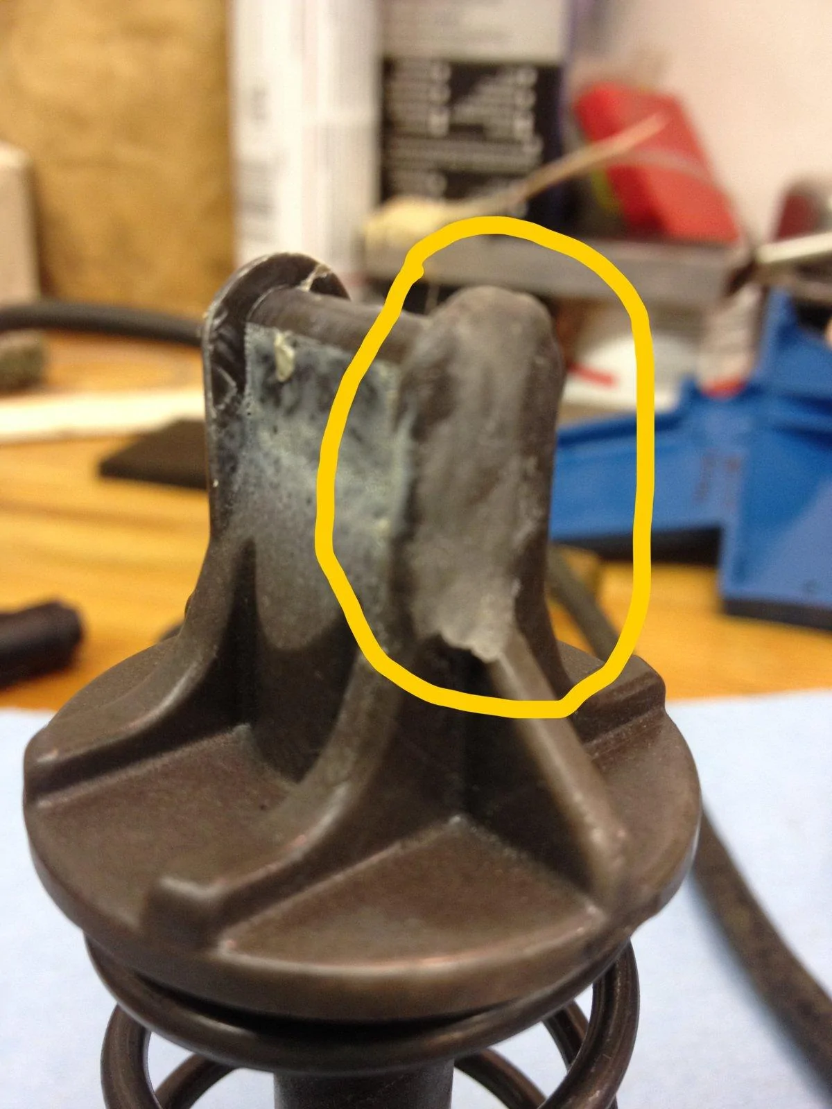

View attachment 306036 View attachment 306036 I broke the edge off my perch when removing the stock spring. I gathered the shards and used Loctite 404 to glue the pieces together. I then added more glue to the broken areas and dabbed the part in a small mound of baking soda, The soda turns very hard. After building it up I filed the soda down to just oversize for strength. View attachment 306032
Wow. That's true dedication. Maybe I'll try that. I've always been curious what it feels like with the Steeda spring. The whole bit is still in my glovebox if I recall correctly.

PJR202, It'll look funny seeing your reply before my post but I had tried to resize the picture and screwed up. I've had the repaired perch in the car since June and just pulled it out now to take pics and see how it's held up. So far so good.
It looks pretty sturdy. If I ever find the time to do anything I might give it a go. We got a puppy in June and basically my whole life since then has been getting random stuff out of his mouth and watching to make sure he doesn't pee somewhere..lol
