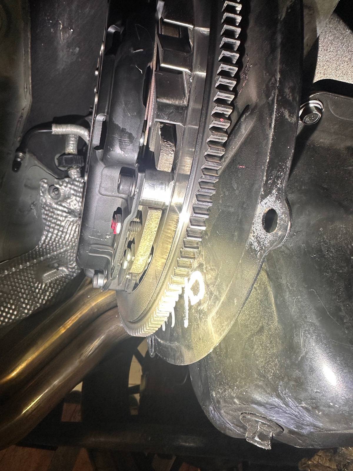

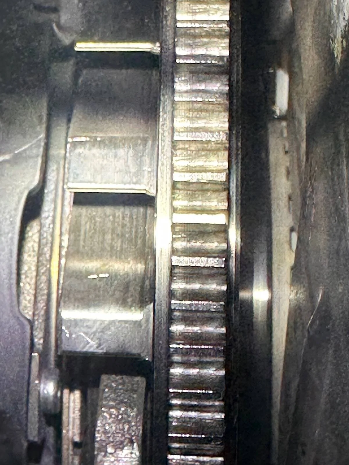

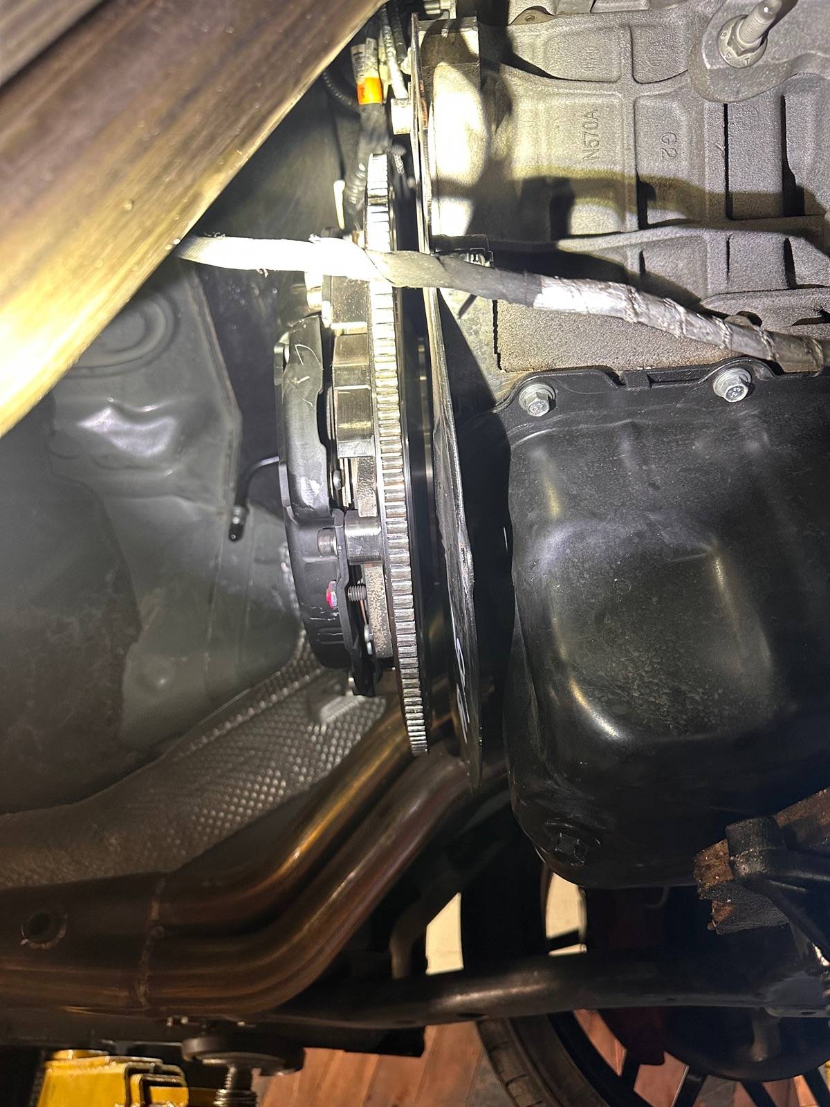

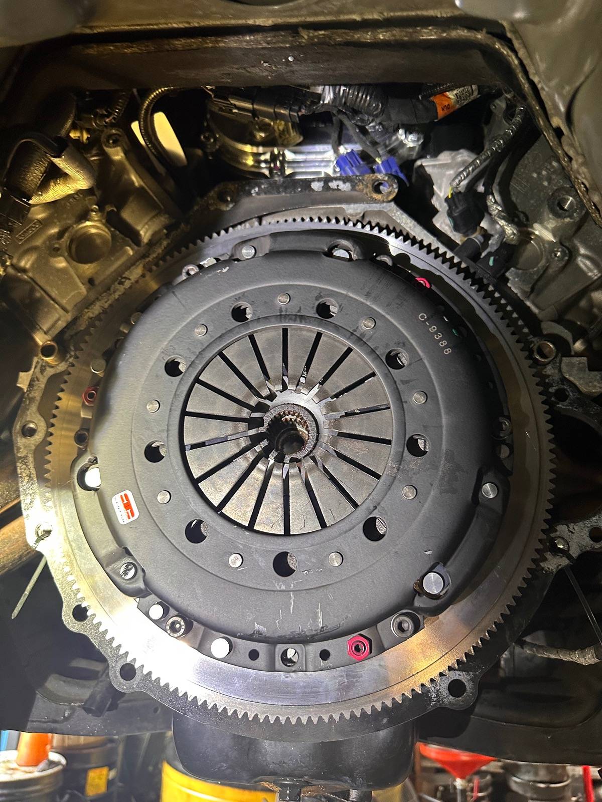

Hello, I’m not familiar with transmissions and clutches therefore I’m seeking help. I’m having issues with my clutch slipping possibly? My car makes noises as if the clutch is not fully disengaging (metal rubbing against metal). I took it to a shop but still not working properly. I snapped some pictures, the clutch seems far away from the block. Not sure if there’s anything wrong or if it can be seen on the pictures but I figure I would ask. Thanks

If the noise occurs only when your pressing on the clutch pedal, it may be a throw out bearing issue. Determining if the clutch is slipping is fairly straight forward. The engine revs rise but the rate of acceleration doesn't, almost as if your spinning the wheels in wet conditions, but your speedometer won't climb at the same rate as the engine RPM's.
