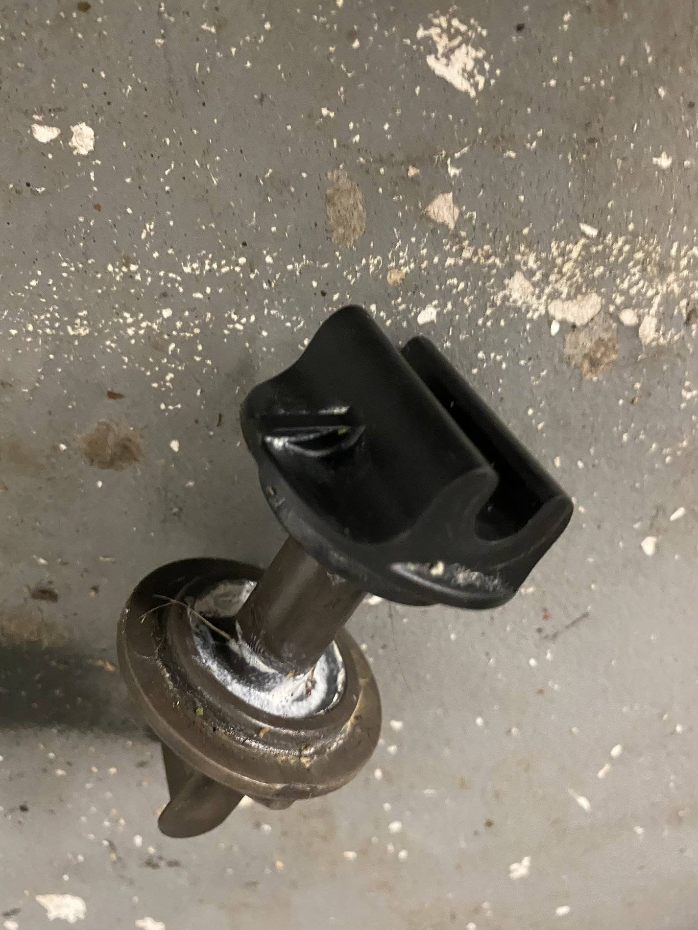

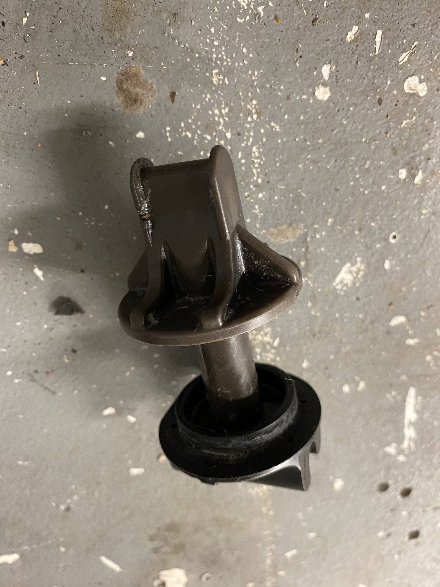

I have the stock clutch assist spring installed, and when I was on the track this weekend it fell out. When I press the clutch pedal down, it's very loose and under no tension, is it possible then spring is just shorter and worn out? Can anybody measure the height of their stock clutch assist spring or any other ideas that might cause this?

If you look I think you'll find that one end of the spring perch broke because the stock spring is really stiff I don't think you would ever wear it out or get it to take a set and become permanently compressed.

I don’t think the perch is damaged. Pics attached.

Maybe it was never installed correctly. Unless you got under the car and confirmed it correctly installed, it most likely was that, since neither the spring, nor the perch is broken. Probably similar to the clutch line from the brake fluid reservoir was about to dislodge, and my car had only 200 miles. I ended up putting a zip-tie at an indentation at the end of it, and also another longer zip-tie to relieve the pressure and angle a little. It worked. So I'm now going to check that issue too. Ha ha.
