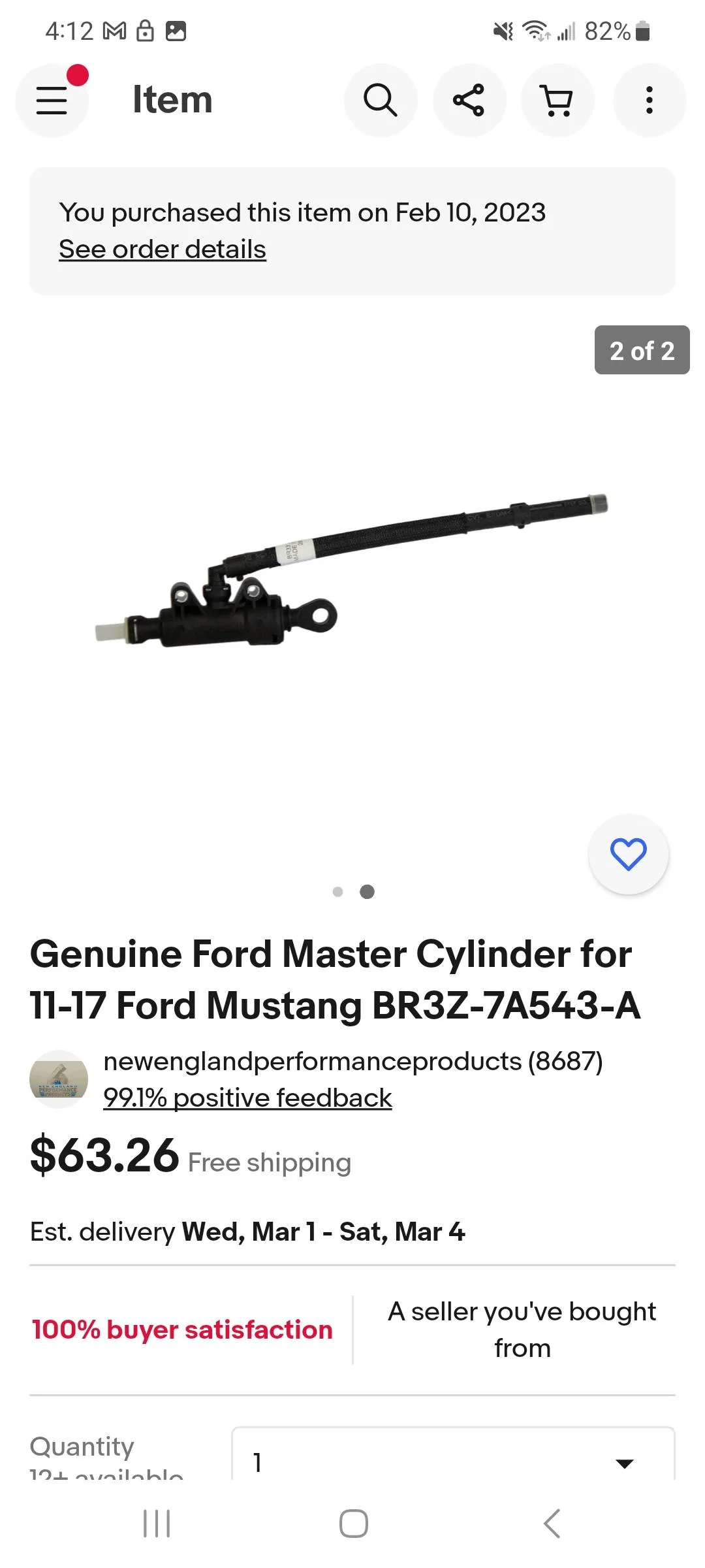

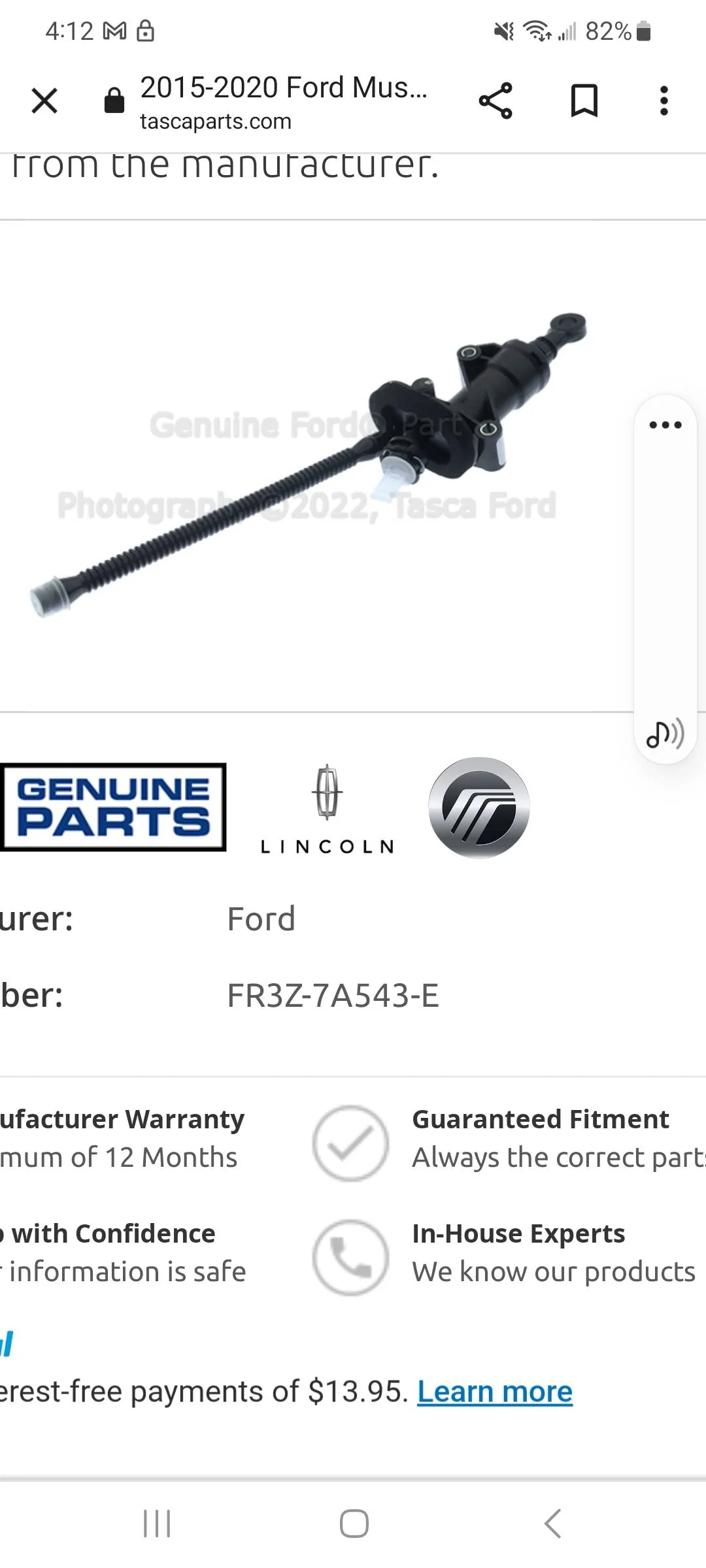

So my clutch master cylinder gave out on my 2015 GT after 125k or so miles and I've been looking for a replacement. Every search I run for 15-16 cars turns up (what I think) the 14 and older manual cars cylinder. I ordered one based of a part number I found online but Ford calls it out for the GT350, anyone know if a stock non pp GT is different? The second picture with the hose coming off the front matches what the one in my car looks like.

So if anyone else wants to know this swap worked just fine on my 2015 GT.
