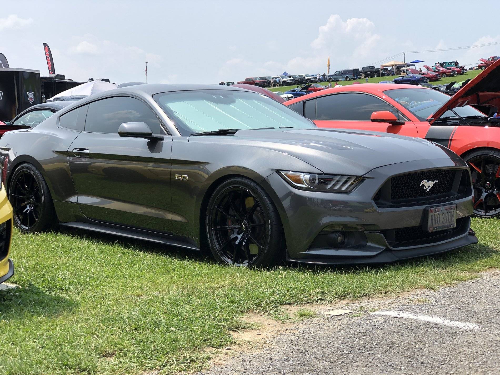

When parked in the sun I’d recommend the Covercraft ā€˜UV’ series heat shield. It makes quite a difference. Custom-fit and you just flip your visors down to hold in place.
I’m using my old shield from my WRX, fits good enough but the mustang-specific shield would fit even better.
