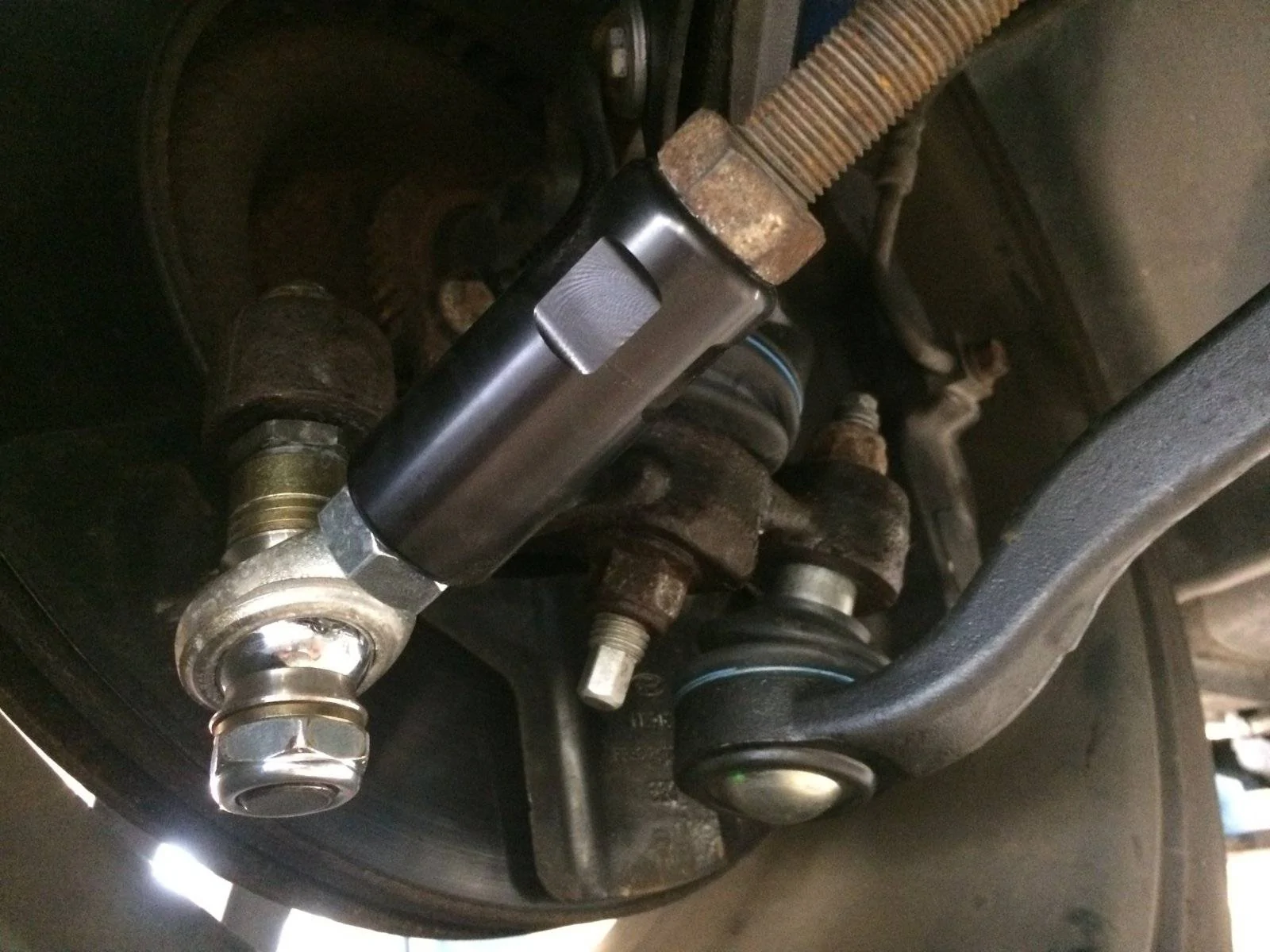

Double check that your bumpsteer kit is fully tightened, to include the large toe-adjustment nut. Also be sure that the bumpsteer ball joint has a silver coupling on both the top and bottom of the joint—no washers should be in contact
Here’s a photo of what I’m talking about. The toe adjustment nut is the grooved flat black bit. The silver couplings are in the top and bottom of the silver ball joint on the left.
